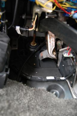

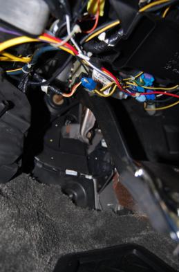

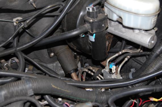

OK, can someone Please. please postdetailed pictures for the clutch pedal installed form the interior and the engine bay??? Pretty Please???
Here are few quick shots of my interior and engine bay, not sure i see how the pedale could fit... I know I am going to have to just try it anyways but, would help to see some install pictures...

I just priced out the clutch pedal (part #15027983) on gmpartsdirect.com and it is only $39.00 brand spankin' new!!!! I will order one ASAP for test fitting...

HAHA probably but, that is still sweet for brand new clutch/master assembley none the less... I will place the order Monday morning for it and then I can begin the test fitting for this project...
PS Still hoping someone here will post pics of their pedals installed...
