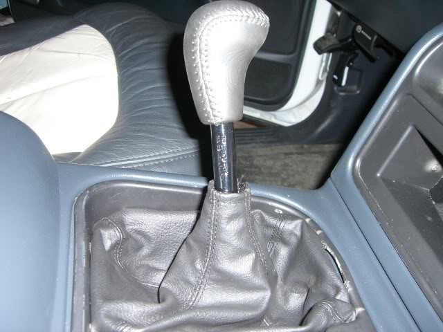

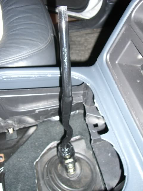

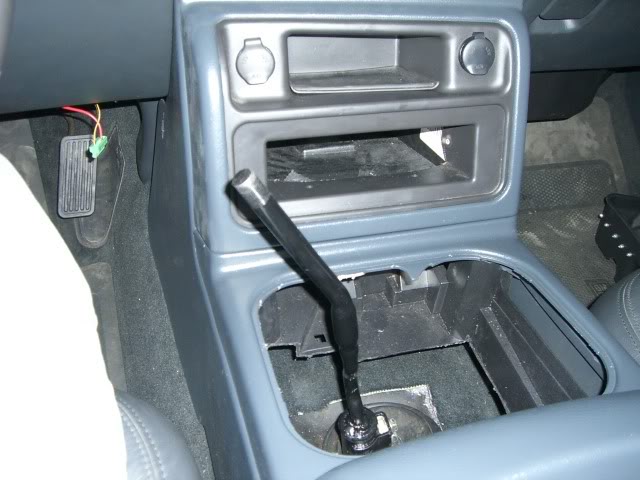

heres some pics of my shifter and console setup. i need to remake my leather booty/cupholder ordeal
my shifter is a hurst with the stock rod then a hurst rod on top of that. if you wondering yes i could of went shorter but i like a relax'd reach an feel and i like the shifter bent like that also

and you can see the small gap from the newer console that doesnt work so well with the 02 and older dashes
for some reason my camera made my dash seem off in color. i also had a floursecent light above it at the time...might of been that reason
