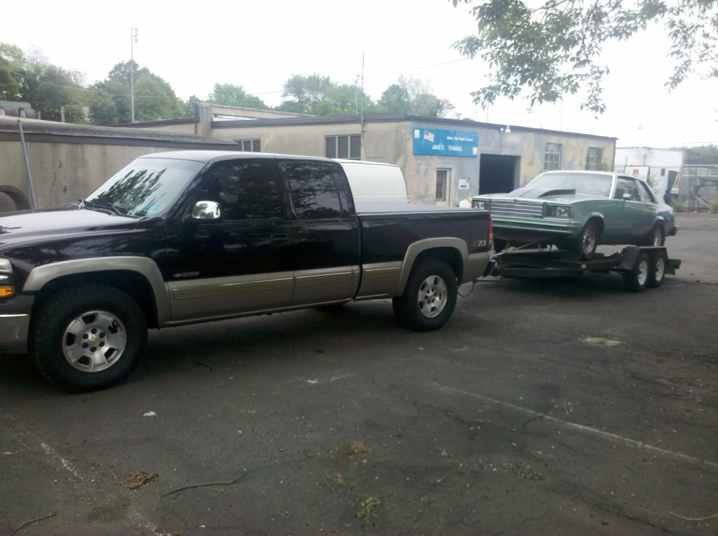

thanks for the replies so far. im waiting for the bodyshop to get me in to fix the bed side because someone backed into it while its there im getting it resprayed all black with the color matched front bumper cap and grille (truck is 2-tone gold/black and i never liked it). if i lowered it now it would look terrible so im hoping by spring. it currently has a leveling torsion key key and 285s
here's how it looks now:
