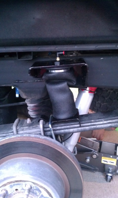

Got them installed tonight, install was pretty easy except for one of the bolts for the upper bracket. Youve got a little bitty *** hole to put a wrench or ratchet through. THe angle makes a wrench pretty useless, luckily Ive got a swivel head 3/8 ratchet that I was able to work in there. With 10psi(min recommended) in the bags it raised the *** end about half an inch. Once I get all my goodies installed for towing Ill do a thread with all the part numbers and pics. Wiring up an aftermarket trailer brake controller is a bit more entailed than past year models that were plug and play with a harness. Sorry for the dark pics, I finished about 30 minutes ago so its dark.
Before I primed the bags and attached the air line

At ride condition

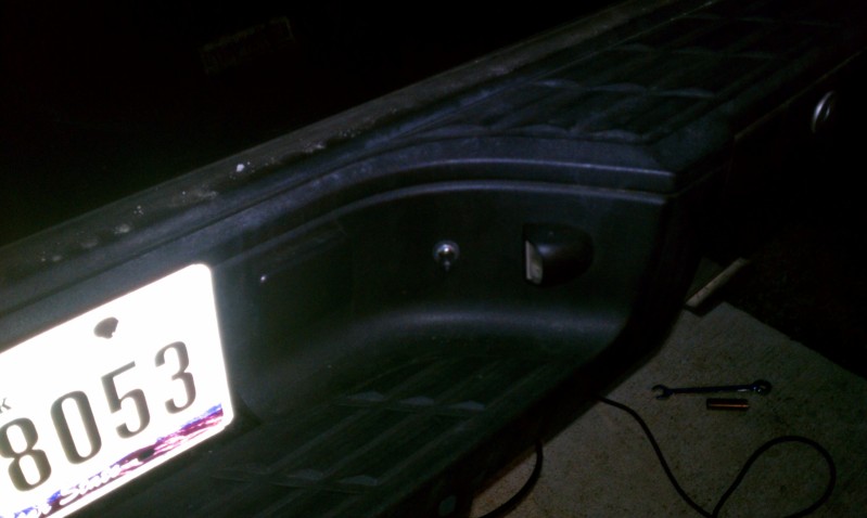

I mounted the air lines 2" off the license plate light since there isnt any metal behind the plastic there and its damn near a straight shot over the frame and to the top of the air bag. Didnt even need to use any zip ties to keep the line where it needs to be.

Im going to pick up 3.5yds of 1.5" gravel on my 3000# lowboy Saturday morning and taking it about an hour away so it ought ot get a pretty damn good workout. I figure the load will end up being around 12K GVW on the trailer alone. A little over what the truck is rated for but Ill have the bags, rancho shocks, trailer brake controller and my trailer has brakes on both axles so I shoudl be alright taking it easy. Im interested to see what my trans temps do with the stock cooler, that much weight and 90* weather.
