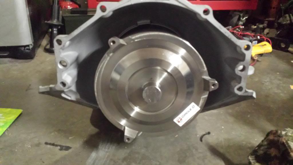

Thank you Chris at circle d. trans will be going in this weekend. may not be able to drive it but i will have it in.
Old Mar 10, 2014 | 07:57 PM
  #57
03sierraslt's Avatar
Posts: 19,007
Likes: 221
From: Western PA
Looking good man.
Looking forward to your updates.....
Sorry for all the UPS troubles.
Chris
