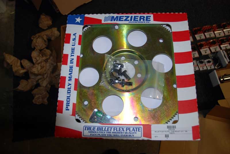

true billet...
FTW = strength
FTL = Price $$$
I paid almost $425 for this one... it is made out of 1 piece of billet, no welds.
