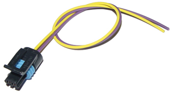

From what I can see this should be the right pigtail for the speed sensor right? Just wanna make sure I snatc the right one.

Yep...that's it. Same plug as for the ECT(engine cooling temp) sensor.

Awesome! Thanks for the quick reply, I can go ahead and order it then! I love this place
