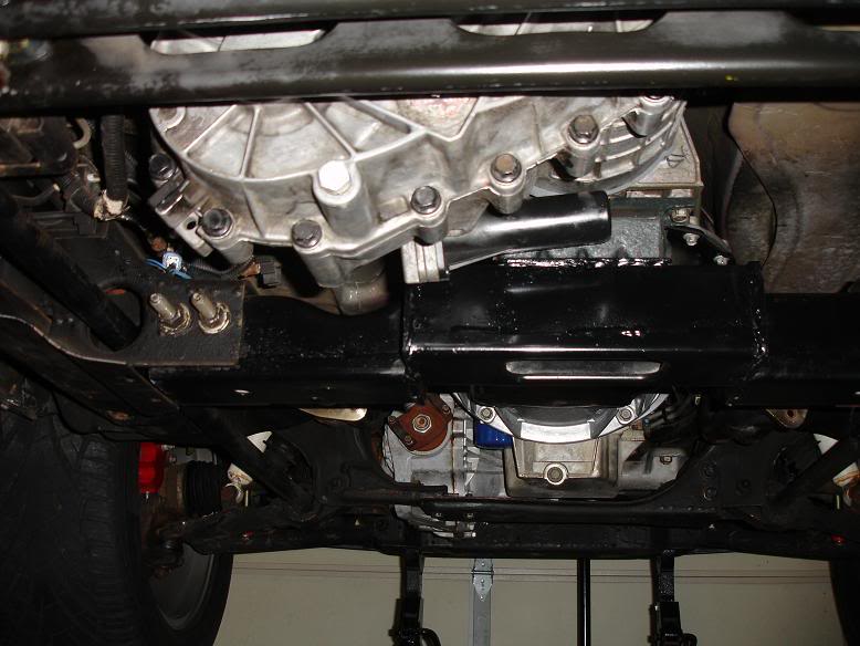

Ran into a little problem. Encoder motor interfered with the crossmember.

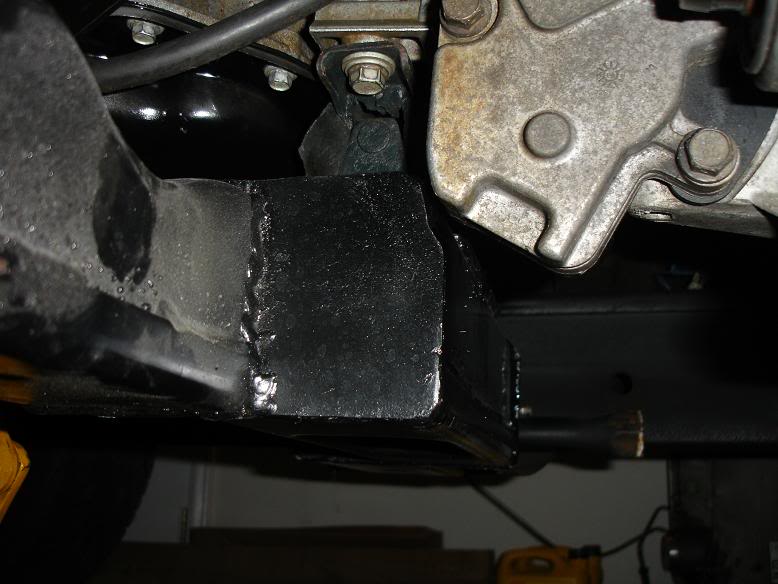

A little grinding took care of this side. Once I got the member back in and bolted up it is still touching on the far side. I'll pull it back out and take a BFH to clearance the rest.

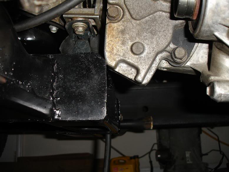

Looks like it came there from the factory.

I reckon I'd be pulling the crossmember out and cutting the ends off diagonally then welding a new piece of plate in to fill it.
Getting there mate....you must be happy it's all coming together.
Best part is driving the truck knowing the Trans is one thing you should no longer need to constantly have in the back of your mind as a "will it fail if I stomp it" thing.
This is why I'm preparing mine for the 14bolt rear swap.

Good idea about sectioning the cross member. Getting anxious to finish this and wanting to ummm, not cut corners.
Cannot wait to get it rolling. Hope the rest of it goes smoothly and will enjoy the piece of mind.
