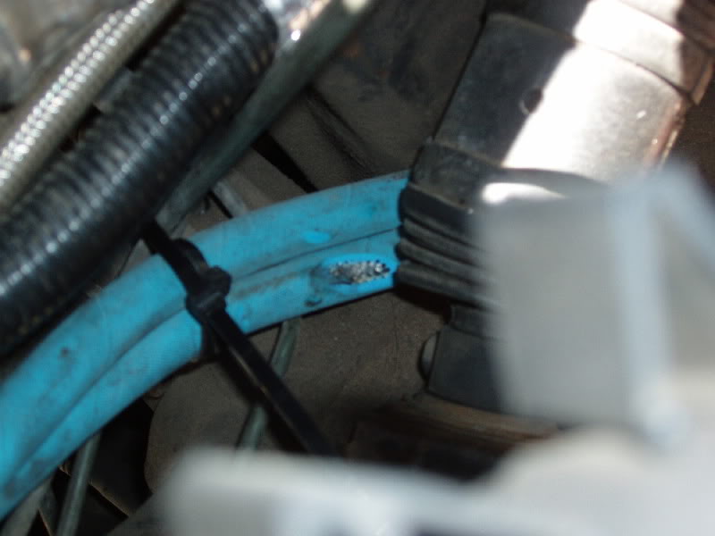

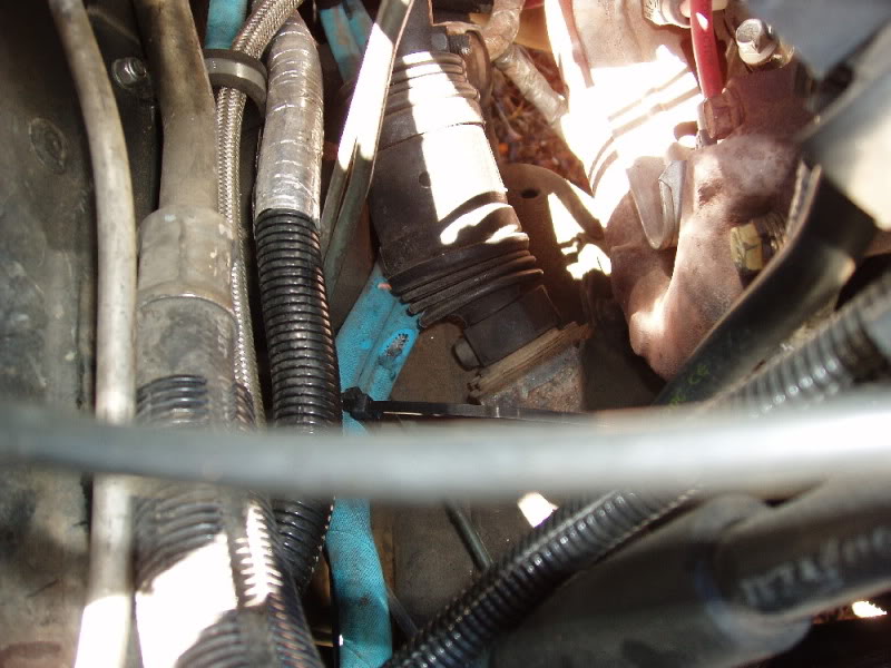

After following this thread....I decided to take some of my own advice and looked into re-installing the trany cooler hard lines and using compression fittings.
Well....looked at my current setup and found this:

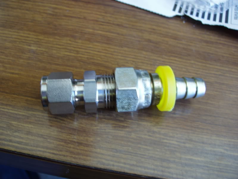

So today I'll be using these:
And doing exactly that.

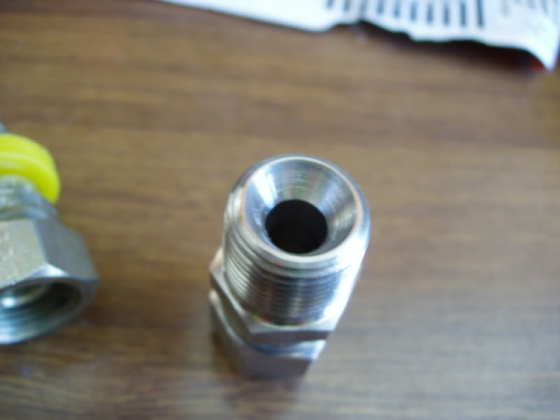

For anyone else wanting to use the 'pushlok' type fittings...the compression fitting really needs to have a 30o seat/chamfer machined into it like the one in the pic below (had them done at work).
Found that in about the nick of time A mess at least was coming... Worse would have been fire!

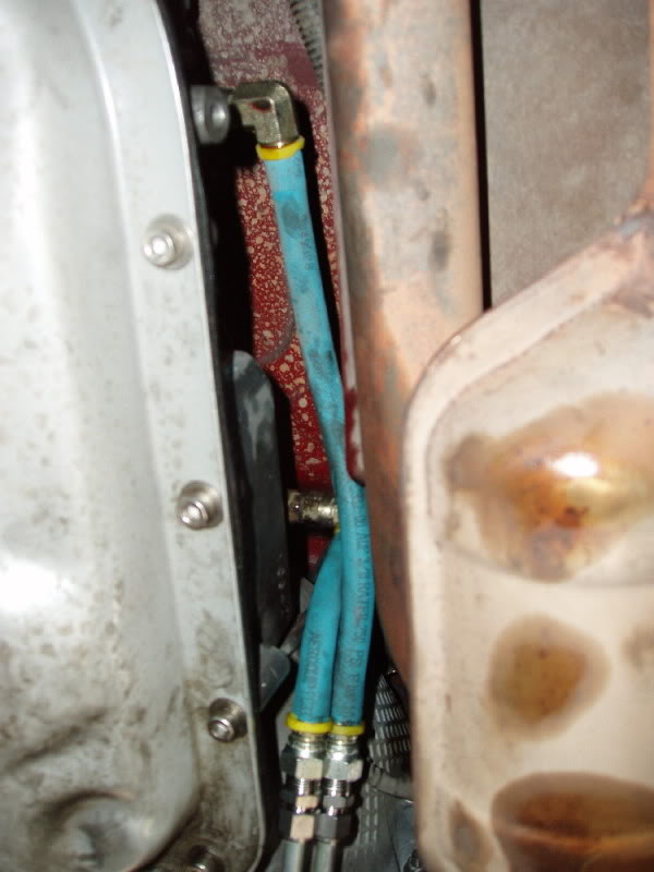

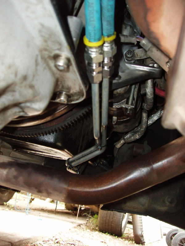

As for the Aeroquip hoses....

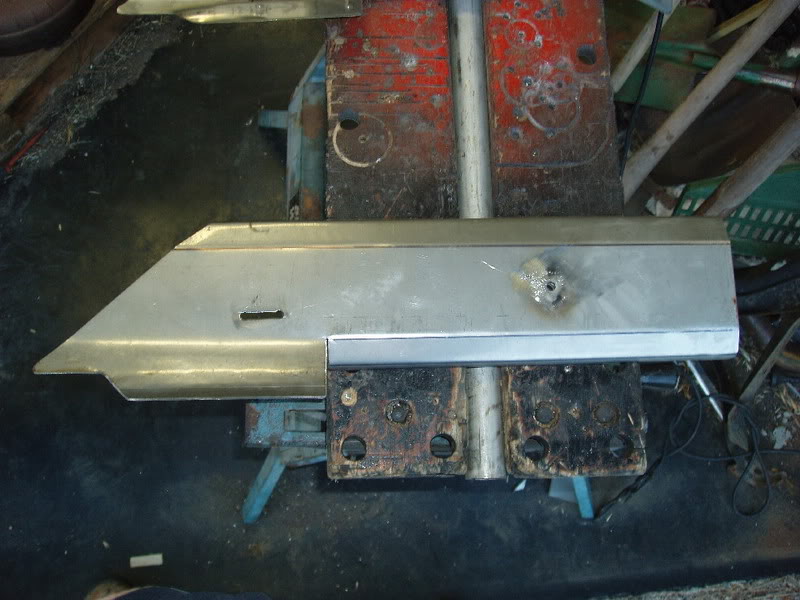

Also made a new stainless heatshield, extended to cover the hose and fittings.

=Also made a new stainless heatshield, extended to cover the hose and fittings.
Don't you need hose clamps on those fittings?
Old Dec 23, 2008 | 01:15 PM
  #249
kbracing96's Avatar
iTrader: (26)
Posts: 9,485
Likes: 31
From: Oakland, OR
Push lock fittings are rated to 250psi most of the time with out clamps. They have large, fairly sharp barbs on them
Old Dec 23, 2008 | 01:24 PM
  #250
howard quick's Avatar
Joined: Jul 2005
Posts: 363
From: Melbourne, Oz
Yeah....the pushlok fittings are fine. No need for clamps. Infact...it's recommended clamps NOT be used when using 'Pushlok' fittings.
I've actually been using the Aeroquip hose and 'Pushlok' fittings for quite a while now with no ill effects (it was originally recommended to me by a hose manufacturer/supplier we use at work).
