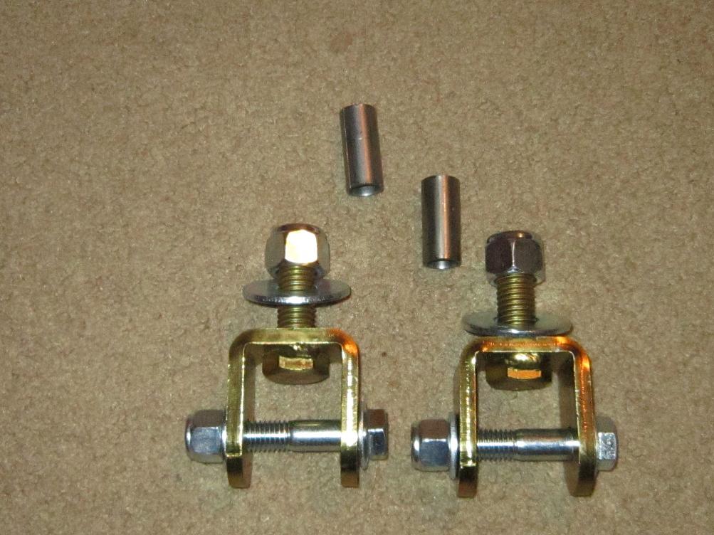

pics of parts I used. I had to chop off the useless bump stop and mount. You also have to trim the lip of the UCA for slight clearance for coil spring.
I have an Eibach part number (1200-250-1000) for 1000lb springs for the diesel trucks. They are cheaper than the Hyperco's. Get the QA1 DS502 shocks for the bearing mounts. The DS501's come with a wimpy bushing that WILL NOT hold ANY weight. I made solid bushings for my 501's.
