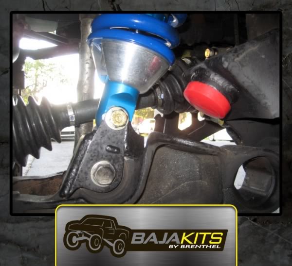

Could do something like this like the rock krawler kit
DJM lower control arms have the right mount but you probably dont want to lower it.

Hmmm that might work...I was thinking the bracket would rotate, but that middle flat part keeps it from moving.
Someone used to make a bracket similar to that for lift kits but I have been unable to find them. They had more meat to them and a portion of the bracket that used to rest near the arm to fight anti rotation. Those bushings will allow it to rotate.
I saw other pictures before where they had a plate across the front of the bracket to keep it from moving.

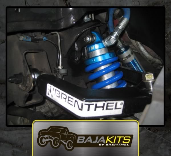

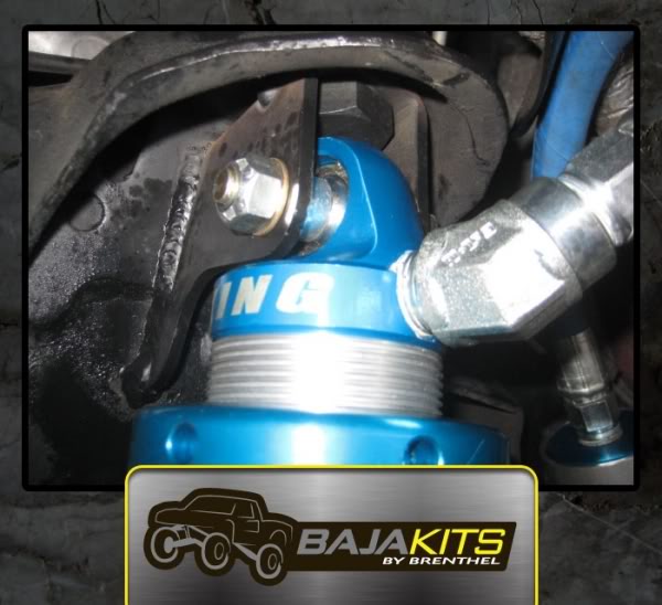

Some more pics i dug up. chase kit

^^^ That right there is the way to go. Anybody worth their salt could make those brackets in 6 months or less.

I found it on their website but they dont appear to make the 4wd chevy kits anymore....and ther f150 kit is $4500! I may call them and see if they have any of those lower brackets left...
