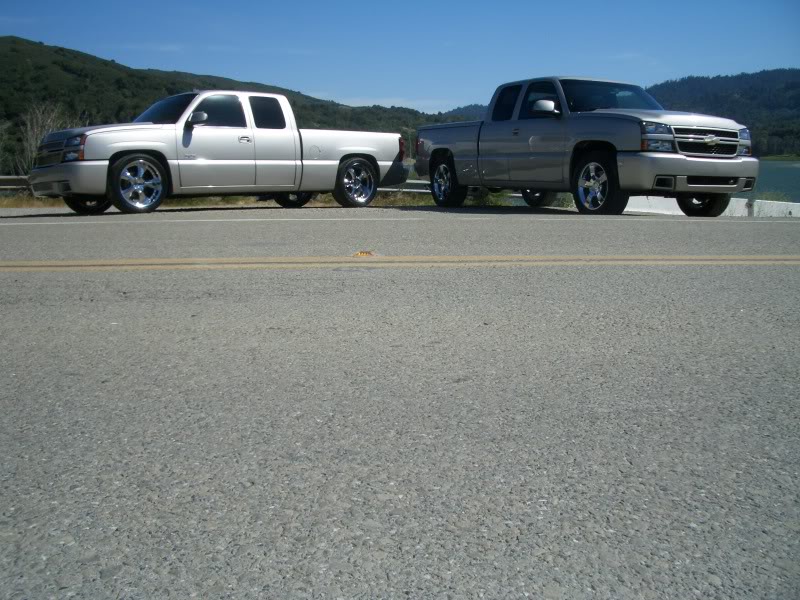

now i have no idea. ill check my receipt tonight. here's a pic of mine next to a stock height ss for reference. either way they dont stick out but if wanted to go any lower im sure they would rub.

Old Jun 19, 2007 | 03:07 PM
Nick99Chevy's Avatar
Joined: Jan 2002
Posts: 547
Likes: 13
From: Tulsa, OK
Originally Posted by RandomHero
Ah see I knew you guys were leaving something out. You both have a torsion bar system for y'alls trucks.
Cyazo6 your truck looks to be about an inch and a half taller than a 2wd truck with a 2/4 drop and coil springs.
Riviera55kid-Your truck is about 1" taller than a normal 2wd IIRC. The SS trucks are lowered 1/2 from the factory but they're still taller than a normal 2wd truck.
Also you'd have to have about 40mm of backspacing on a traditional 22x9.5" rim in order for 305/40/22's to even THINK about working.
BenVortec-if you haven't bought the tires yet then run something like a 285/40/22. That size tire would work well with a 2/4.
He didn't leave it out, it says "SS" in his sig.
I'd only run a 285/40 if you have the correct backspacing. A 30.5" tire is about the tallest I'd go without optimal backspacing. With DJM 2' lcas I had one tire rub occasionally and it's only 29.7" tall. Now I have McGaughy's spindles and it's almost a full inch higher. Personally I'd run a 265/40-22.
