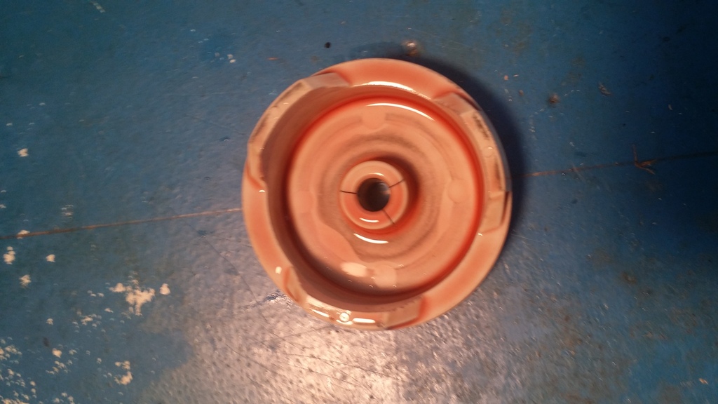

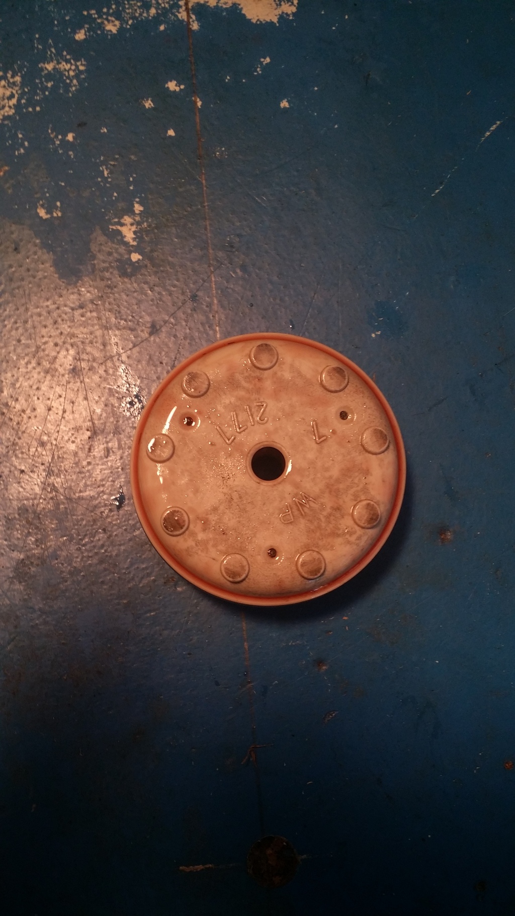

Posts: 147
yea i read that and said **** it, so just dropped the pain instead.
1-2 accumulator piston.

bottom side.
i got the new pinless piston in stakes the hole the best i could, i couldn't push the ball out or lightly tap it out so i think im good.
got the accumulator back in. now just getting the info on the vette servo install now.

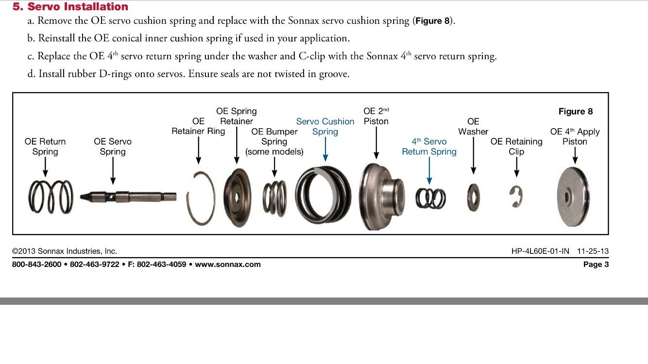

This help??

Sounds like youre good on the check ball staking

just got done printing the steps from the diy here. so wish me luck.
