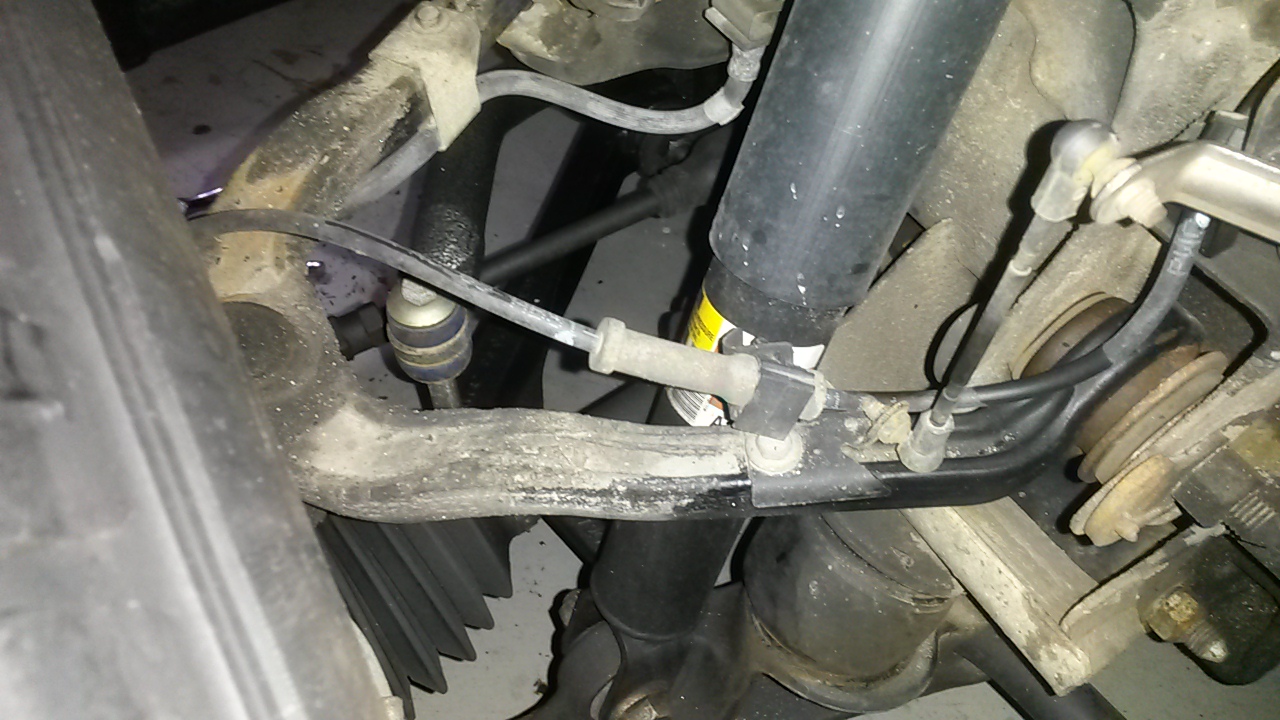

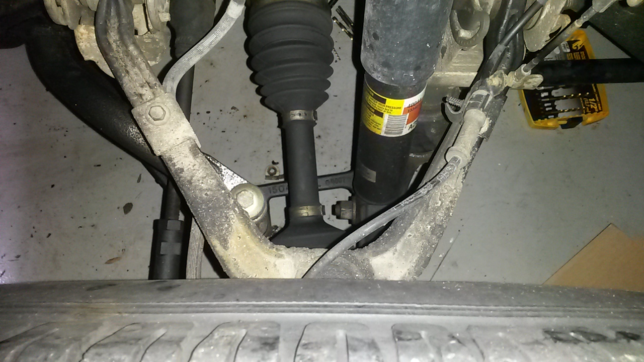

Here are some initial pictures of the 2004 Yukon Denali Front Suspension. I will be on a business trip till Friday but after that time I can get you additional pictures or measurements. Anything you would need just let me know.
The only thing different about my set up is that I am using an aftermarket bump stop. This bump stop is cylinder shaped instead of tapered like the stock setup. It provides some overload ability and artificially raises the spring rate. As you can imagine it doesn't ride all that great but it stops the constant bounce from worn torsion bars without committing to a lot of work (tbar replacement).
Timbren Front Suspension Enhancement System TGMFK15A
Between the closest part of the shock tube and the bump stop there is about 1/4 of an inch. Between the top of the bump stop mounting plate (stock) there is about an inch of clearance. Not talking about the cup it is mounted in -- just the curved piece of metal at the top of the frame that the cup is welded to.
Would you like additional pictures or measurements? How does this compare to regular 4WD trucks?

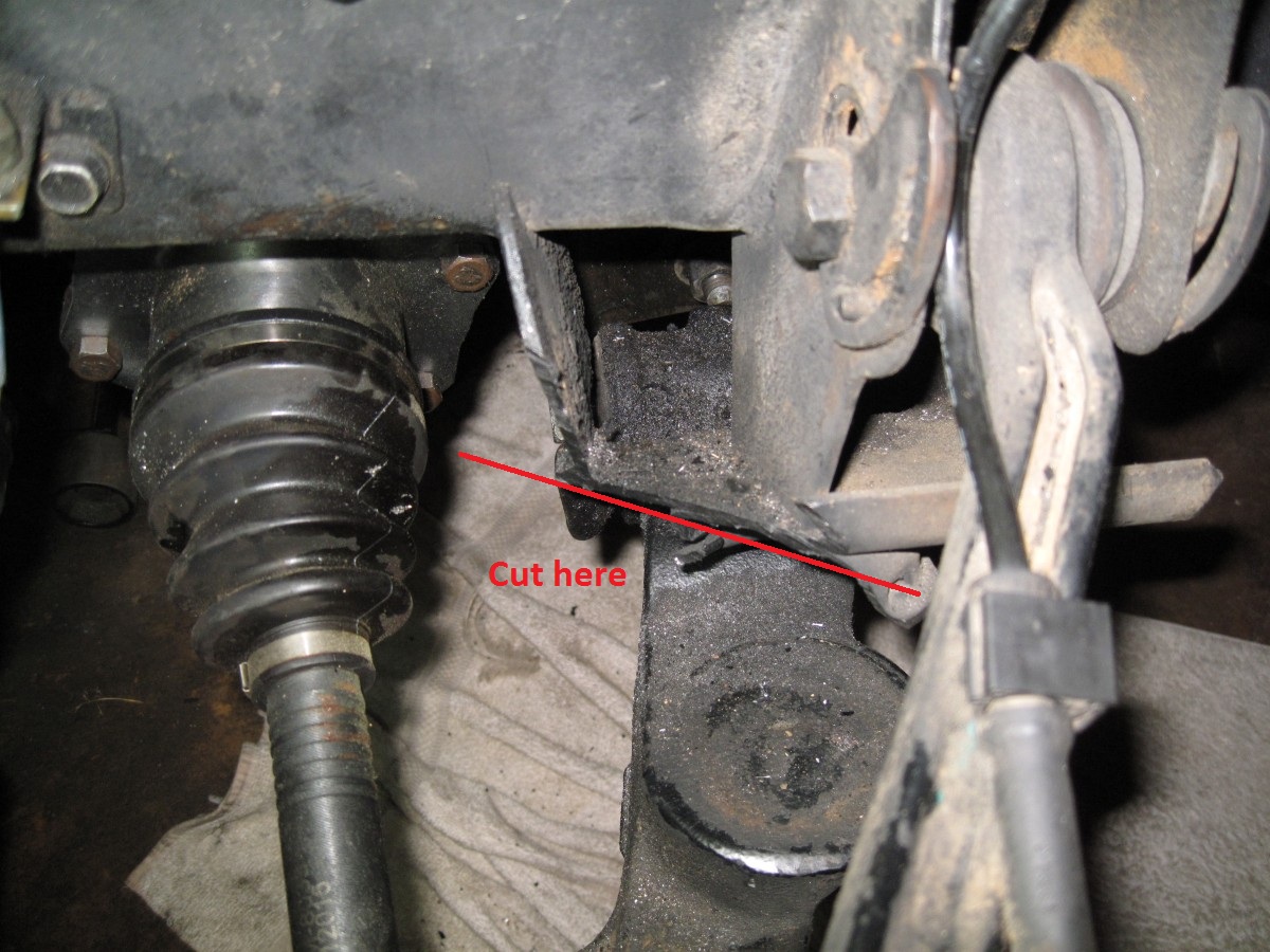

The LCA and shock area looks like every other truck setup ive seen. That bumpstop however would have to be redone to the kind like I use to give the spring enough clearance. The part of the frame where the bumpstop is mounted would also need to be trimmed with a sawzall, but thats normal on all of the installs. I attached a picture of what I mean.
So it looks like it would work to be if you cut off that corner and redo that bumpstop. Let me know if you want to try it!

Yea, 3.5-3.75" OD. If you look in the attached picture a few posts up I have a picture of what needs to be cut off, its just the corner of that little piece.
