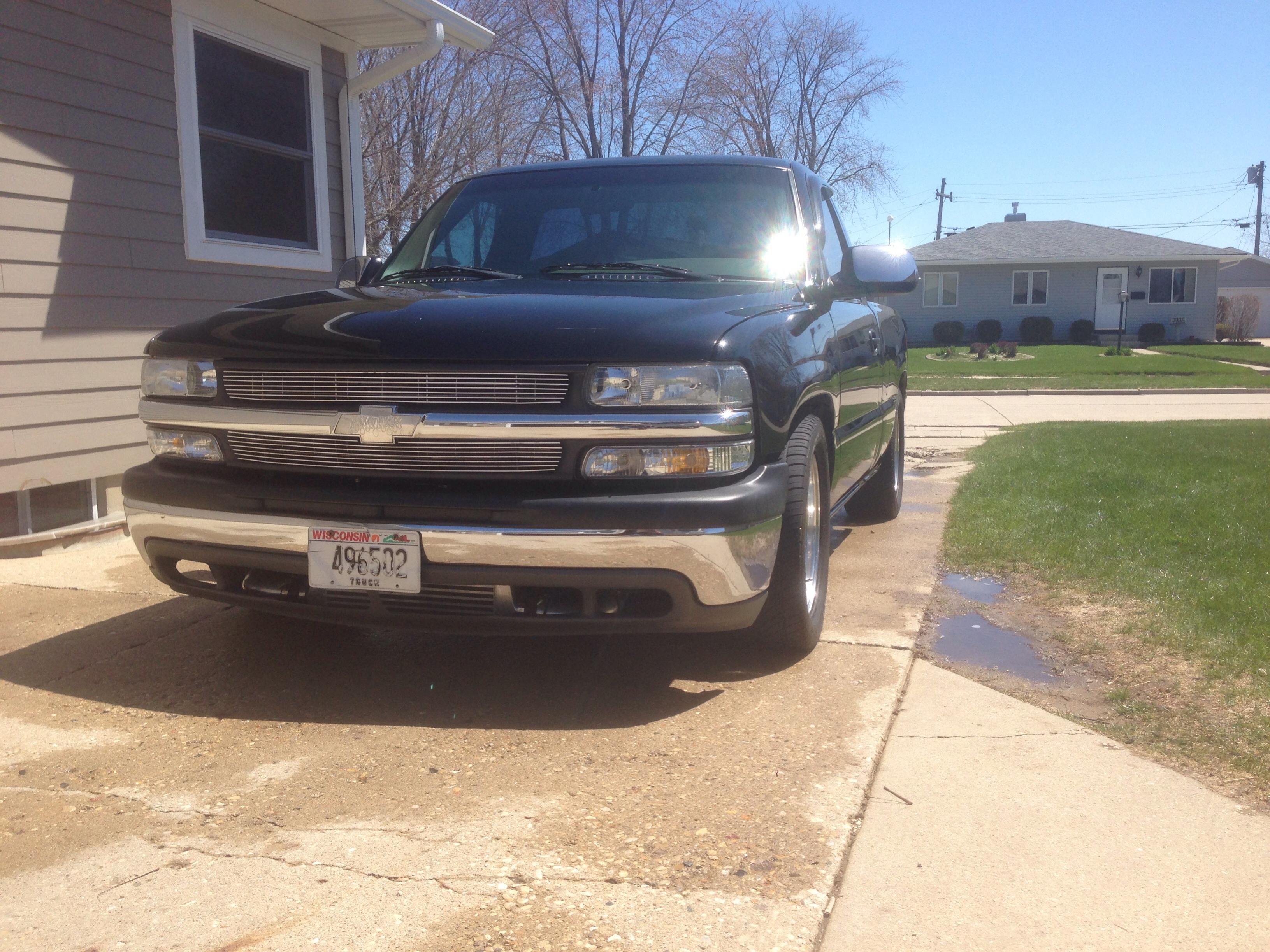

Just washed it so I could post a few ride height pics. 29.75" to the front fender.

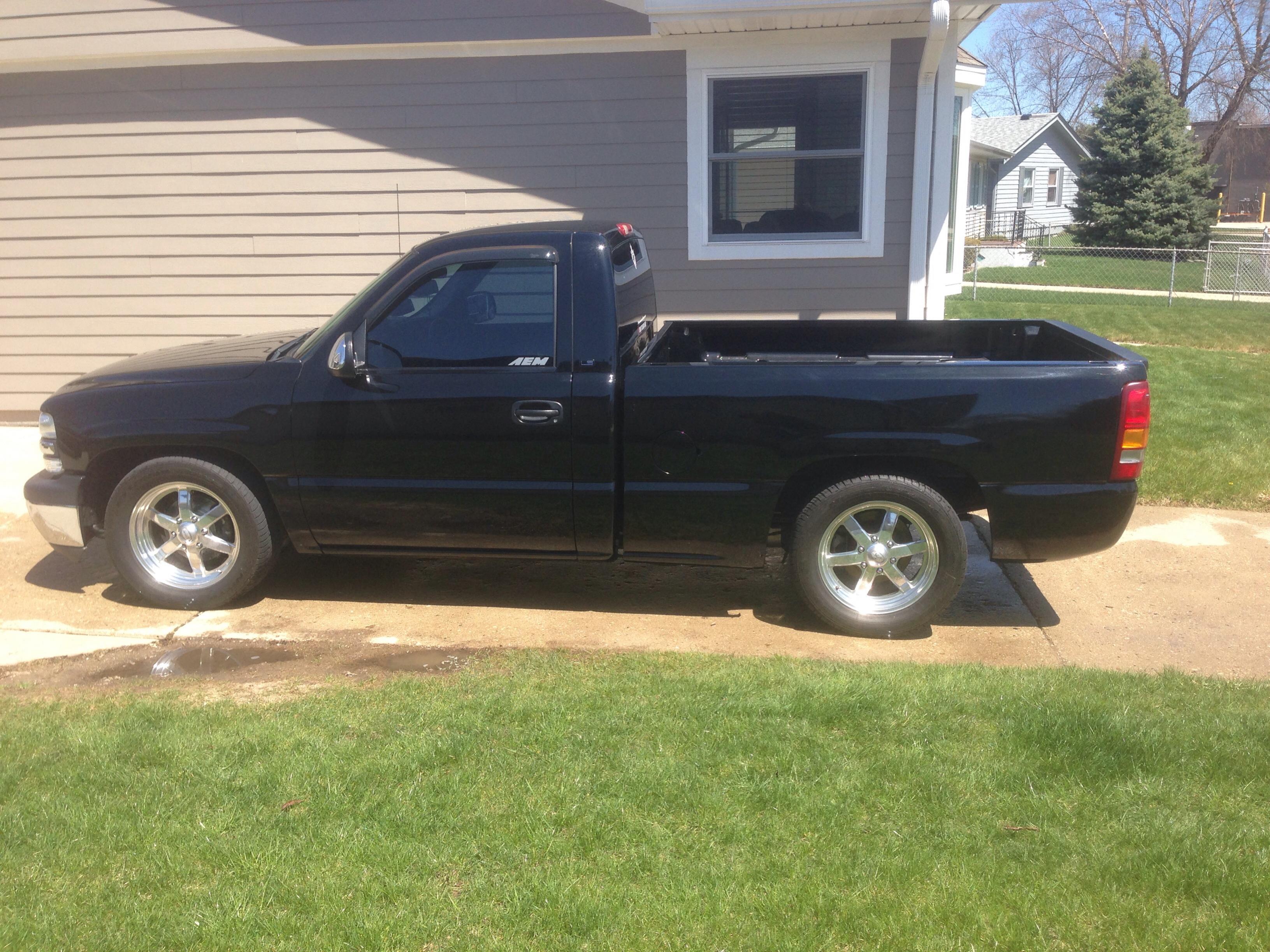

One more.
