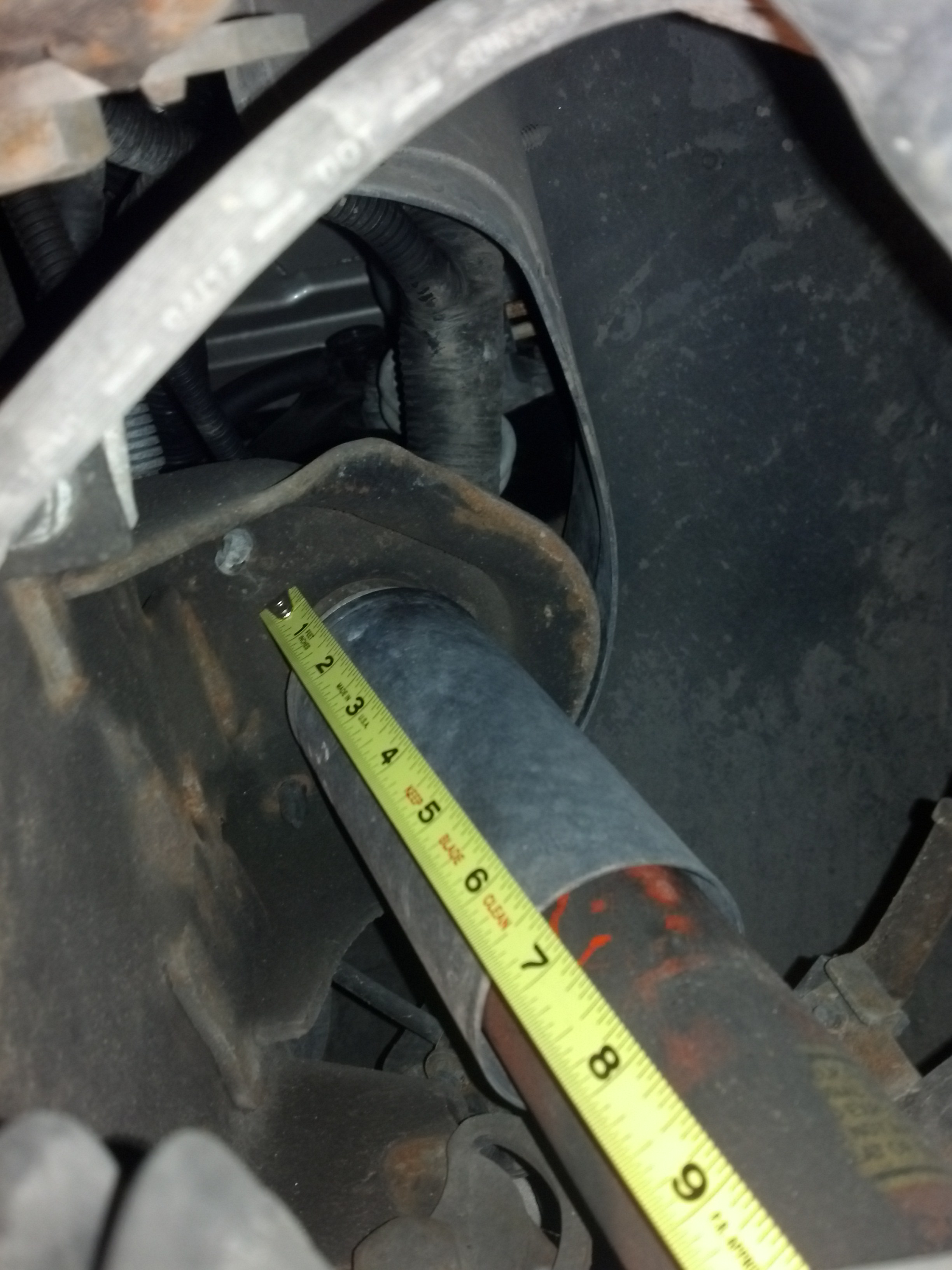

Its the measurement I always talk about between the lower shock bolt and the top of the spring frame perch.
The ride height is not editable because it is a result of the type of brackets used and that main measurement I talk about. Everything is based off the main measurement, which is why I saw to use a jack and adjust the height of the truck where you want it, then make that measurement.

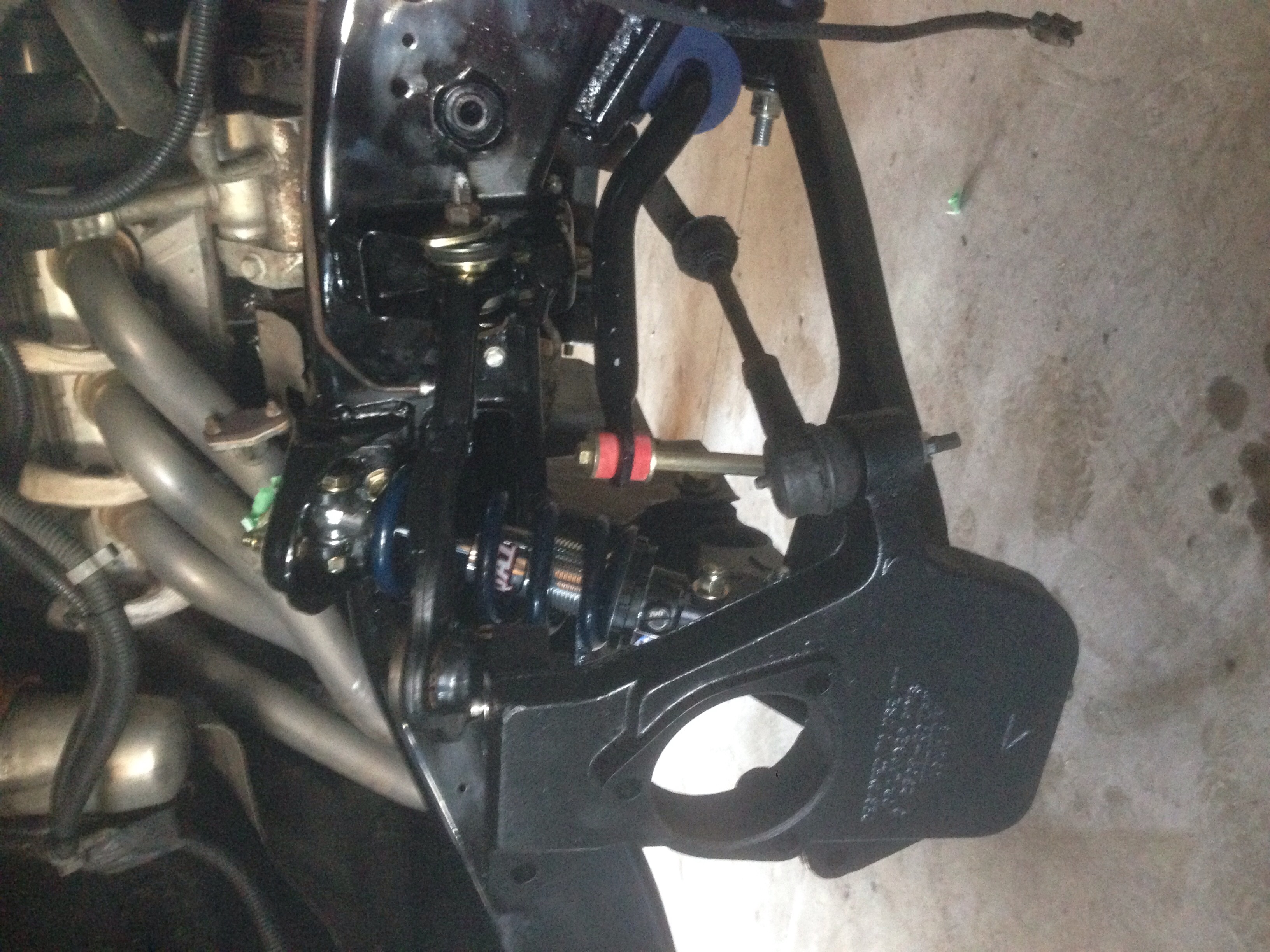

Just waiting on the new brakes to show up! Also removed all 4wd parts in the process! And por-15 the frame!

That looks really good!

when you talk about taking the main measurement of the stock shock ride height, you say from the bottom mounting bolt to the top of the shock mounting hoop. When you say the top of the shock mounting hoop, you are talking about INSIDE the cup where the shock bushing meets the hoop, like in my attached pic...right?
