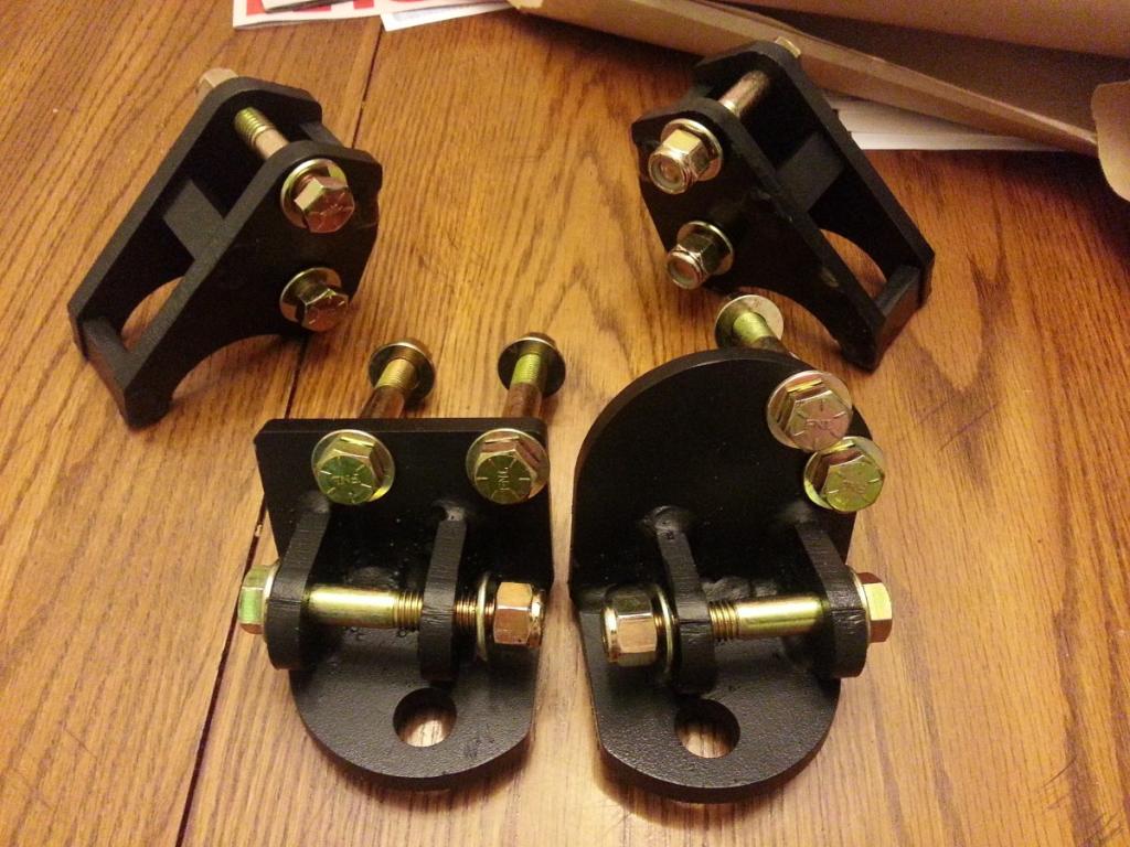

Pretty much finished the new upper brackets. I have one more set on hand and it will be a couple weeks before I can have more material cut. I have some of the older styles on hand that use the procomp adapter, and actually thats what I still use. The newer style would be for lifted or slammed setups only.
When you say "lifted", is that anything more that stock height? I'm prob between 1-2" higher which is the best compromise/combination for my needs. I'd like to try the newer upper mounts so I can keep my shock length as close to what it is now.

By lifted I mean a lift kit the uses spindles or drops the LCAs, you dont need the new ones with only a 1-2" lift. The older ones are a little more user friendly, just dont offer the clearance needed for lift-kit trucks.
