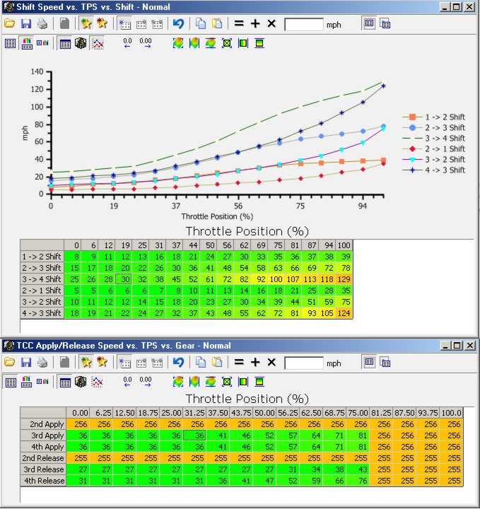

heres the trans table graph requested.
Attached Thumbnails 65e Trans again or something else?-booth_trans_current2008.jpg

  #26
krambo's Avatar
Joined: Jul 2005
Posts: 1,609
From: Bangor, PA
Originally Posted by BlackSSS
WOW. So about where do you think the power cutoff is for a 65e sconsidering 5k + lb truck awd? So are these companies advertising 7-800hp cabable 65e trans hogwash?
I second the opinion on calling FLT. I produce similar numbers as you in the same platform (AWD SSS) and my FLT LV 65E did just fine. Cutting 1.61 60 ft times in a 5500 pound truck surely challenges the build quality of their work. There is obviously a limit to what the 65 E can effectively handle and alot comes down to daily driving habits, temperature and tune as eluded to in the aforementioned posts. Good luck with whatever route you take.
