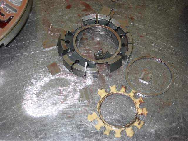

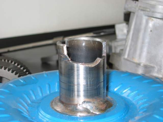

From: Panama City, Fl
The converter is likely broken where the neck engages the pump. If that is the case, the pump is trashed too. Had this happen with an aftermarket converter and 4L60.
