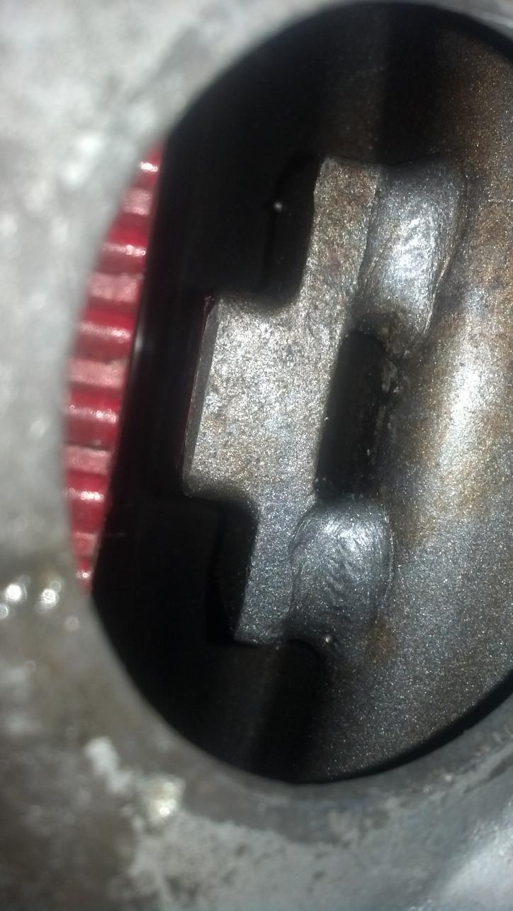

thank you. I thought the same thing that it is way to much. I just posted a picture from the sight hole. And I was thinking to shim it as well. I just cant figure out why out of three rebuilds with this trans. Why now such a gap. I measured the old converter and the new one. The shaft length (female) on the new converter is about 1/8th longer than the old one. If it was 1/2 longer then I wouldnt have this issue it seems.
