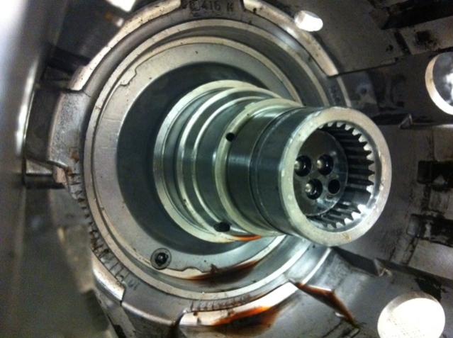

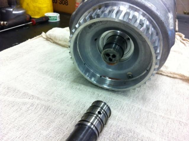

i broke the input shaft in my Hughes Performance trans. I repalced the input shaft & the seals on the shaft. when I put the trans back in the truck trans trys to go forward in all gears including N & P. reverse locks up like there are two gears engaged. im getting tired of pulling this thing in & out & apart. my question is, Has any one broke an input shaft & did something elese break at the same time that i should look at, or that could cause the input shaft to break?????

Got any pics? was it the shaft itsself? or the drum that it splines into.
If its trying to move forward in N and P maybe your forward cluthes are bound up. Did you make sure to check the forward/overrun/and 3-4 pack clearances?
Like Gilbert said^^ I have had a forward sprag break other parts in my 4l60e from slipping and catching sending shock throughout the trans. I like to install Sonnax 2-3 HD valve thats applies the extra clutches over the sprag adding support. With this valve you need to race in "3" not OD position or "D" i think is on the trucks

silverz28camaro - no i didnt check any of the clearances, i just transfered everything into the new drum the way i took it out. yeah, it was just the shaft. its a cryogenically frozen shaft & the drum has a steel sleve pressed onto it to try and prevent the shaft spinning in the drum.
