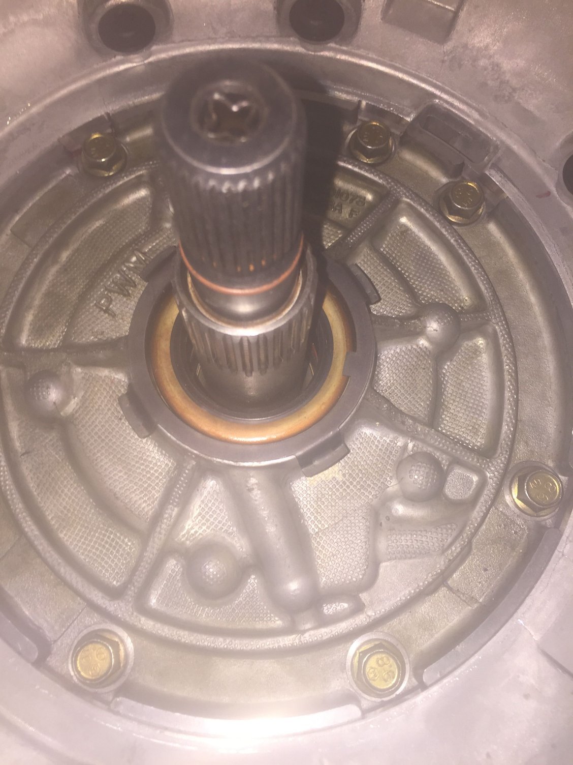

Well got the 68 in and my end play is damn near perfect.... .017"!!! Hallelujah!!!

Check ***** in valve body
Separator plate and gaskets in place with 1-2 accumulator and retainer plate thing
Valve body in and torqued!!!
At this point another hour or so and i am done... Have to replace manual shaft seal, filter seal, install filter, pan and extension housing and bellhousing!!! Now its a matter of getting my torque converter.... And cam..... and cats..... And v bands tig welded.... Not sure how my current cam will fair with a 3000 stall......

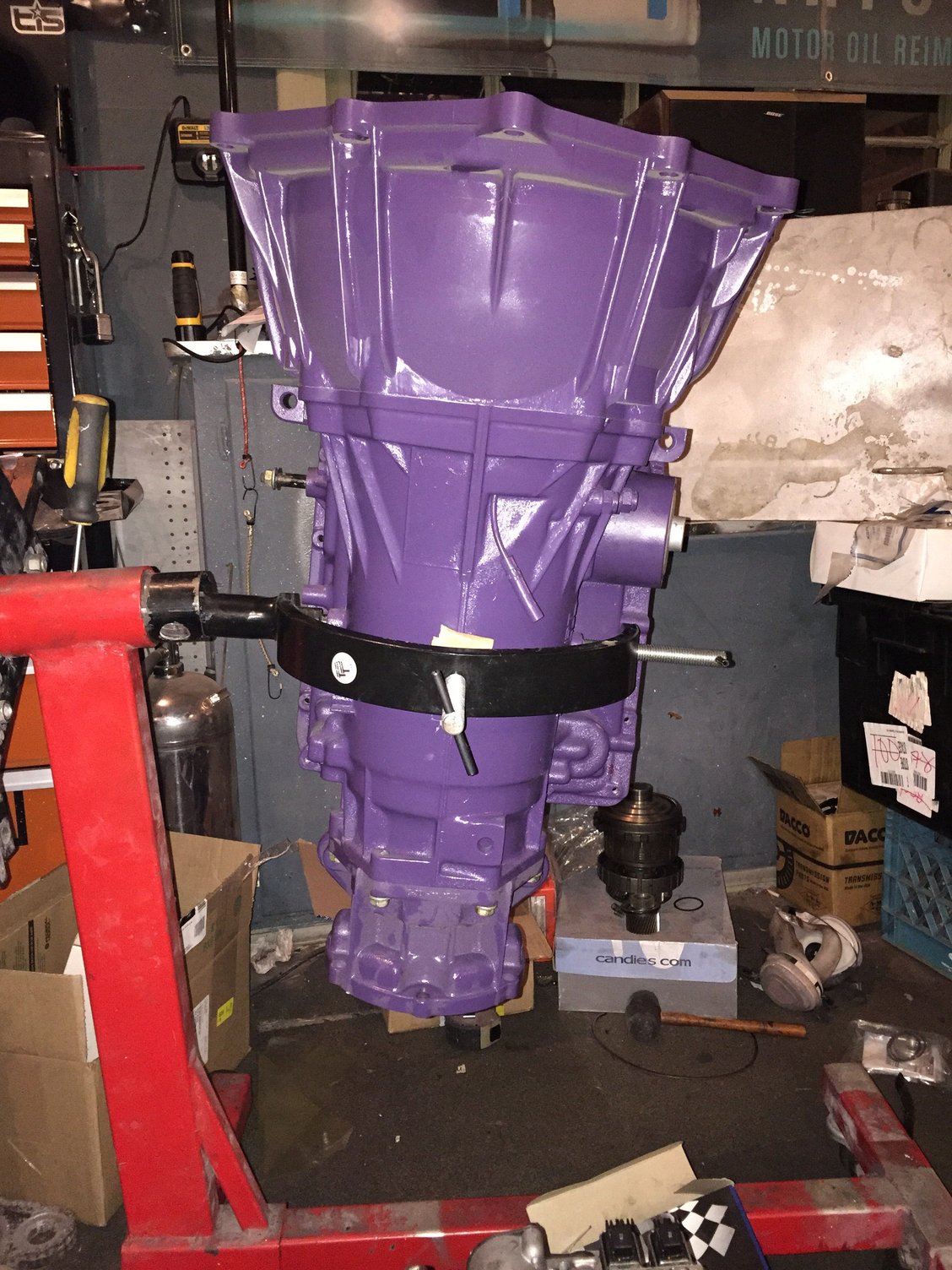

Pump seal retainer in place
I decided to go ahead and throw the bell and tailshaft adaptor housings on....
On my way home my dumbass realized i completely spaced all of the little filter/screen things on the separator plate Boy do i feel stupid, got over anxious!!! Oh well gotta pull valve body back off..... Damnit!!!
