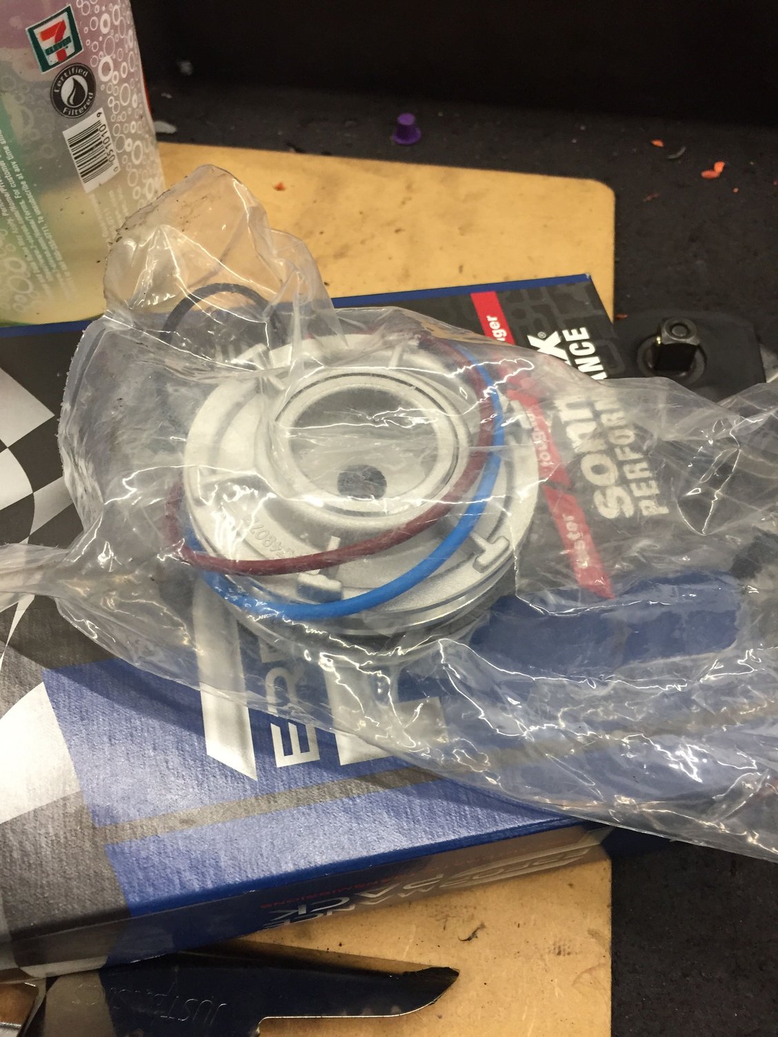

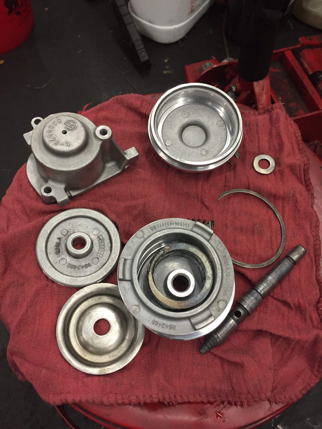

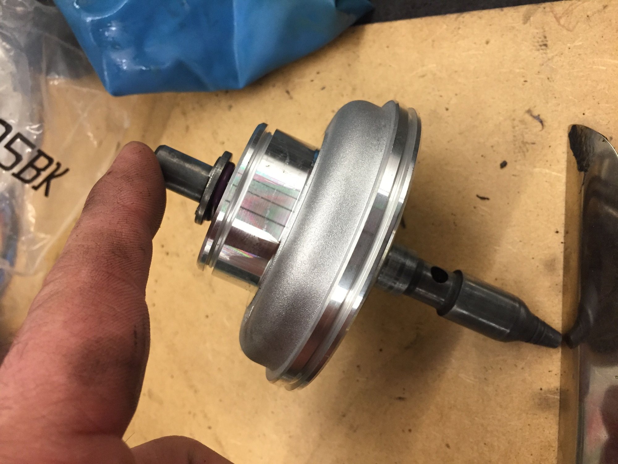

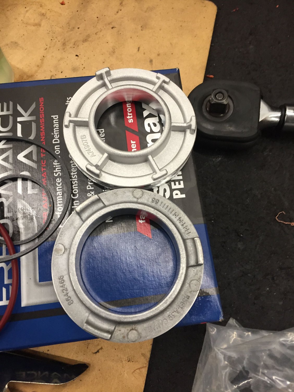

New delco reman valve body.... $21+ shipping... Rockauto rocks!!! I got this and a full set of sonnax accumulators for something like $45 with shipping!!!!
The new valve body separator that came with valve body, wish i knew that before i bought the other one last week guess ill be returning the other one!!!

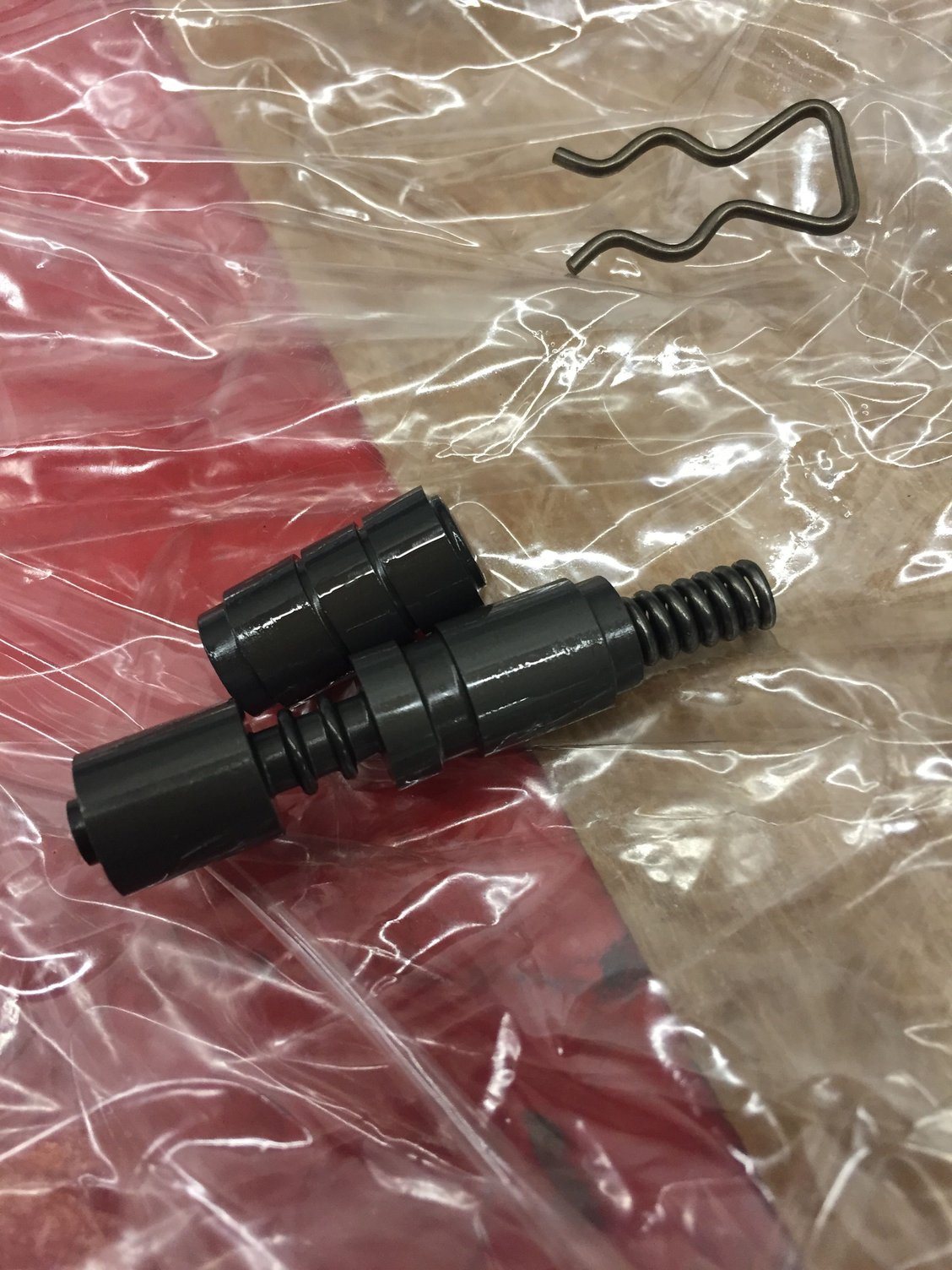

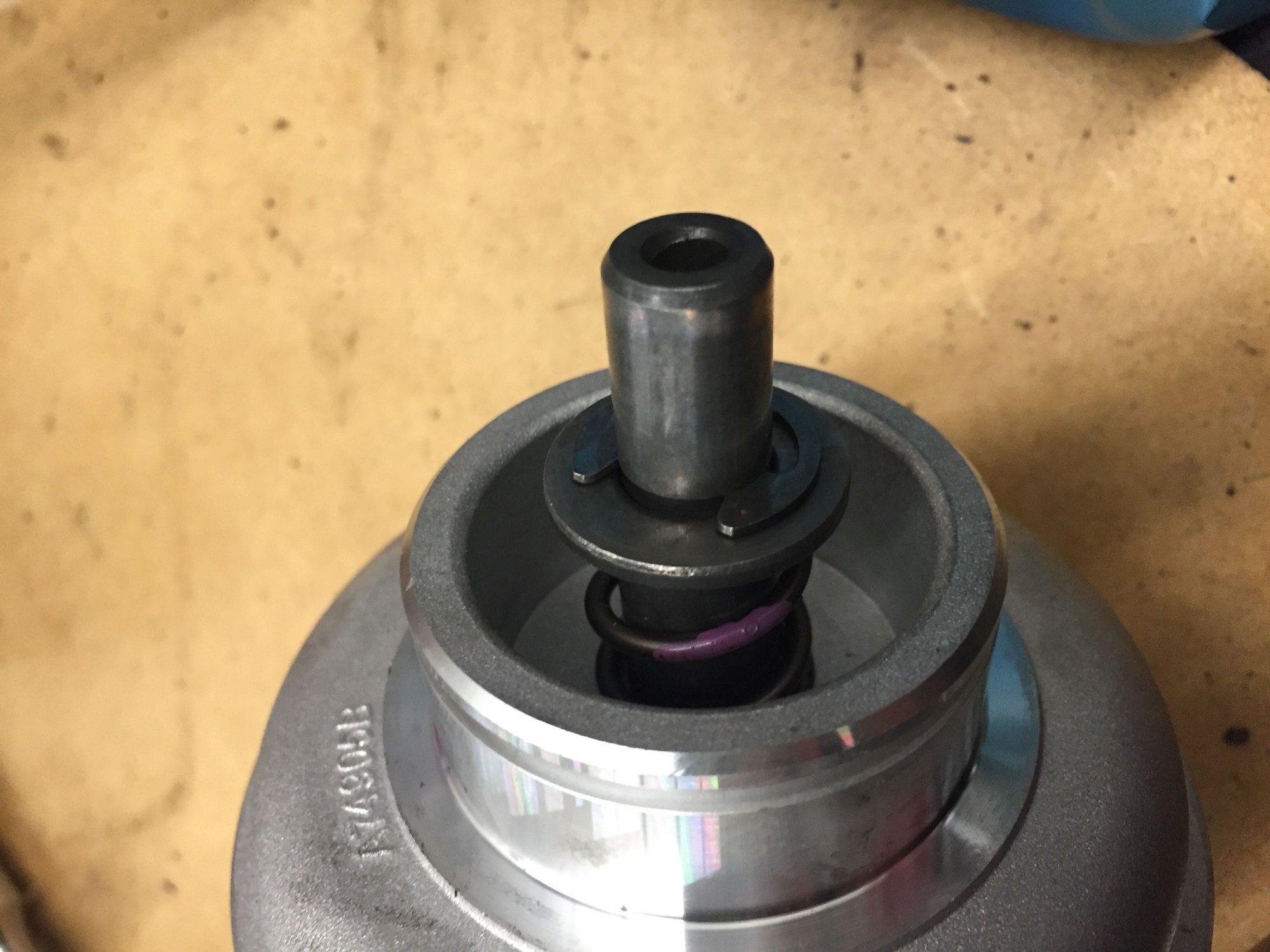

Vette servo..... 15.00 shipped from amazon

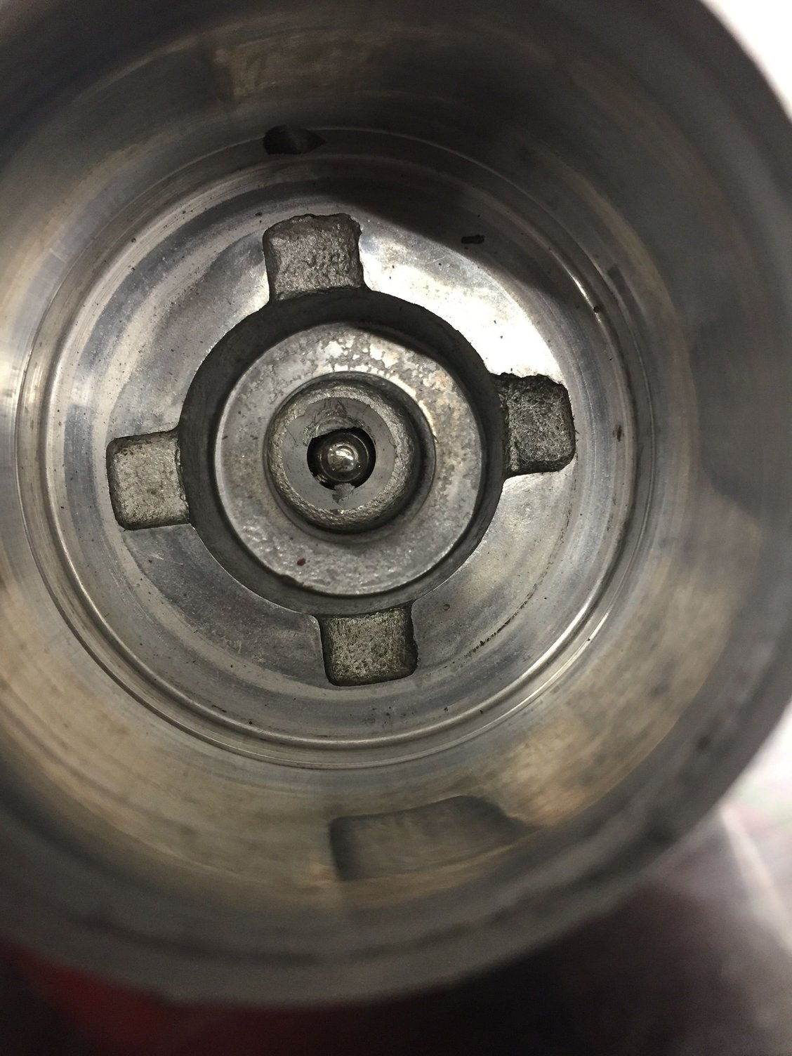

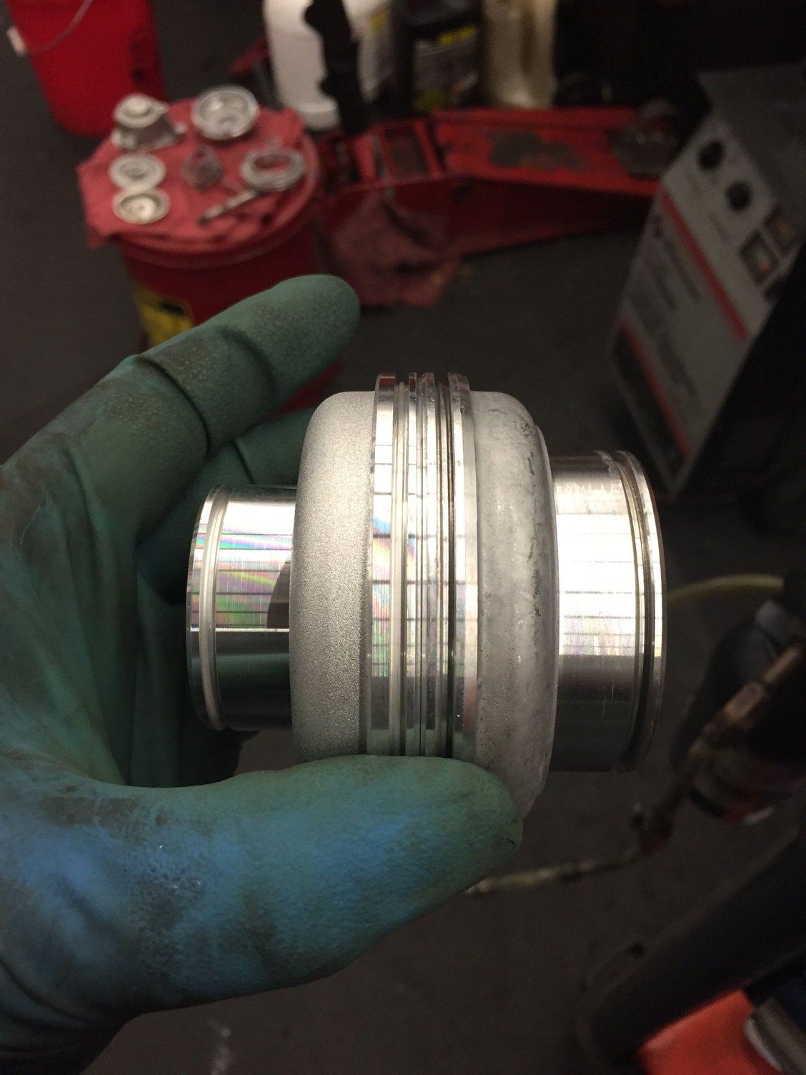

All the servo parts and accumulaor housing cleaned up!!!
Vette on left, oe on right A little comparison
Top is vette, bottom OE

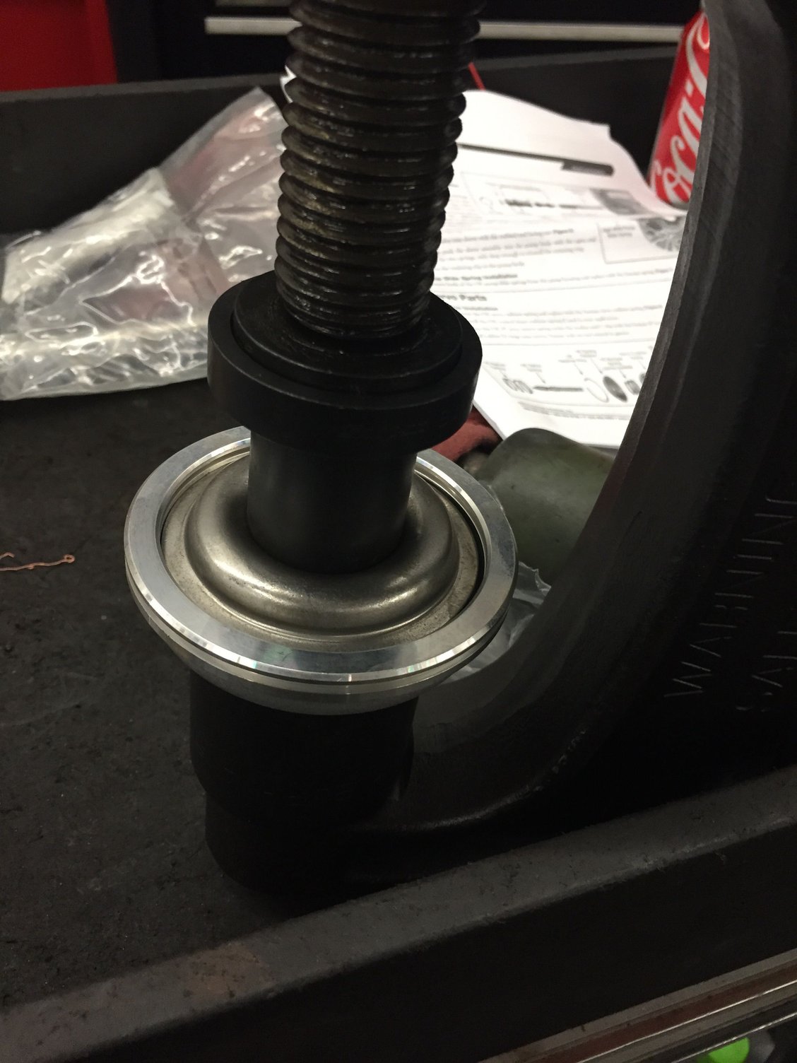

Compressing spring housing into vette servo, used my ball joint press, to get snap ring back in
Clip back on

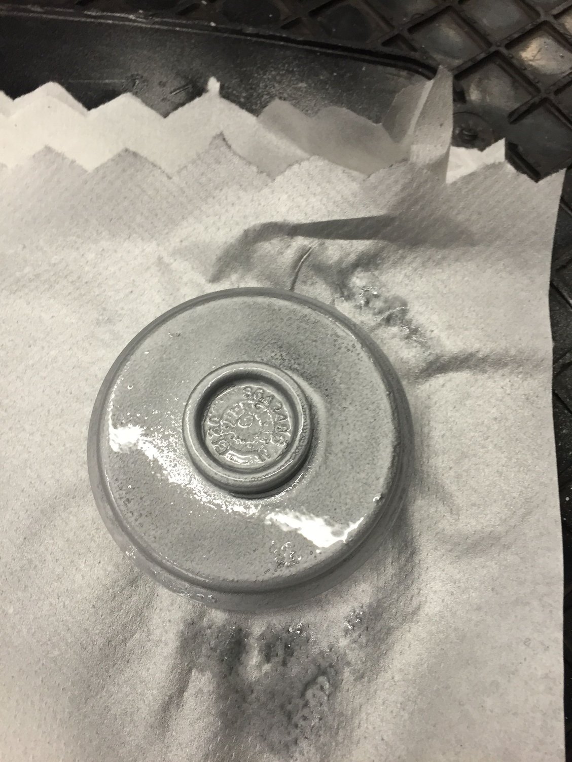

Painted servo cover... Aluminum paint, i really like that paint for accesory brackets etc

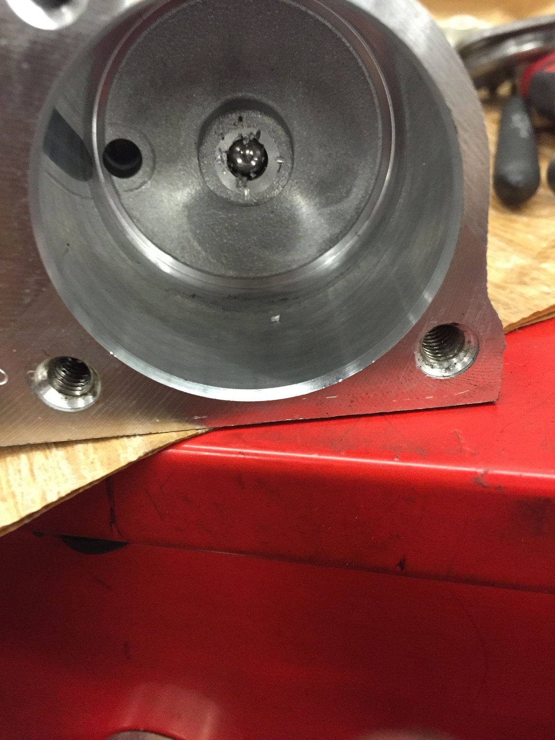

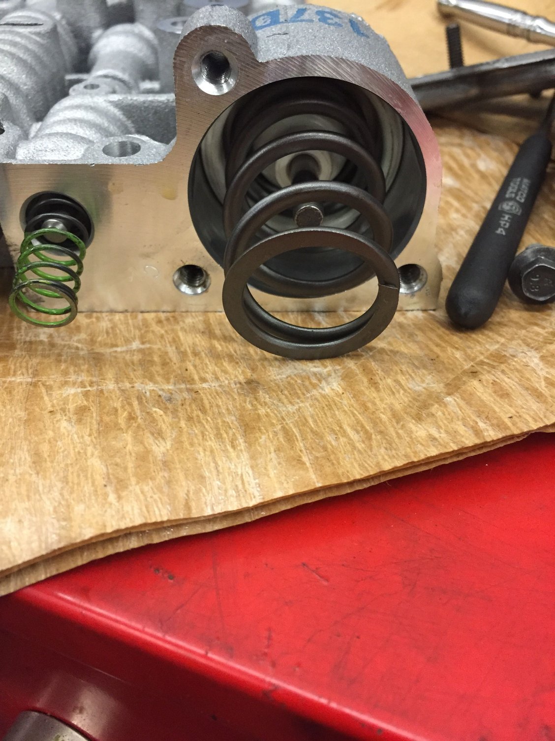

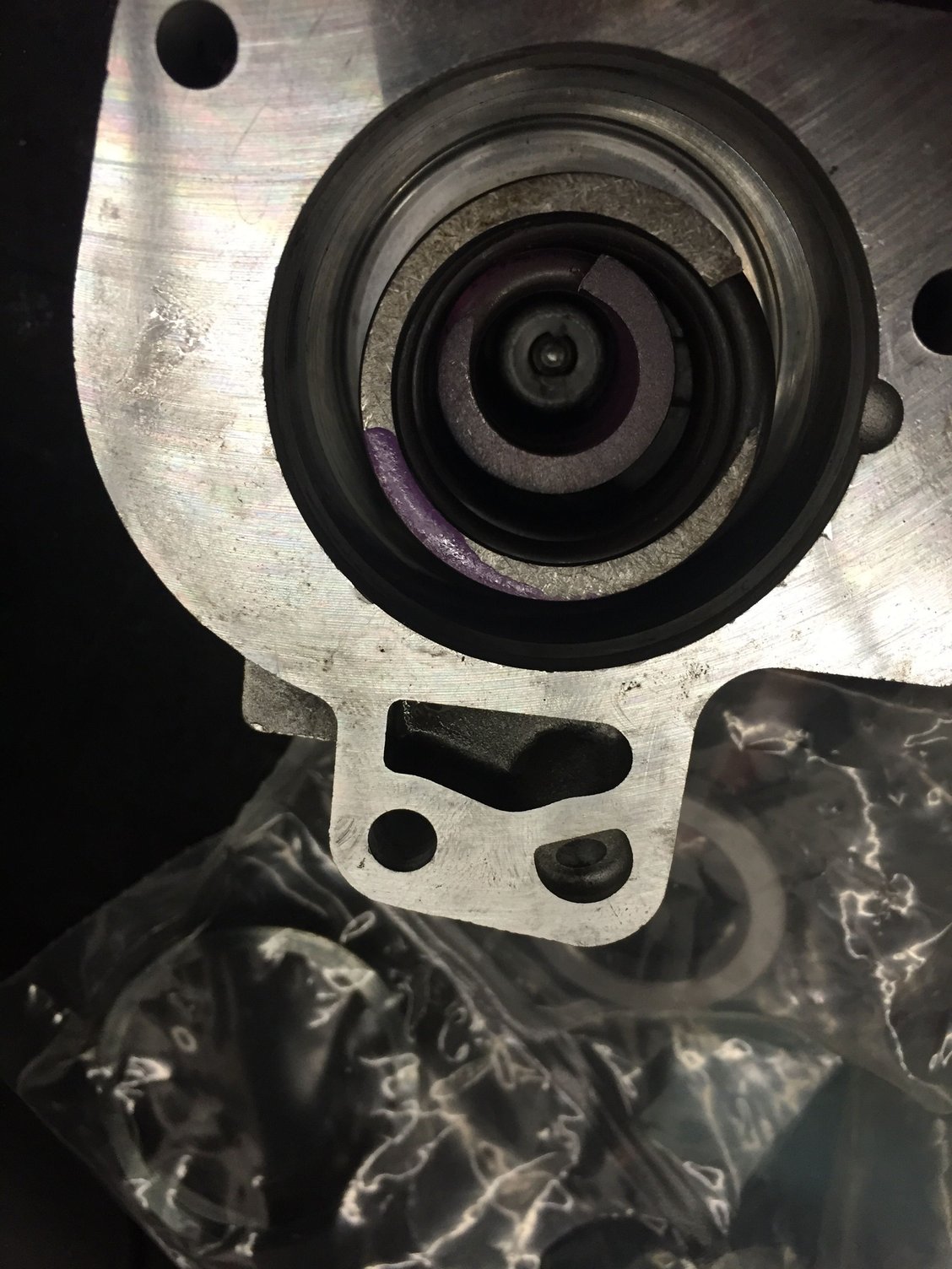

And now for sonnax, ***** in housing staked, half of my punches are broke waiting for snappy to get em replaced
Inner sonnax spring installed
Outer sonnax spring installed
Piston installed, wave spring goes beneath it..

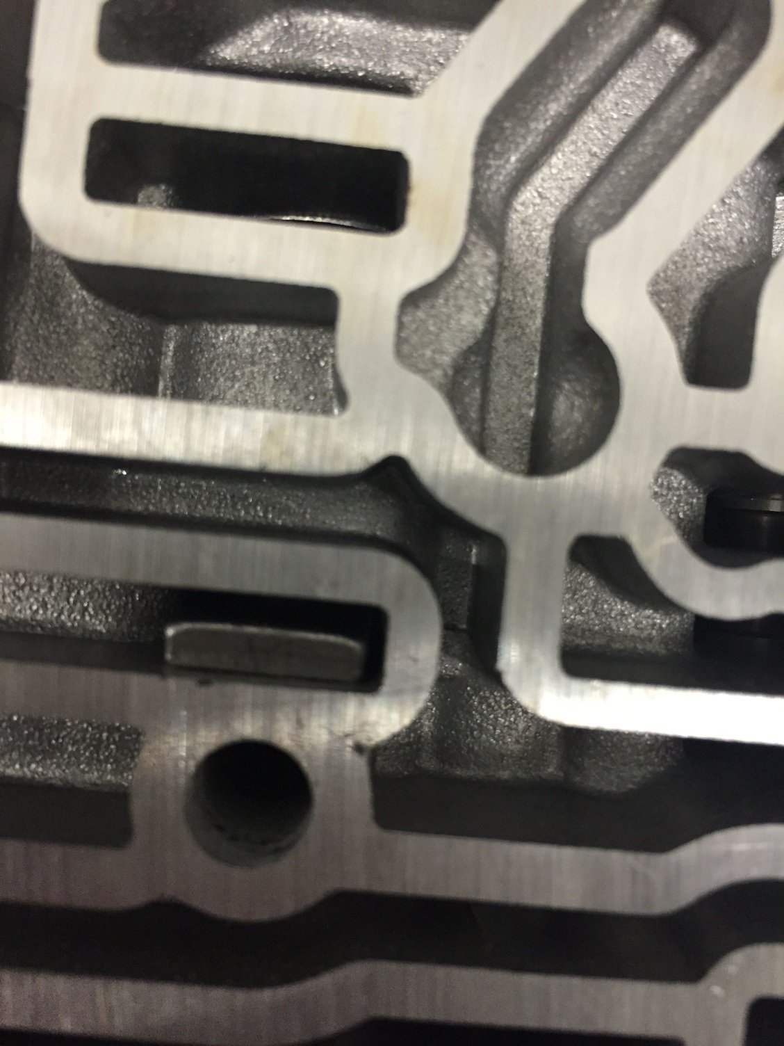

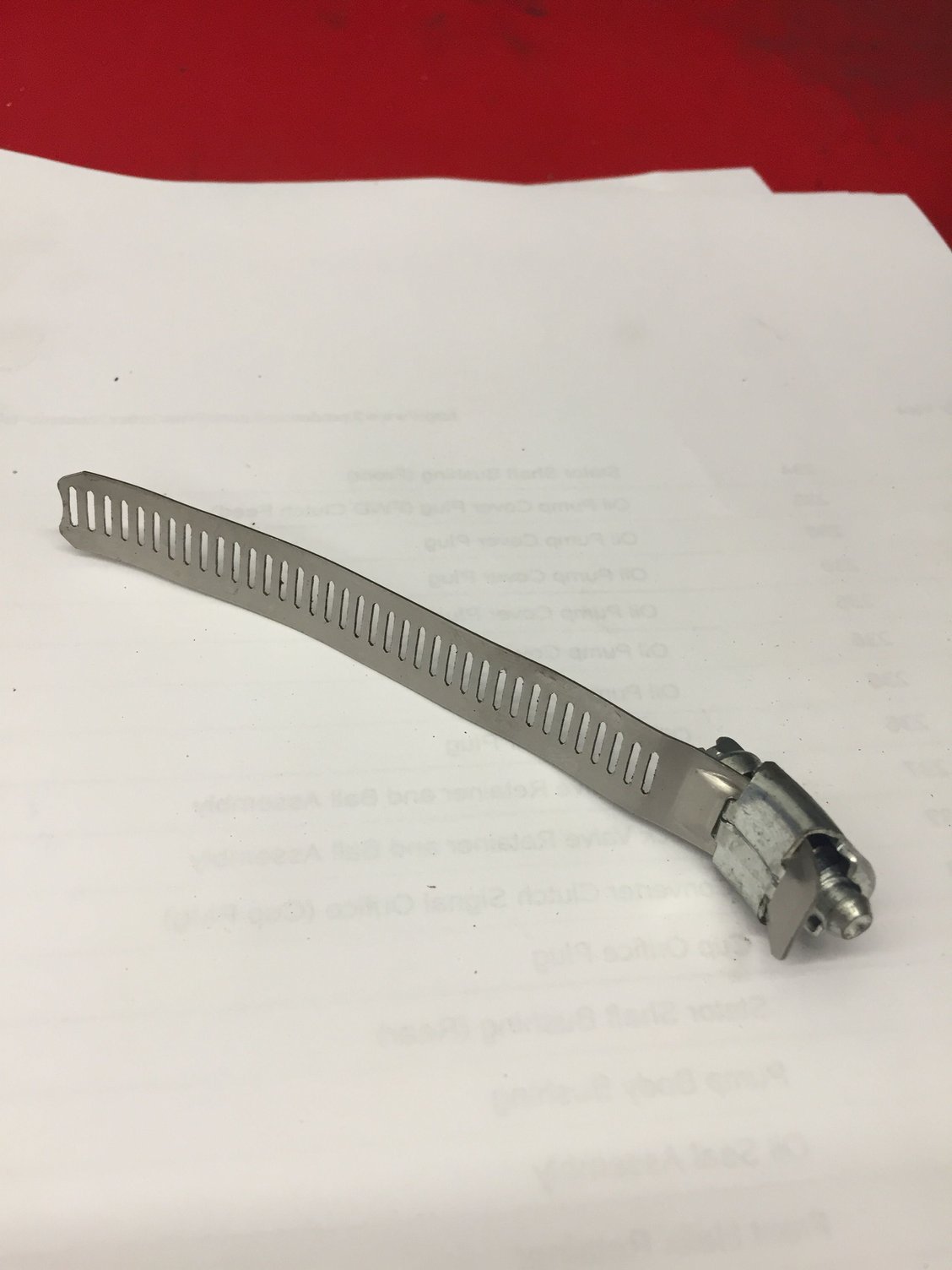

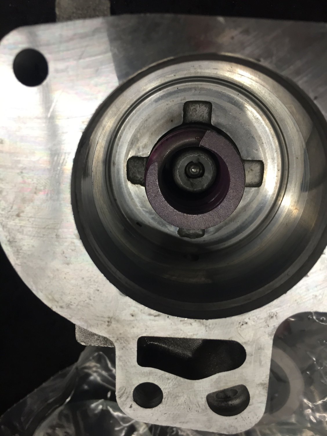

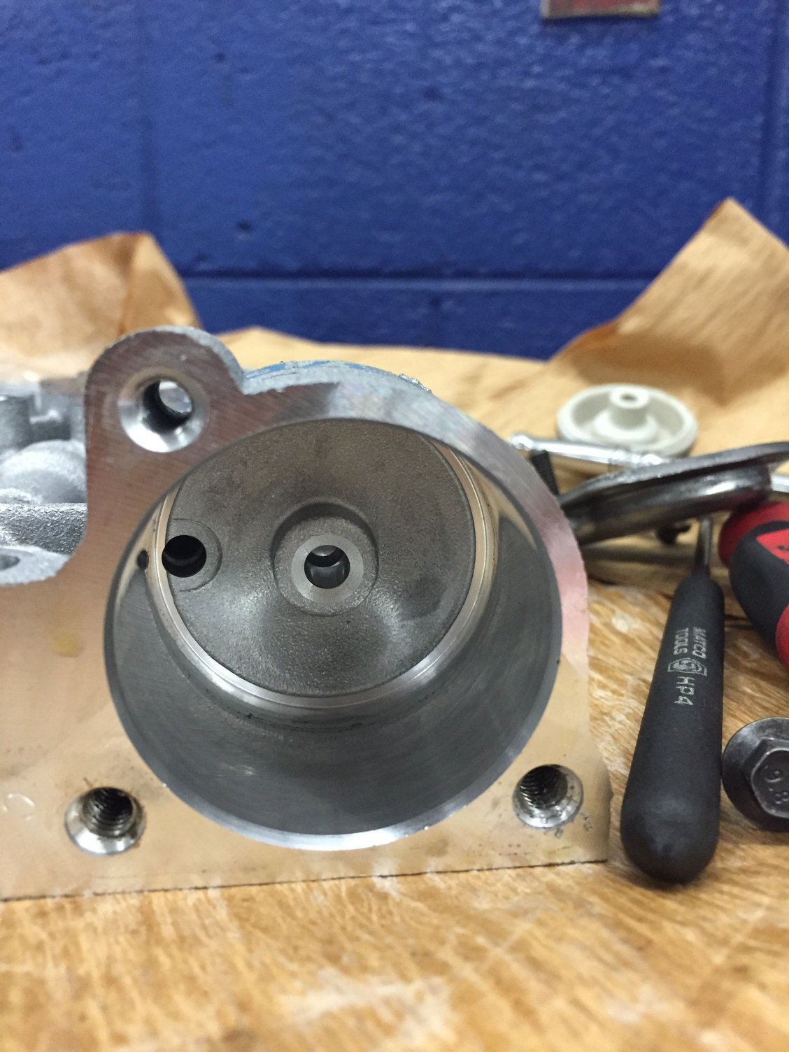

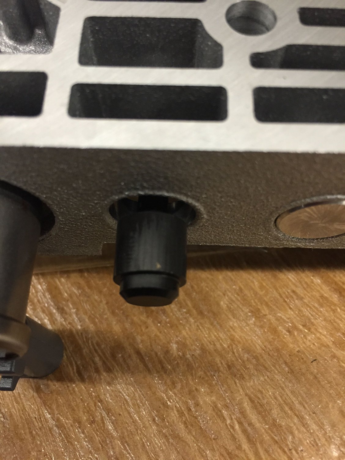

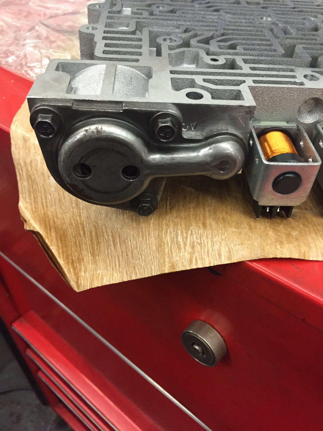

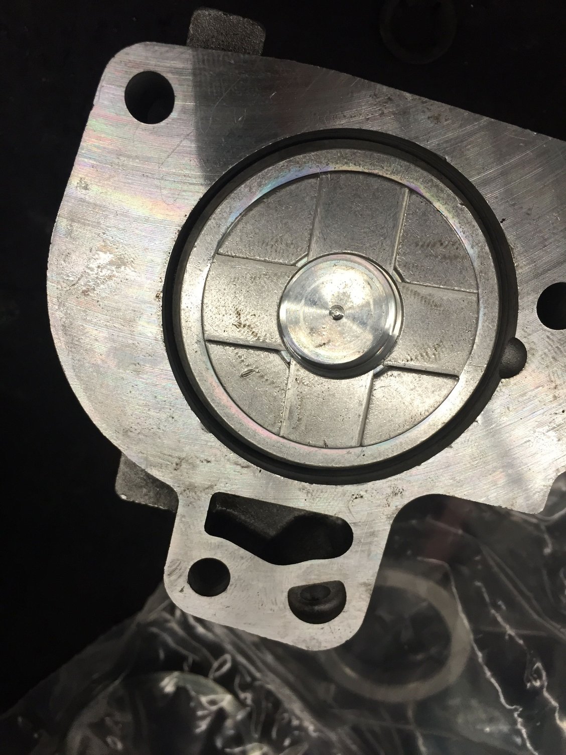

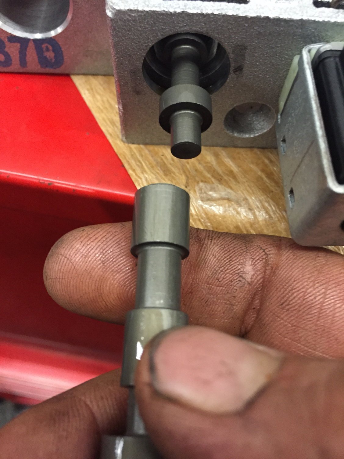

Installed most of rest of valve body parts tonight too..... hopefully, i can remember what pics were what.... Here we go!!!!
Old tcc valve...
New one goin in with spring
Accumulator valve shim... PITA!!!
Forward accumulator plate off
Pin pulled, piston out!!!
Both ***** in and staked...shitty stake job BTW!!!
I missed some pics, apparently!! Piston goes in spring next then cover... Was running out of time at work... So busy tonight!!!
Hd 2-3 valve goin in!!!
My handy dandy accumulator valve shim installation tool... Lost a set of feeler guages somewhere....
