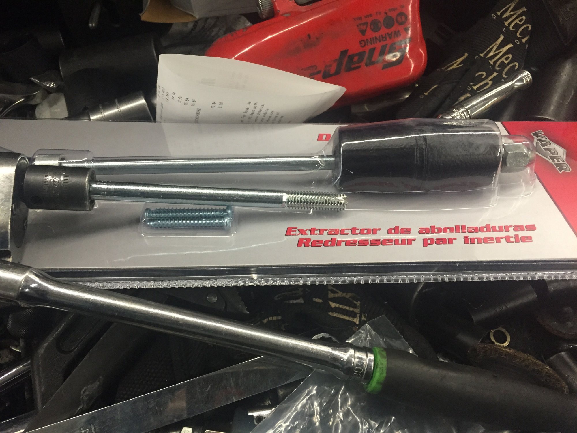

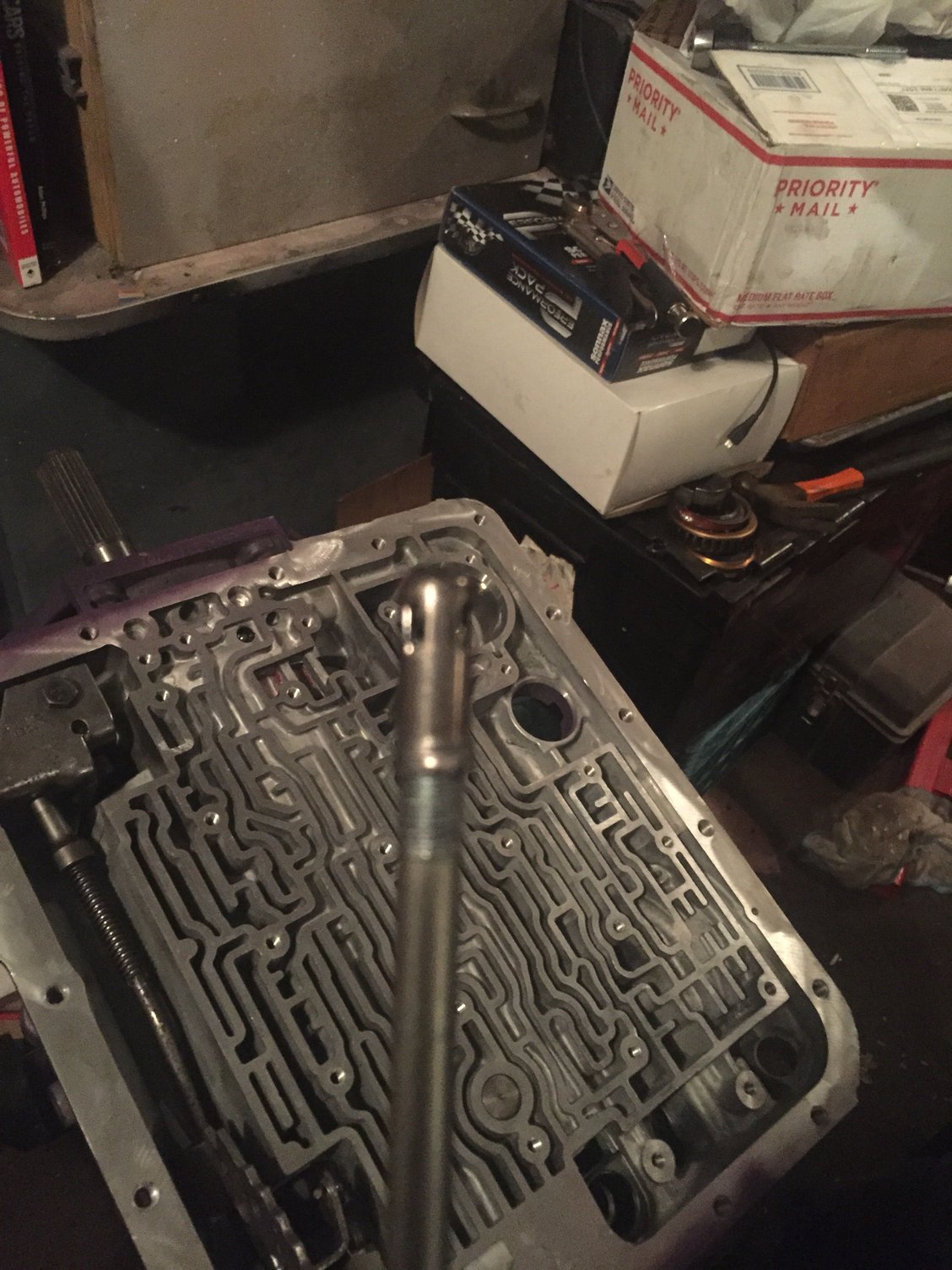

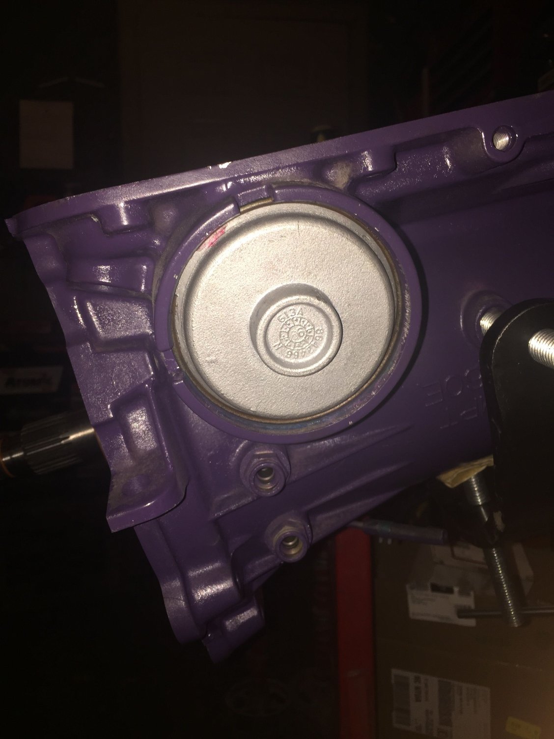

Dent puller and a 3/8 bolt i modified to cut threads.... Tapered, thats word i was looking for, been long day.... Lol
Got the bastard out....
New one in!!!

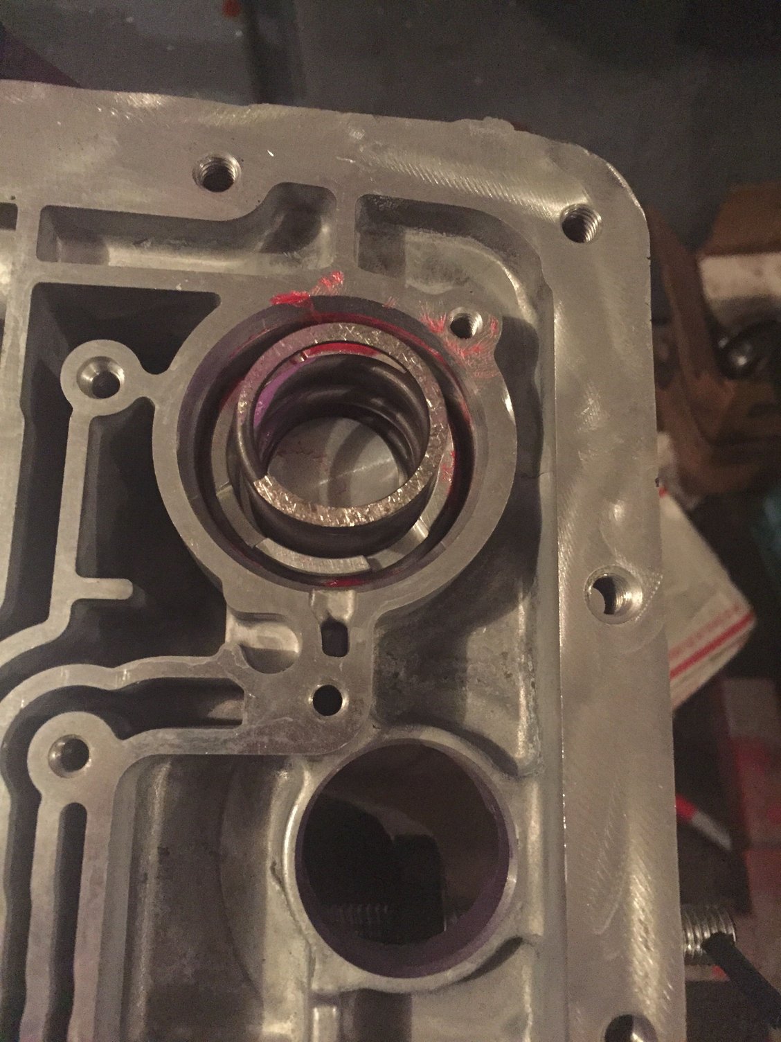

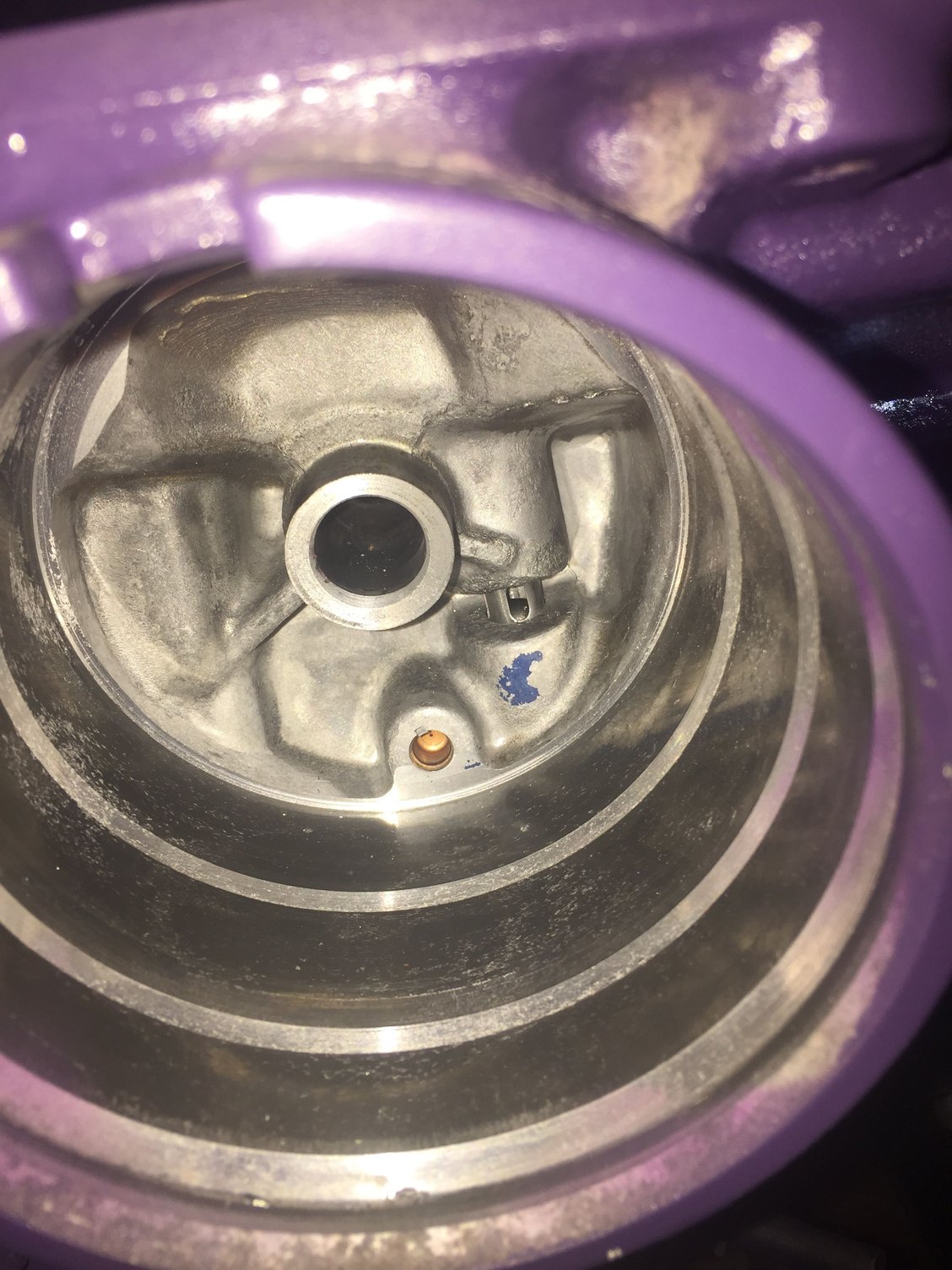

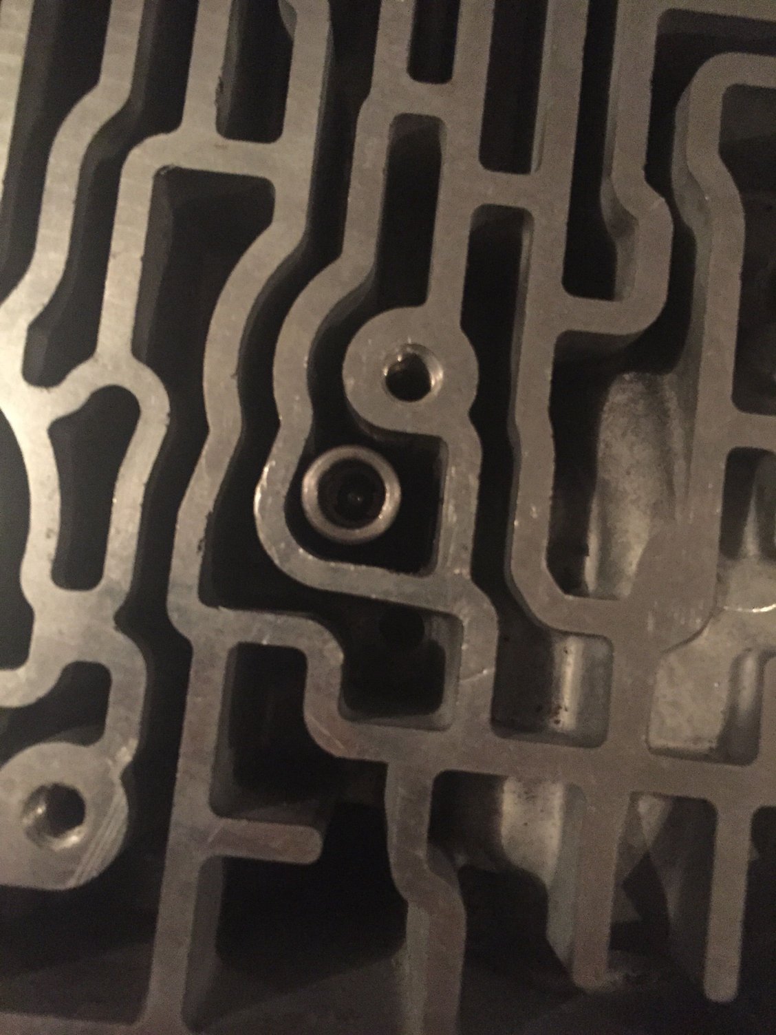

Sonnax check valve installed
3-4 accumulator in case with sonnax spring
Servo in....

Damn i just realized i missed a spot by the servo housing, damnit!!! Thats gonna bug me!!!

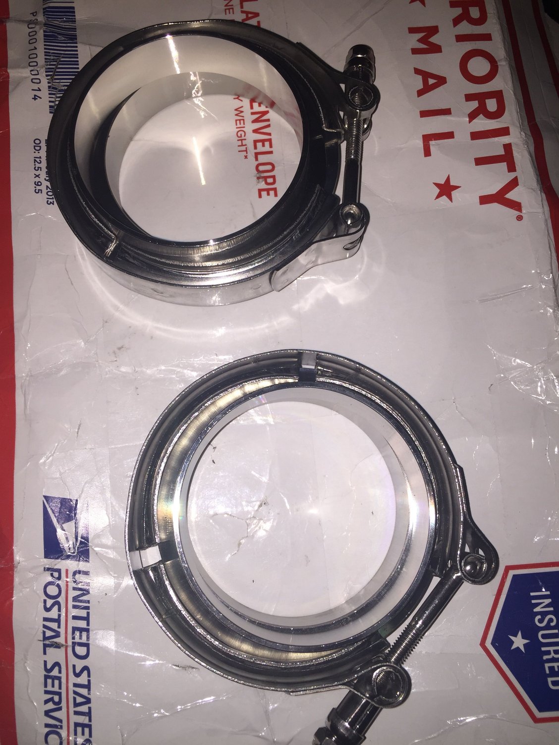

Not tranny related but my vbands cane in today..... I like getting shiny things in the mail

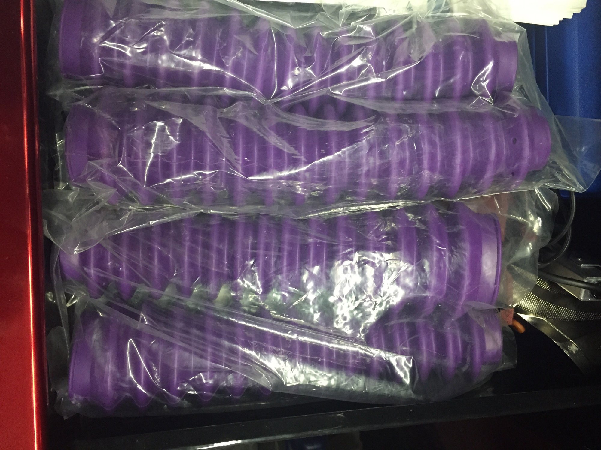

That silly purple is same paint i used on all the engine covers (valve, timing, air cleaner, etc in my 80 z28, looked really good on a black engine.... Had i found it before i started the engine swap/resto on the truck guess what color all the fender braces and other brackets that are normally black wiuld have been..... At least my trans will match my shock boots

Also, are the shiny bands for a turbo setup?
