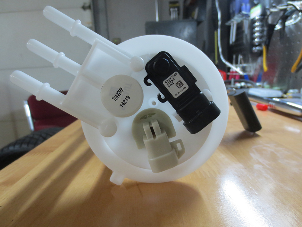

I bought the entire assembly from Racetronix part# TU432HP-2, easy swap on my 2001.

I did the same... that part number is actually a Walbro pump assembly. From what I've researched many experience fuel pickup issues with a low tank fuel level when installing just the pump in the OEM bucket. This was the main reason I went with with the drop in plus no messing around with clamps and wires.

Ahhh, I see, appreciate the responses. Contacted racetronix and apparently due to the china bug they are currently out of stock on those pumps. So may have to find alternative or continue with trying to stuff a 255 in my factory bucket.
I agree, I don't like the idea of modifying this bucket/hacking it up and then having issues with it at a low tank level. I'd rather just replace the entire module like above^^^ Unless there is an another module anyone knows of, or another drop in pump, looks like I may be kinda screwedscrewed.
