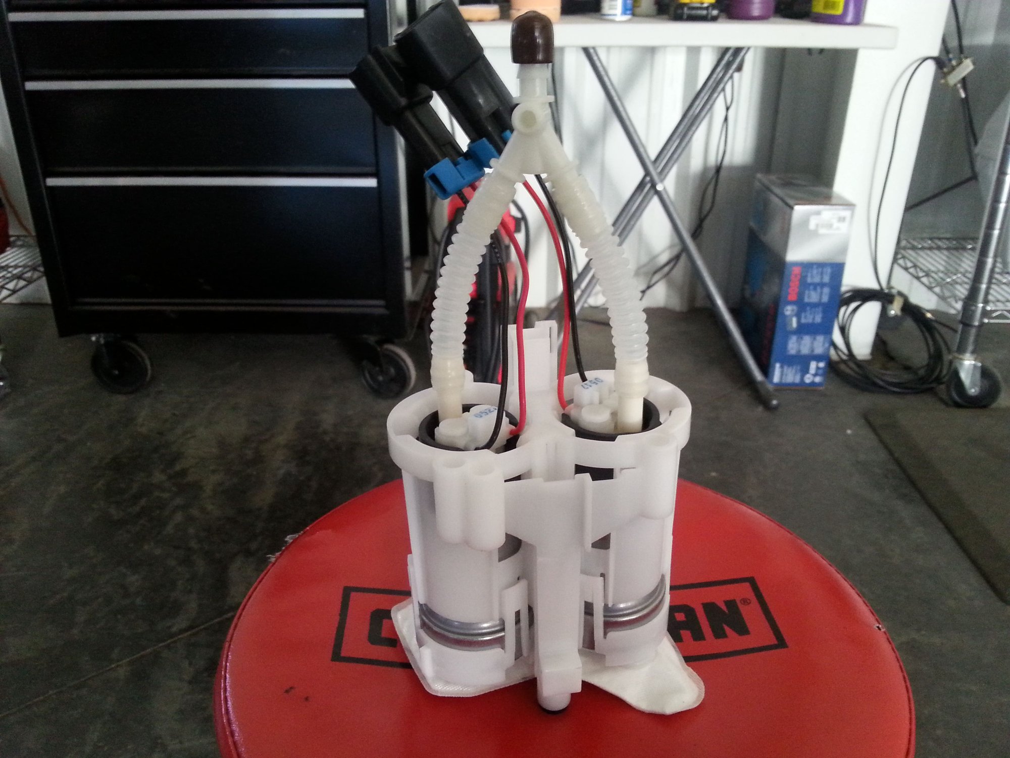

This is what im going to use for pumps.

I figured it would save me the hassle of building the Y and the pumps are already secured some. Also only a little more then the pumps themselves cost. Not sure where im going with this yet.
https://www.maperformance.com/produc...FZu3wAodRdsJ5w
