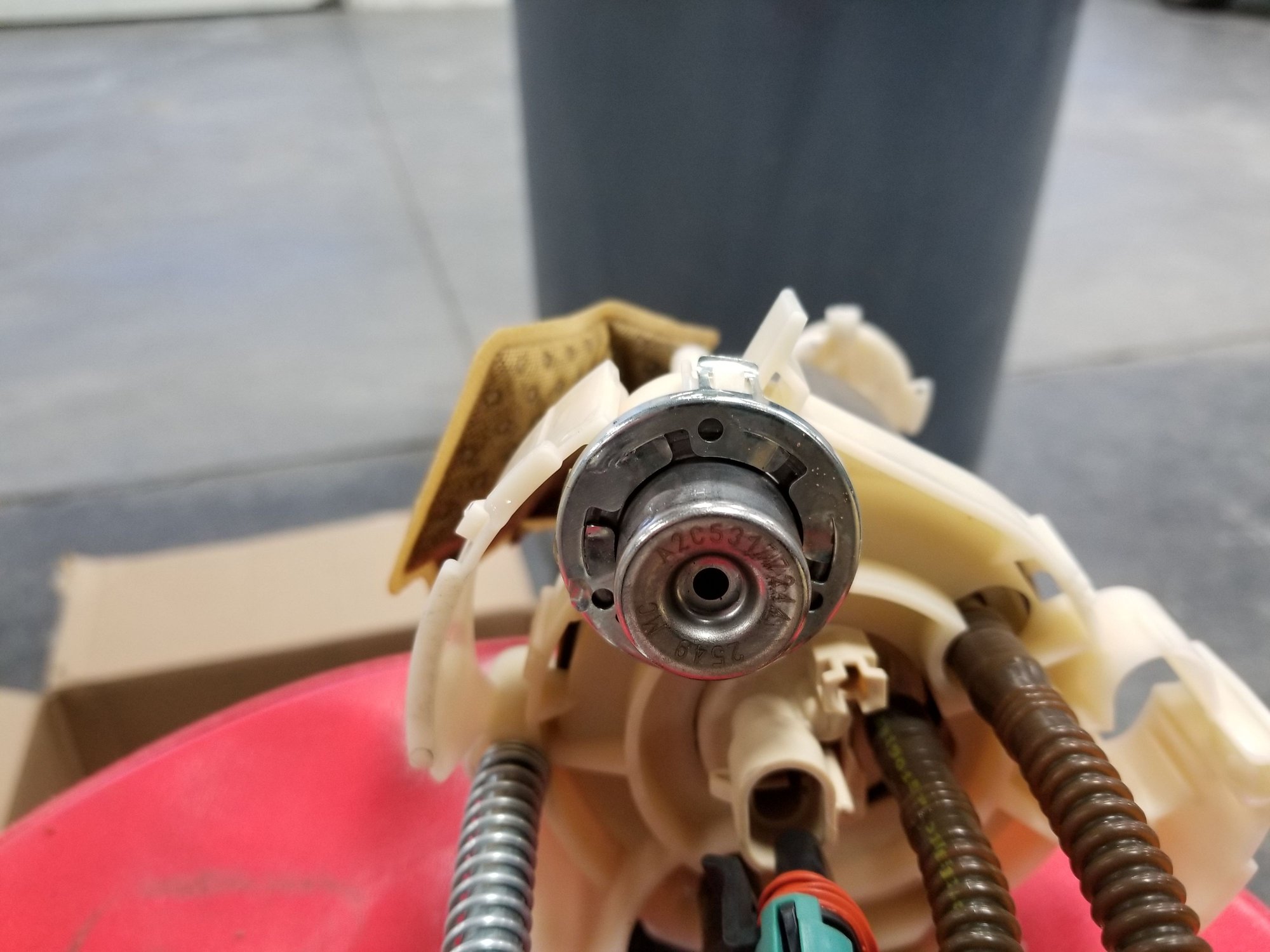

Is this the fuel pressure regulator?
If that's it do I have to plug anything or just remove it?

my guess would be to leave it alone. that will only limit the pressure filling the surge tank, your new unit along with the regulator controls the engines fp.

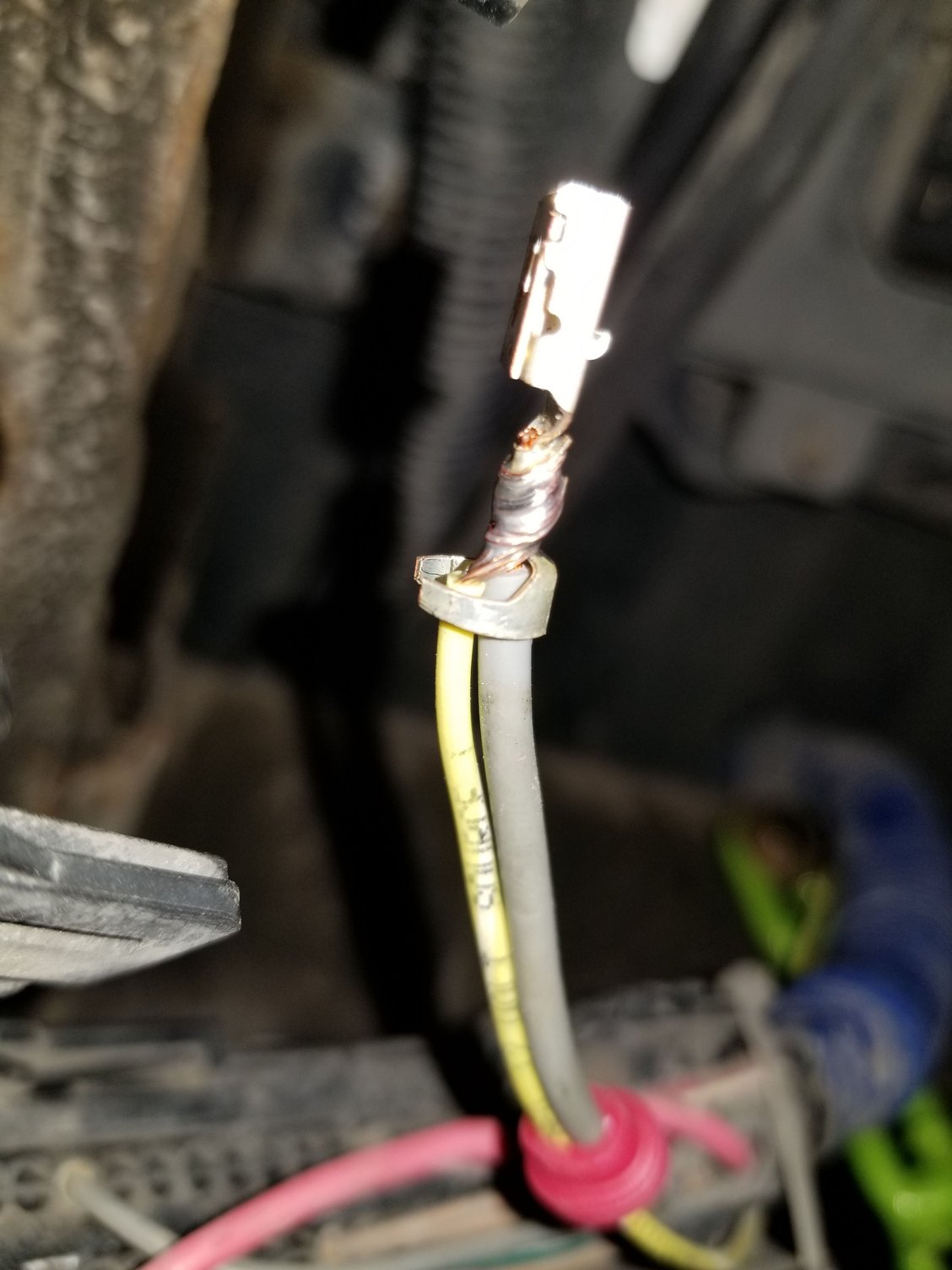

Is this correct? I connected my relay for second pump to the large grey wire (pin47) at the fpcm. Assuming my second pump will come on with the stock pump. Look correct?
