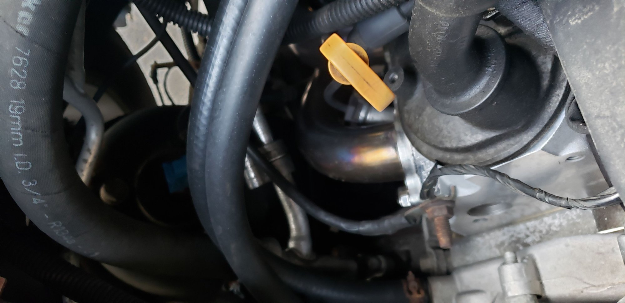

At
Here's my A/C line

Thanks for all the replies, decided to just put a 6.2 in. Keeping it simple for now. Found a 50k complete l94 shipped to my door for $3600, so I jumped on it.
