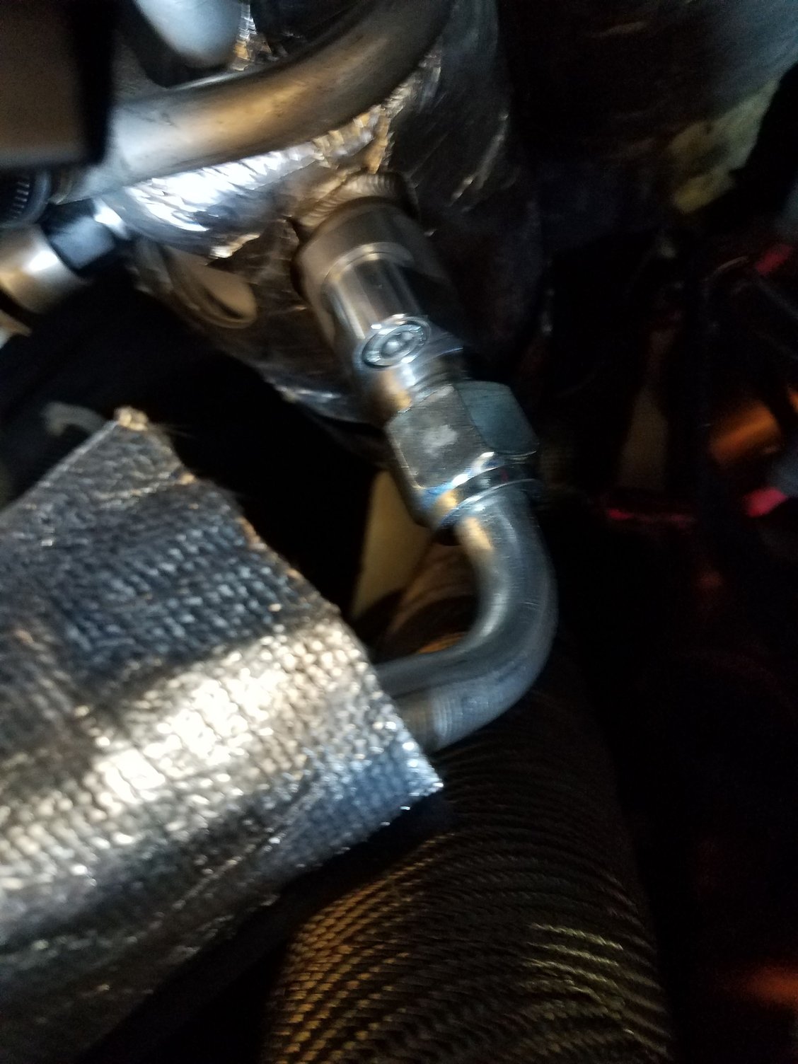

I have no idea about rear AC. Since my truck is a Silverado, I just have one low pressure line from the accumulator to the compressor. I had to update to the later 10S20F compressor (mine being a 2001 had the early HU6 compressor with the big manifold) because the Trick Turbo kit (or probably any other kit) won't work with that big HU6 manifold in the way. Anyway the line I made is wrapped in the silver heat shield and runs to the left of the turbo (see pic1). I used 10S compressor adapters I bought off eBay that go from the stock mounting blocks to AN10 threaded fittings. Then used a 90 degree AN10 to AN12 hose end (pic2), about 2.5 to 3 ft of AN12 AC rubber hose (under silver heat wrapping), and another 90 and compressor adapter on the compressor which you can't see. I'm not sure if I can post links to non-sponsors websites, but the parts were easy to find on the internet. I used the Mastercool crimp tool.
My stock low pressure line burst because it was too close the the downpipe. I've had this custom one I made for about a month now and it works great. I probably spent ~$230 including the $150 crimp tool, but it's so much better than stock and I didn't see another way. Because my truck is a 1500HD, I have a factory body lift and couldn't see how bending the line could work. The stock hose just wasn't long enough.
Pic1
Pic2 showing adapter and 90 degree hose end.
