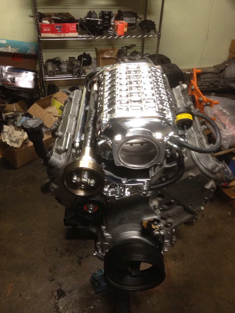

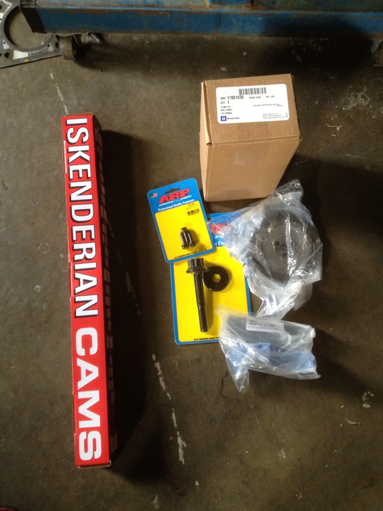

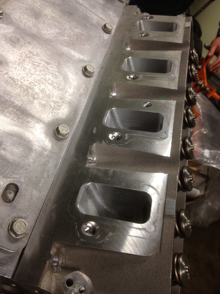

Got the long block pretty much finished up. I snapped some pics. Hopefully you guys like.
Did some mocking up to motivate myself. Also to see if I wanted to keep the polished blower or go with a black powdercoated one. What do you guys think?

I think u should send that whole assembly my way lol. B.S aside it looks killer.

Run the Polished, they look good. I went with black on mine because my truck is black and I thought it looked better, but the polished ones look badass.

Looks like fun man!! What are the specs? cam, heads, ect.
Cam is an Isky grind very mild cam. CNC L92 heads by charlie at RPM in Santa Clarita CA. Have LS3 intake and stainless exh valves, with .650 patriot springs.
Thanks yea I'm going to just keep it as is. Especially since my TBSS is white, and can't complain about the price I got it for.

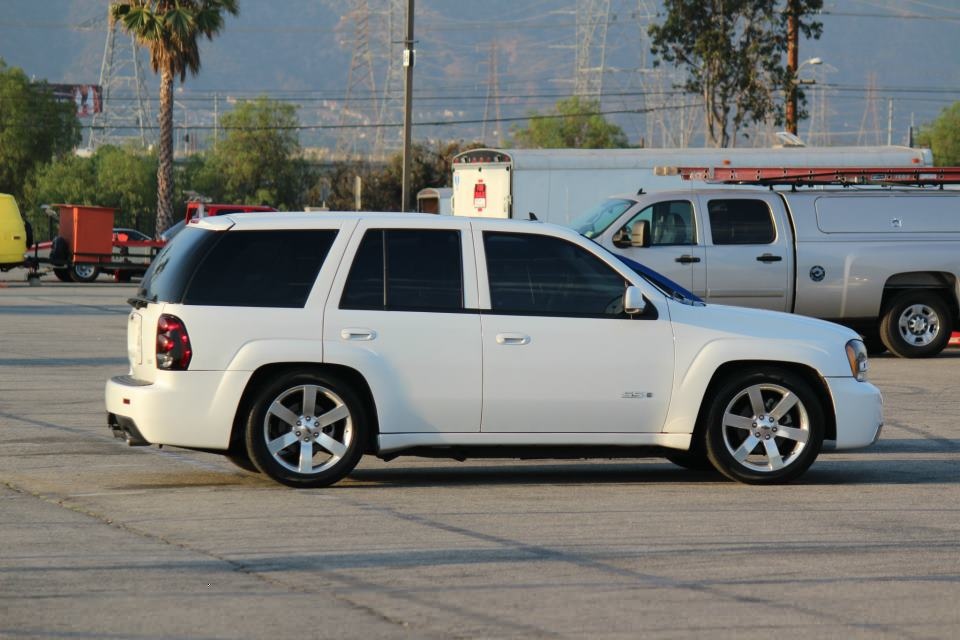

Btw here are some pics of it, also in the middle of mocking up a set of Brembo brakes

Looks good man, but some one stole yo RimZ.... Lol
Haha yea, that was me mocking up the calipers. Had to make sure that expensive test was going to work. Now I need to figure out the rotor issue(which I fixed). Should have it all together soon.
