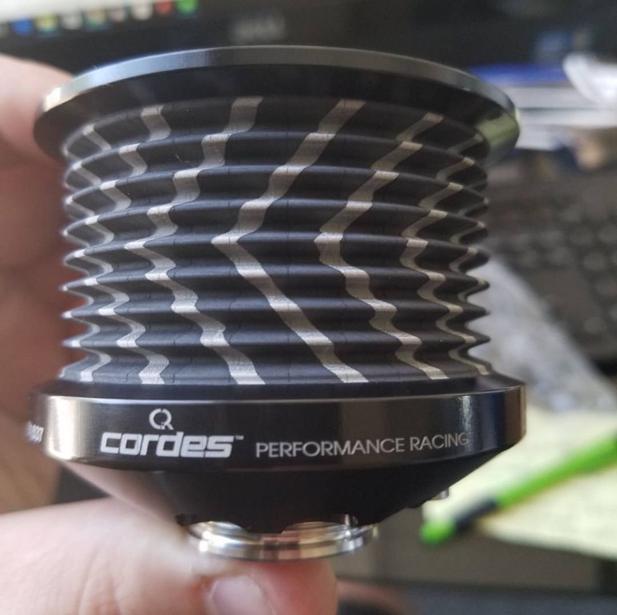

Thank you! Called procharger yesterday and they dont offer an 8rib setup for the 14+ trucks so I'm going to have to stick with a 6rib unfortunately, but they said a 3.47 pulley is gonna be the limit of the blower for me and they dont think it'll slip so I'm currently having a 3.47 griptec pulley made lol adding another meth nozzle as well and gonna max this d1 out lol. Might run out of lowside pump but we are going to do a bigger one if need be! Currently the truck makes 700rwhp/637tq in like 108 degree weather I think it was, and that was with a 3.7 pulley

So going to 4" after the y pipe will be good or should I ditch that y pipe and do something else? Hmm I need to get this stuff done soon, hoping to have it on the dyno in a month or so, they told me the pulley will take like 2 weeks. Gonna be purrty lol

4" should do the trick for now. Assuming it Y's from dual 3" directly to single 4" and doesnt neck down to a single 3" for any period.
That pulley is pretty!
