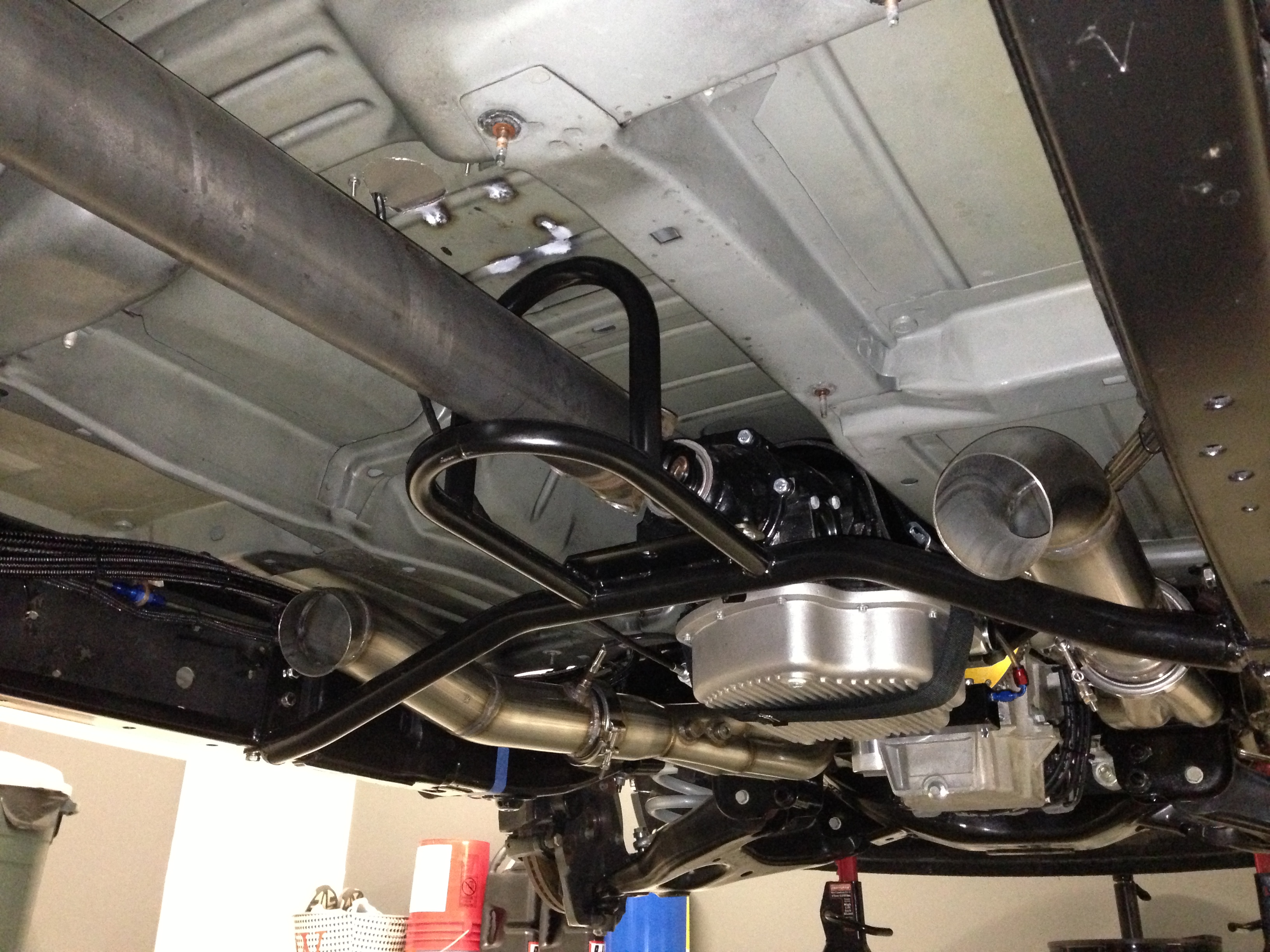

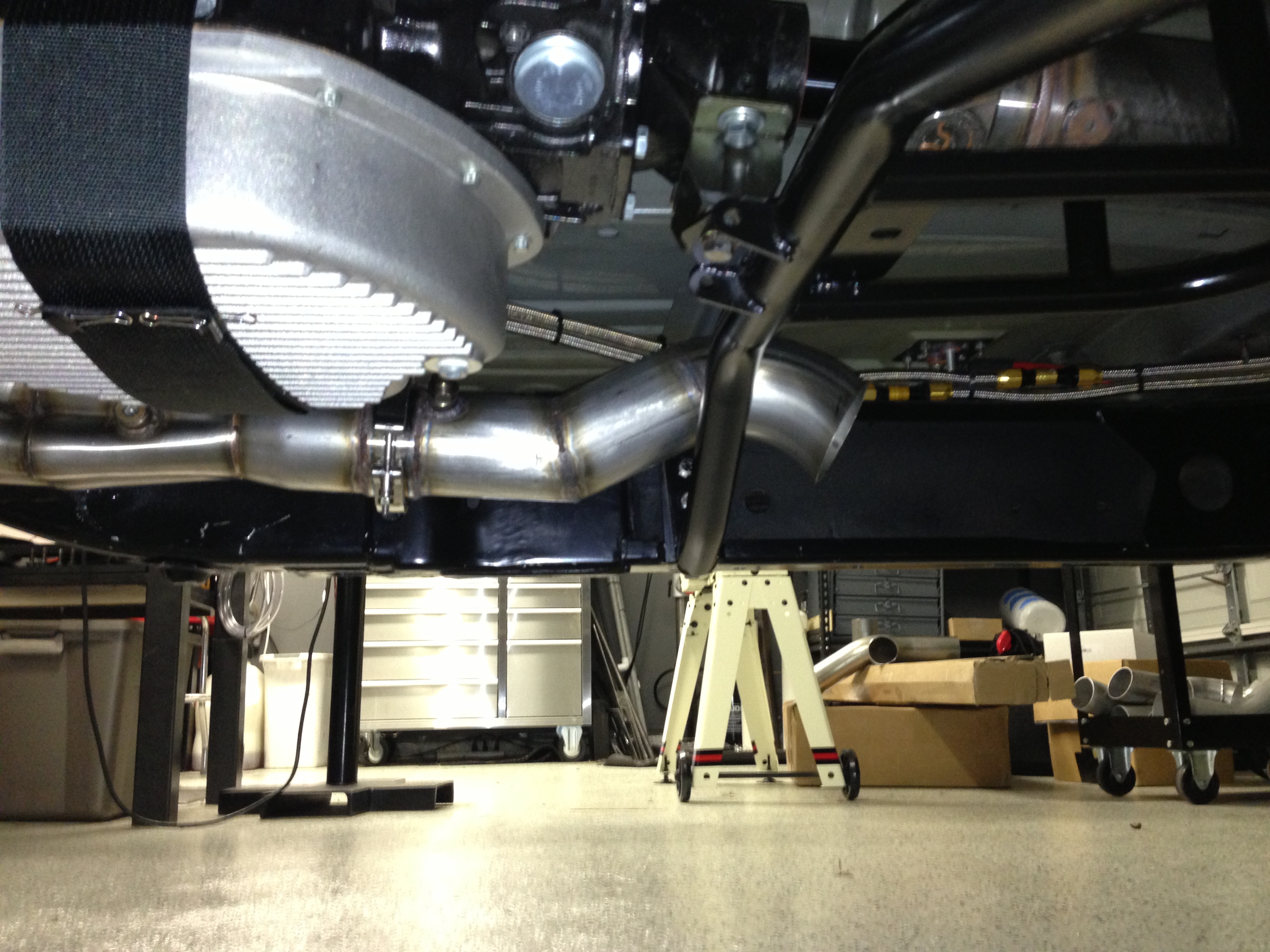

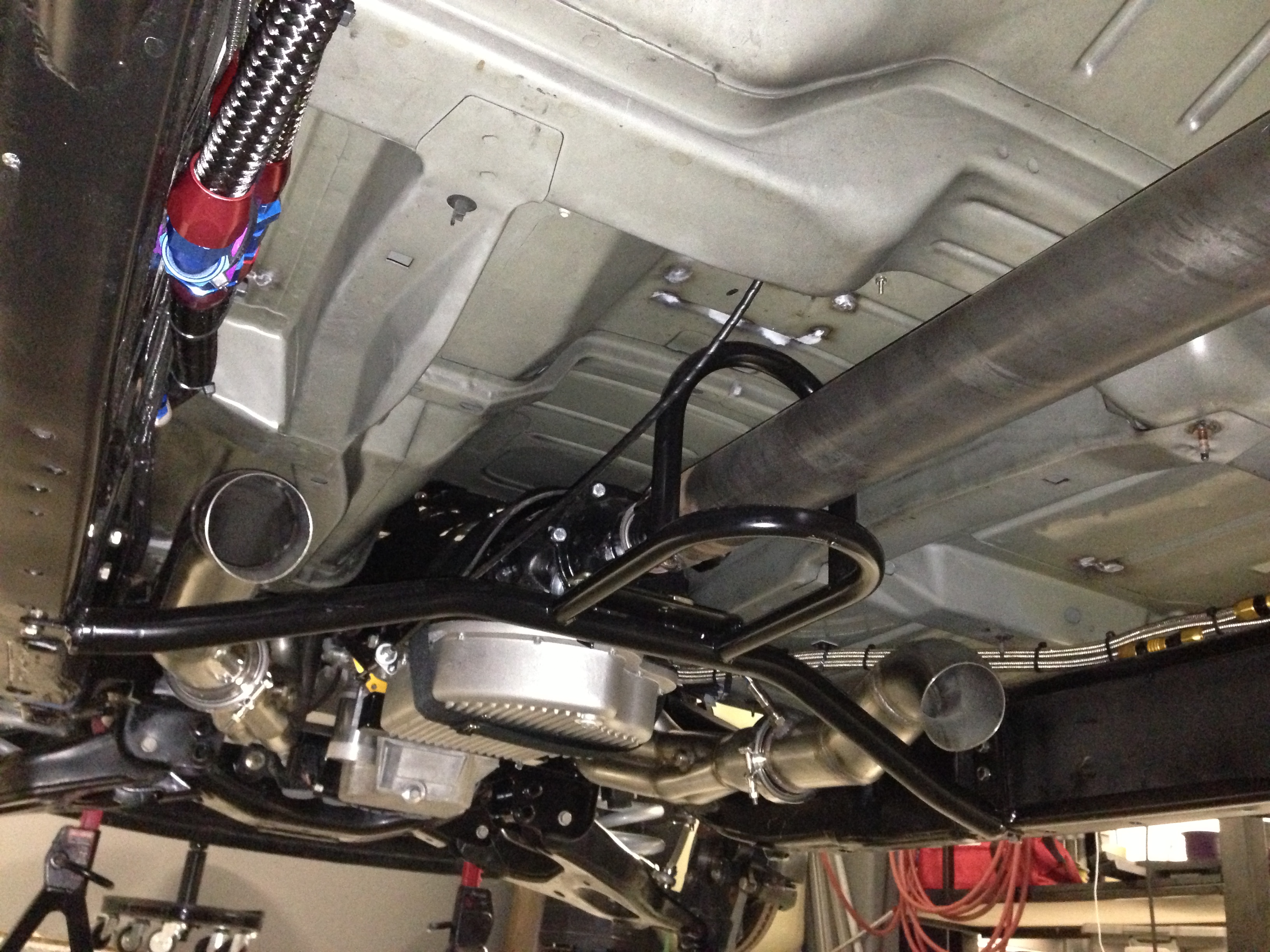

what is your exhaust setup? this weekend i'm installing some ARH 2" with 3.5 collectors and have a dual mandrel 3.5" exhaust to install behind the headers. the pypes setup has an X pipe, and i'm debating losing the X and just running 3.5" exhaust straight to my bullets with no X.
don't know if it's even worth worrying about.
I've been running a 2" Kooks with 3.5" collectors with some 3.5" stainless extensions to keep the O2's clean. Sell the X-pipe for money for something else. Scavenge tuning for blower deal is a waist of time.
My new setup will be a 2.25" primary and a 4.5" or 5" collector coming out the side of the truck somewhere.

With boost scavenging becomes a non issue under power, its relevant at low throttle and cruise but your cam valve events will determine how relevant. What are the cam specs? I am running a single 4" with a cutout, I really like the sound of it but had to run two magnaflow straight though mufflers to tame it down. (I don't want it obnoxious.
Measure your back pressure at your collector and see what you have, that will give you an idea what you are working with.
Also like Blown has in his pics, V Bands are you friend. I used them on mine and it makes stuff much easier. With a single 3" before I had 12+psi back pressure, with 4" I have none.
