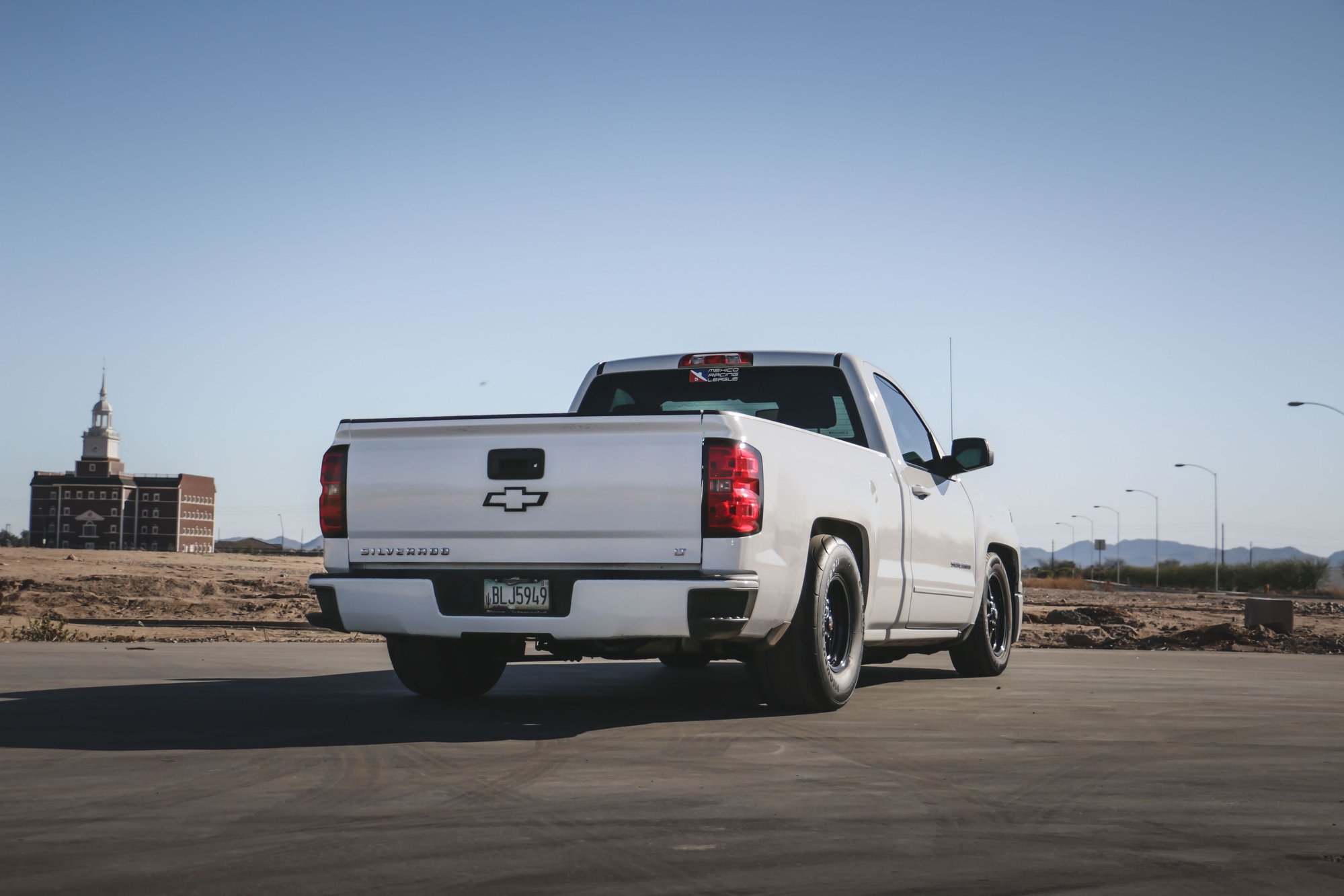

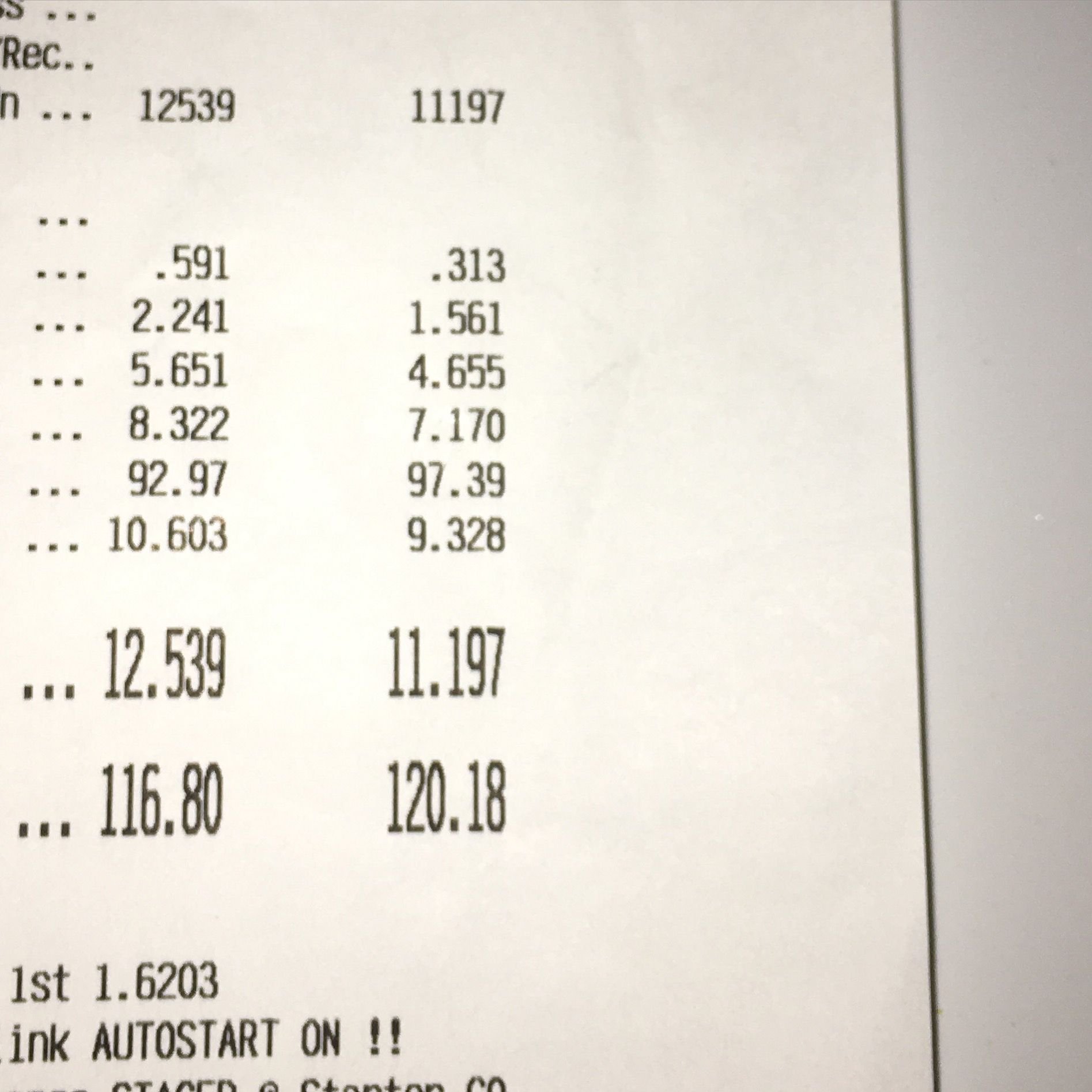

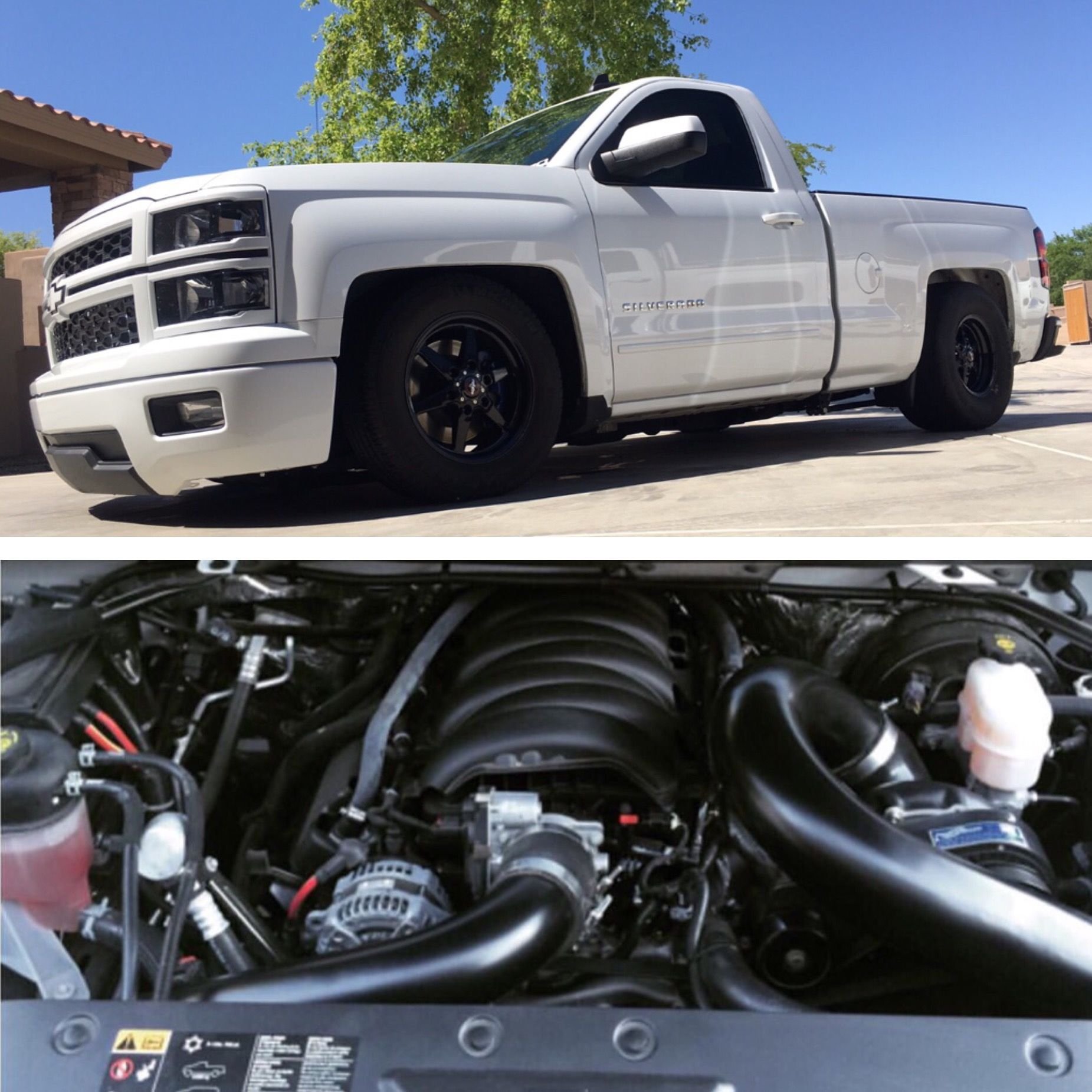

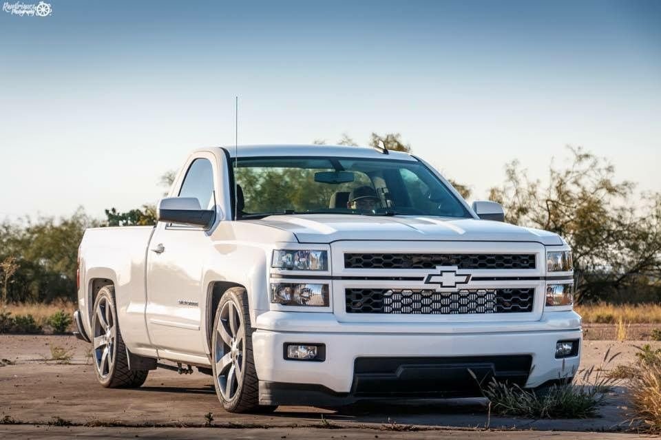

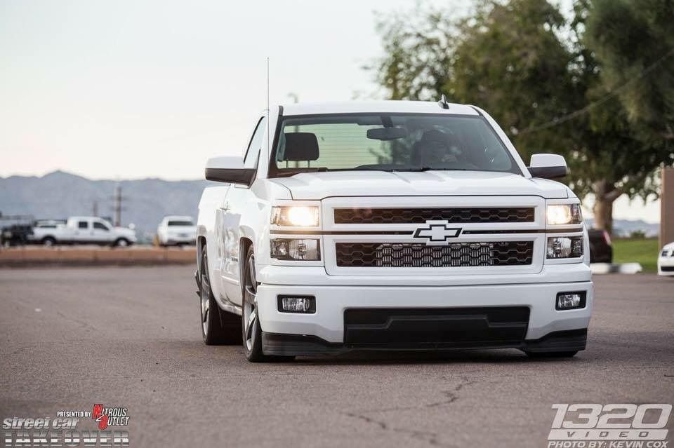

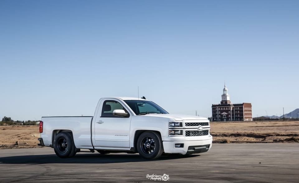

Guess I'll post mine in here just for grins since it was mentioned above!
For those that haven't seen it's a 2015 Silverado 5.3l with a D1sc that made 647/591 on 14psi. Ran it at the track the other day and went 11.19 @120 and was kicked out, race weight was 4790lbs. Also, the run was made in the shitty Arizona air lol
Mods:
D1SC with a 3.85 6 rib pulley
1 7/8 longtubes/Catless Y pipe/3" exhaust
Custom cam- 219 230 114 33% fuel lobe
Circle D 2c converter
Lt4 injectors/lt4 highpressure pump/external pump for the lowside fueling
Stock Rear/3.42 gears/stock trans
The highside pump is maxed out at the moment due to me being on e85. Doing a meth kit in a few weeks and going to pull a little weight out of the truck and hopefully click off a 10.99 at the Streetcar takeover event in Kc next month.
