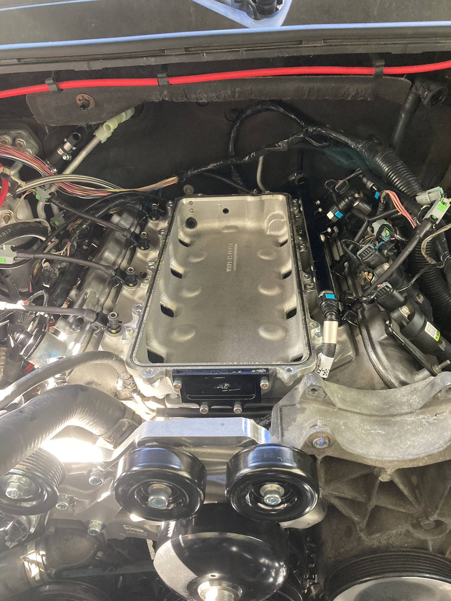

As anyone that has had the pleasure of installing a whipple on a Suburban knows, its a pain in the *** to keep the O-ring in between the upper and lower half of the intake manifold in place. i used light grease as suggested and after the second attempt I managed to wreck the O-ring. Does any one know if i can use permatex form a gasket? or do need to wait for whipple to open next week and order a new oring. Any help is appreciated.

I don't know about the oring, but if you have to use one glue it in place with a dab of 3m 5200 quick set.

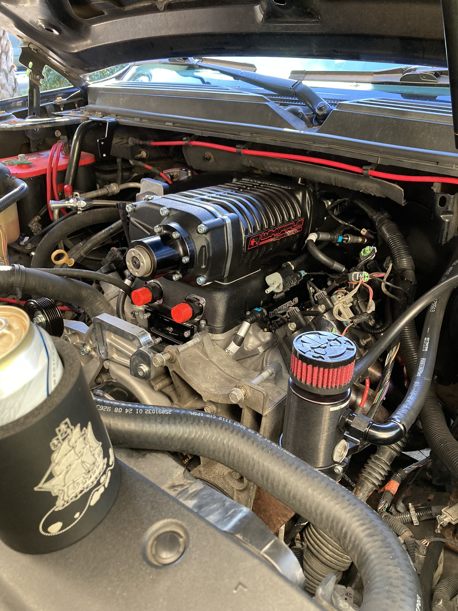

Quick wrap up on the gasket issue. I used 3m contact cement spray. worked perfect.
Old Jan 29, 2022 | 09:32 AM
baja272's Avatar
2008 Suburban LTZ 4x4.
Joined: Oct 2013
Posts: 79
Likes: 24
From: FLA/USA
