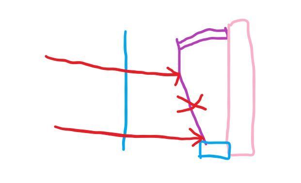

If I have to cut things up, I guess I would just cut the core support a couple inches below the hood latch and use the intercooler as the core support like everyone else. I am just scared I'm not going to be able to fit the intercooler in. So the core support diagonal bars aren't straight up and down vertical, I tried to draw a cross section to show it:
So the core support is the purple, the blue is the grill, and the peach is the AC condenser. I feel like no matter where I cut the core support out to fit the intercooler in, the bottom of the intercooler will hit the bottom of the condenser?
I am trying to use caution on this because I know if I just go in sloppylied, I am just going to get even more sloppy with it and probably just weld the whole thing on the frame haha, I guess I would at least have to put steel brackets on the intercooler though first since its aluminum.

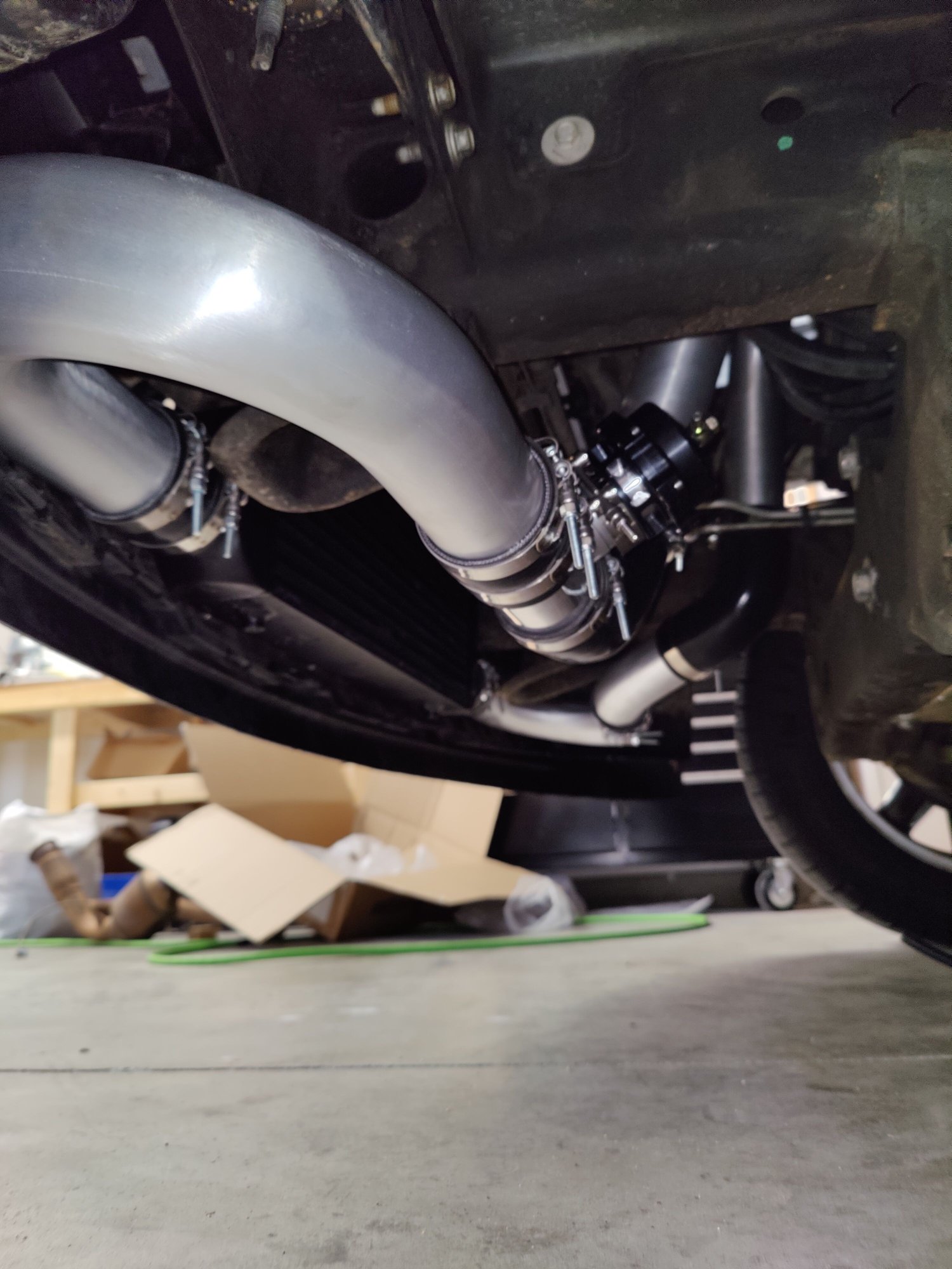

So after flipping around bolts holding the bumper onto the frame, I found a spot it fits in. And after eyeballing the holes and drilling without measuring, I somehow got it lined up perfectly:
But now I am really worried about how I am going to get the intercooler piping routed. I will have to u-turn it or either route it back under the frame, not sure if thats a good idea.
The threaded bungs that they weld onto these intercoolers, which I'm not sure if they are aluminum or steel, but they barely have any thread, and this intercooler is cantilevered off the steel bar with nothing to support it underneath unless I try to make a bracket for it on the bottom. I feel like after some miles something is going to break off, if the weld on the bung doesn't fatigue off. I didn't want to tighten down on the screws threaded into the bung too much because the threads are so short.

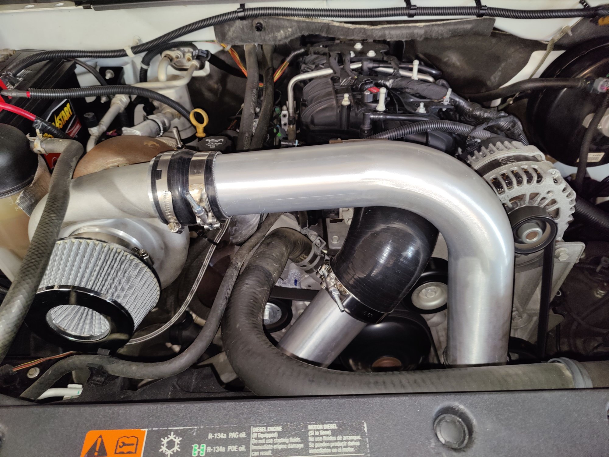

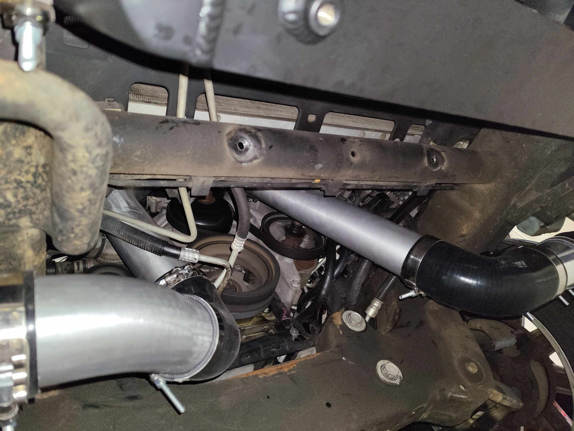

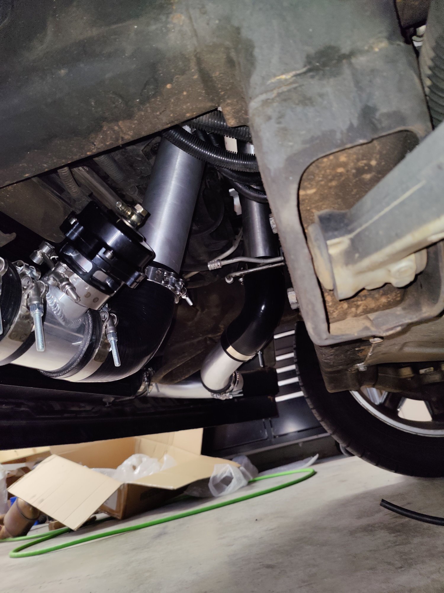

So I am probably going to get bashed hard for this "shi**ty" intercooler routing and setup, but I honestly didnt' know what else I could do. The difficult part was how the turbo was offset, the throttle body needs and extension outward for clearance from the alternator and belt, and my intercooler is mounted down below the frame, so all this added up to make the routing difficult. I spent the whole day trying different combinations of tube and coupling configurations and couldn't get anything to work. So I had to do some cutting on some of them, so that means on some of them I don't have the flange/lip thing on the end so I hope it stays together. I ended up just connecting it together with my last coupling:
As you can see I have less than like a inch of clearance between the intercooler tube and the belt and pulley haha.
I think I need some couplings with like very slight 15 degree angles, but the only ones I can find are either 90 or 45.
