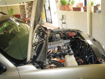

heres a couple tips for ya bro it will help with the install 1) open up the the hood and remove the bolt from hood support and put it in the other hole see pic.. 2) unbolt fan remove and then youll have space to put your feet.

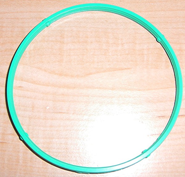

The groove for the seal can be machined into the flange as on the LS2 intake.
Attached Thumbnails Radix J Tube... 5 bolts or 6??-ls2-intake.jpg   Radix J Tube... 5 bolts or 6??-throttle-body1.jpg
