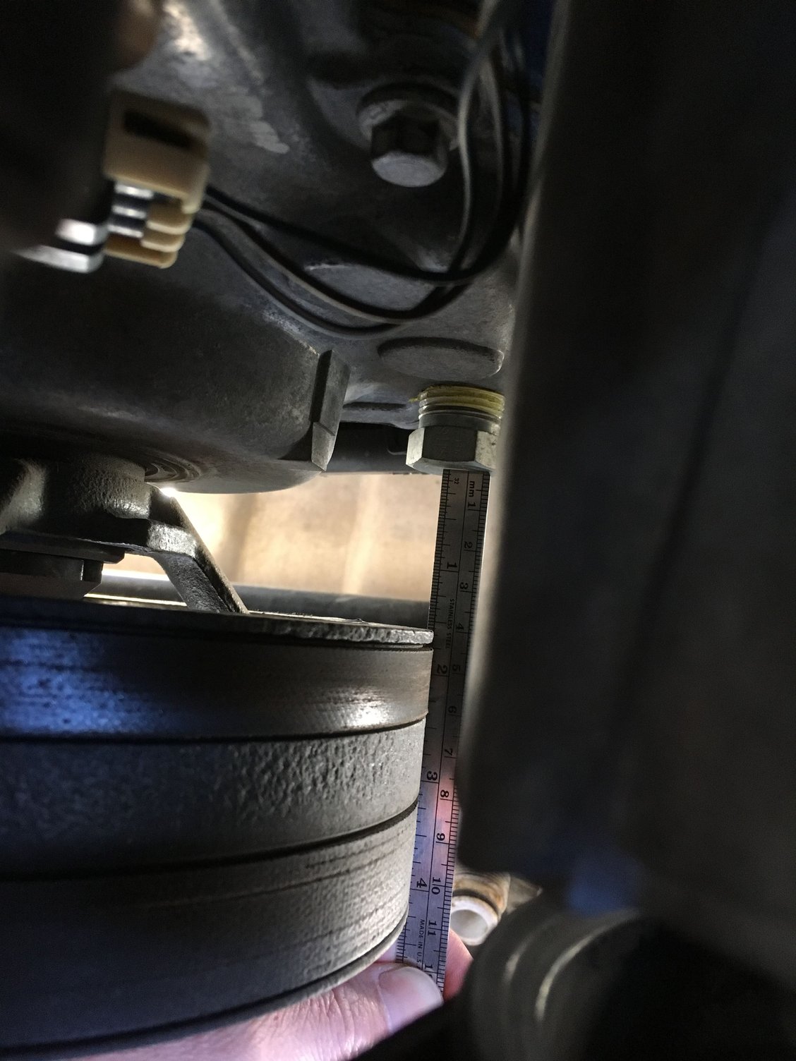

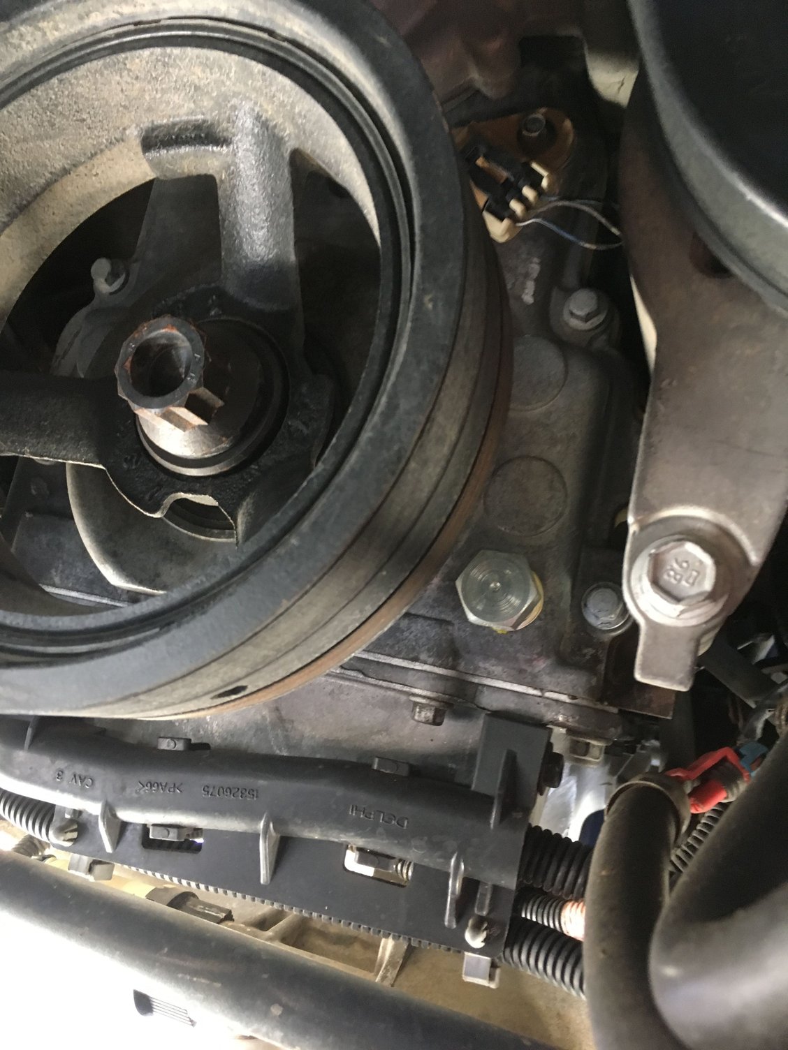

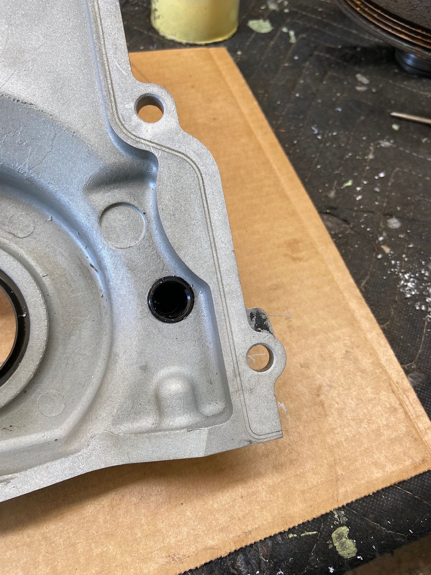

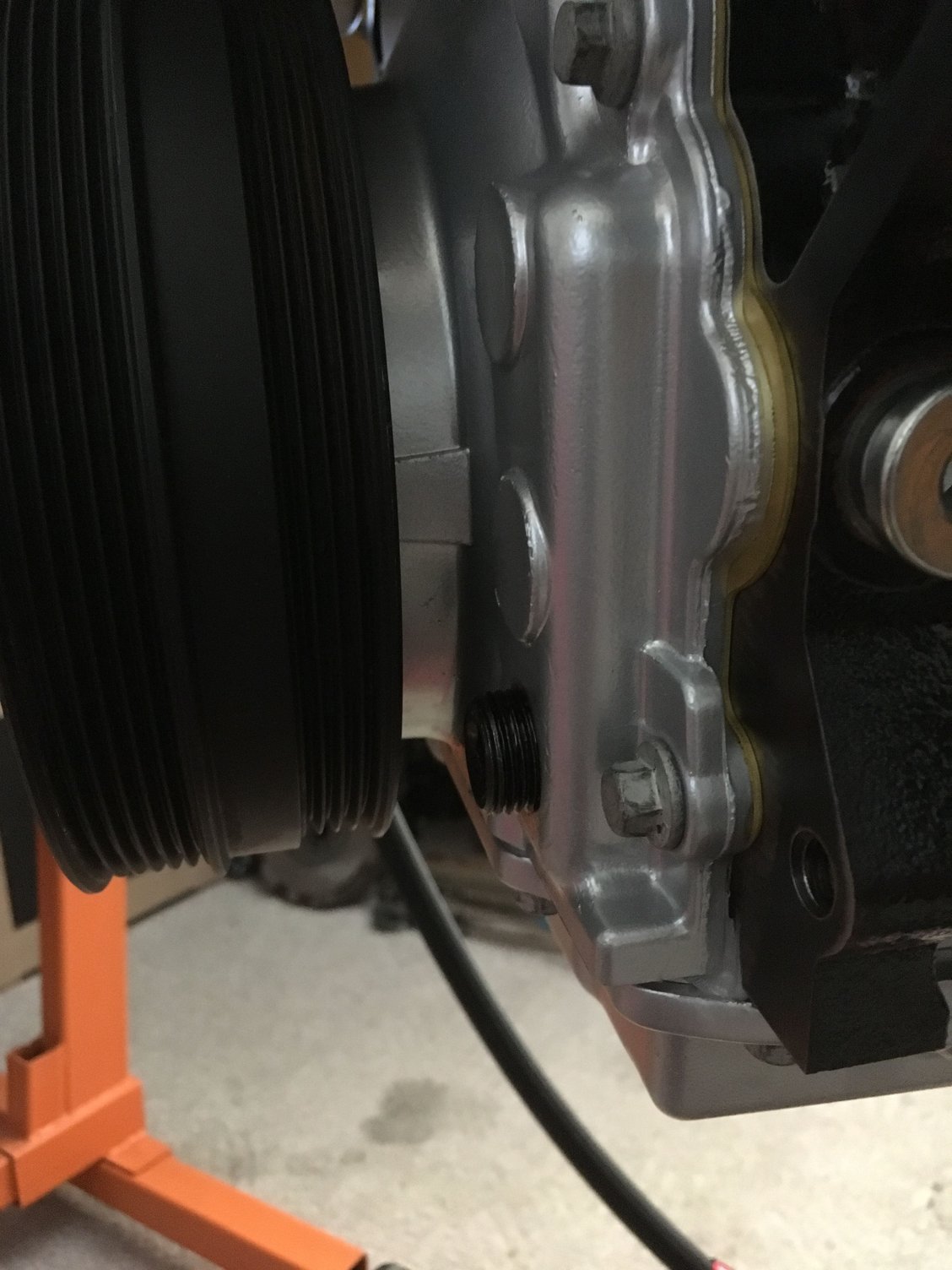

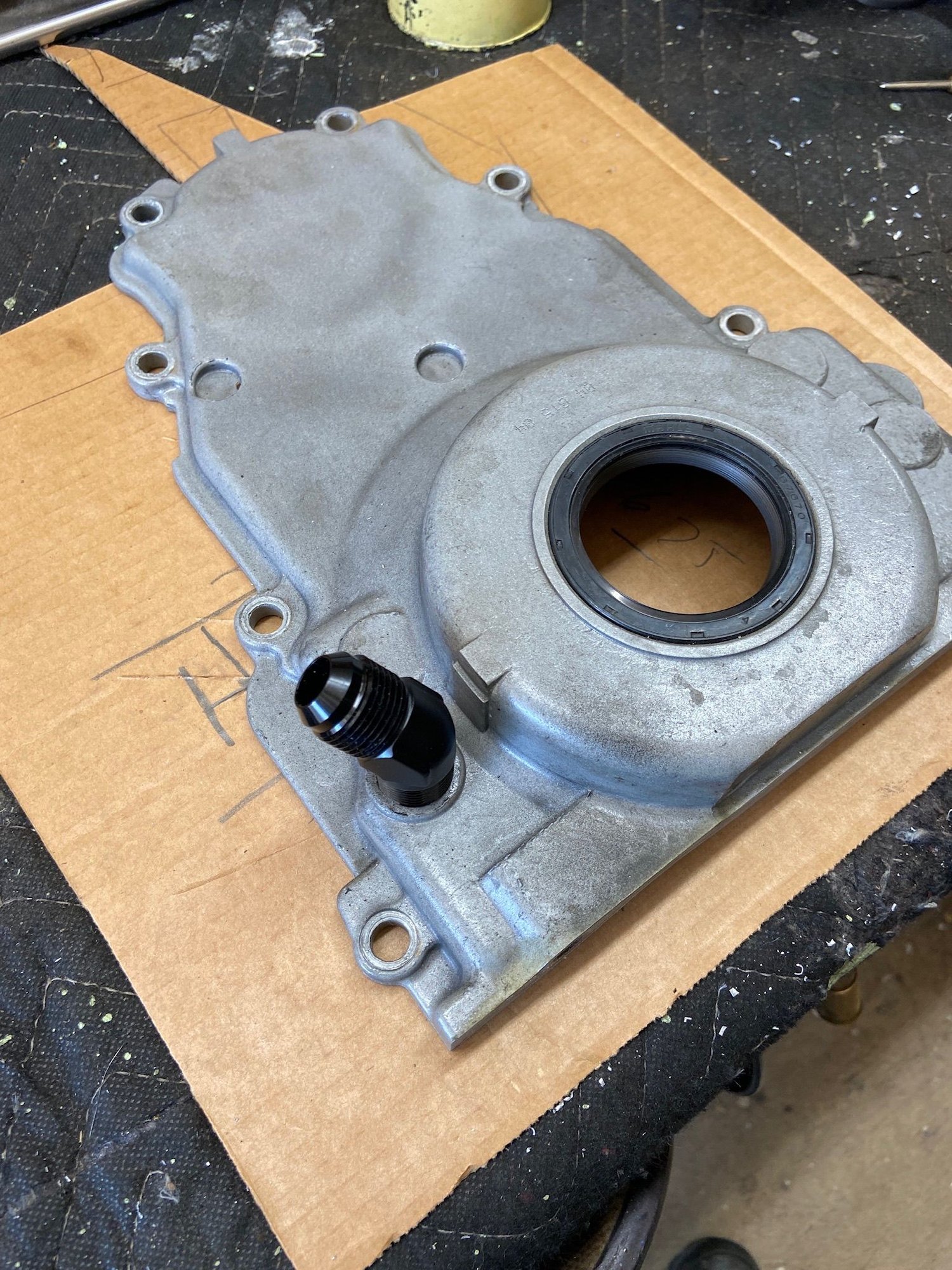

Pics of the drains I installed when I either built a motor or swapped covers. Futureproofing my builds. Both covers are 1/2NPT and currently plugged. Drilled as low and as right as possible in the cover
1st pics with Corvette spacing, 2nd pics with truck spacing

Just understand that fitting is exactly over oil pump mounting bolt. If fitting stick out from inside cover it will be over bolt head which WILL stop oil from enter pan... just keep fitting flush On inside of cover. I had to cut off 3/8” from fitting plus I grinded insid eof fitting like funnel for better oil flow ... that 10an 1/2 npt 45*
