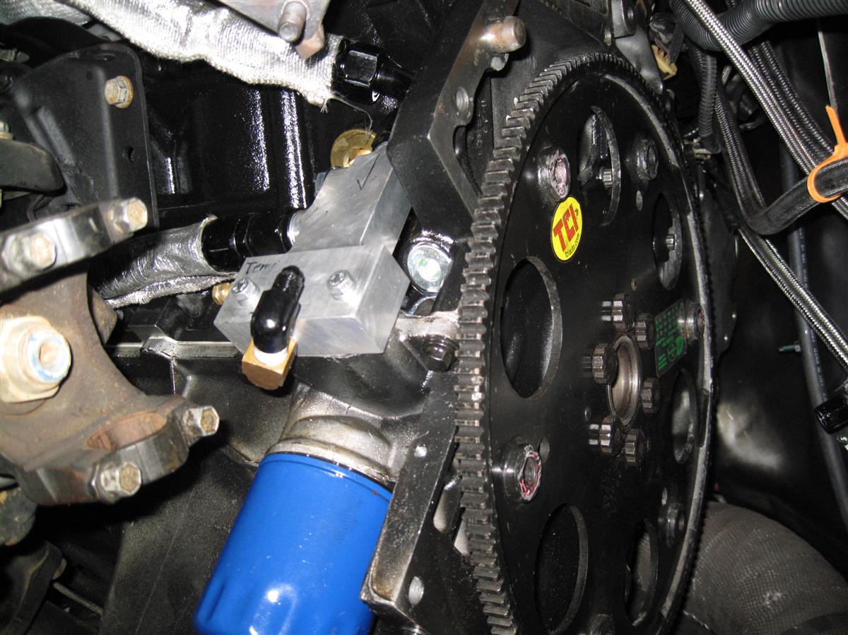

Here is mine...
Old Mar 7, 2012 | 09:27 PM

Originally Posted by kbracing96
Here is mine...
Thanks kyle!
I guess I will be doing that tomorrow.
Here is mine...
Thats where mine is under the started. I tapped the oil cooler block. But trick performance offers a nice bolt on piece that goes im between the engine block and cooler lines. I would just buy it.

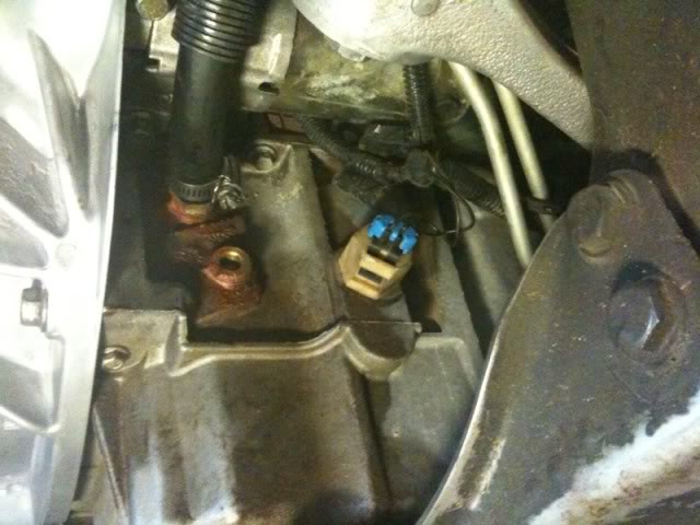

I'm not sure how the oil cooler guys do their feed lines but trick's piece looks simple and I wouldn't worry about it leaking oil. Here is where I ran my drain line.

Heres mine for my custom oil cooler and temp sensor
