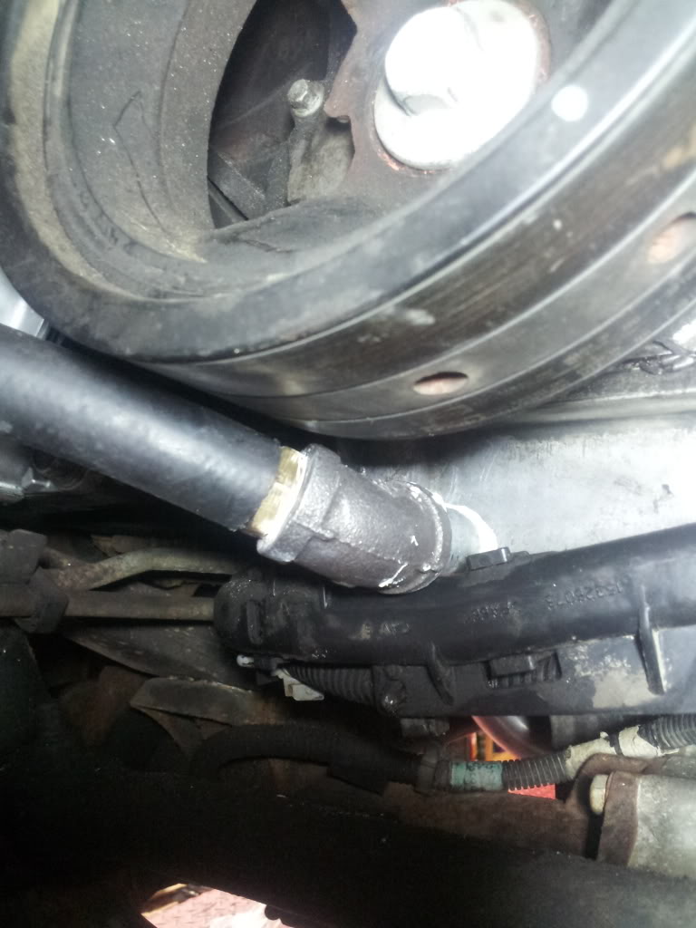

I tapped my oil pan with it all bolted up on my 4x4 truck but I did it on the front. So if any shavings get in there you can get some grease on your finger and get them out cause the bottom of the pan is right there. I was also able to hold a vacuum right next to the bit and that sucked up most of them.

Ill spend 8hrs doing it right before ever tapping a pan on the vehicle

I tapped mine with the pan on 8 years ago and no issues. I would also use Trick's oil adapter. Its the best one out there!

Tapped mine with it still on the motor. Just use grease and go slow the drill bit will pull the shavings out naturally. I also used tricks oil adaptor and I'm awd for the record and it worked good.
