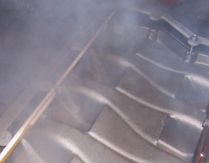

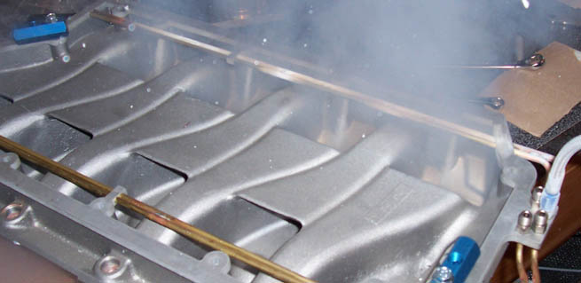

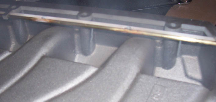

Ok can not tell a whole lot here, but the nitrous is aimed at the opening on the port. And when running will be sucked or FORCED down the runner. The reason it is not aimed down the runner is to TRY and slow the nitrous down to give it time to expand and cool things down.
Got alittle freezer burns when a couple of pieces of dry ice attacked me.
Things left to do, get a gasket cut,and on a vehicle for some testing.
!!! now for water meth the discharge holes would be aim towards the outer wall. against flow. This will slam the mix into a water busting it up and again given just a moment more time to cool things down.
edit: you can see in one of the pics the plate is lefting off the intake. So I had to use some spacers to hold it down.
Ricky
