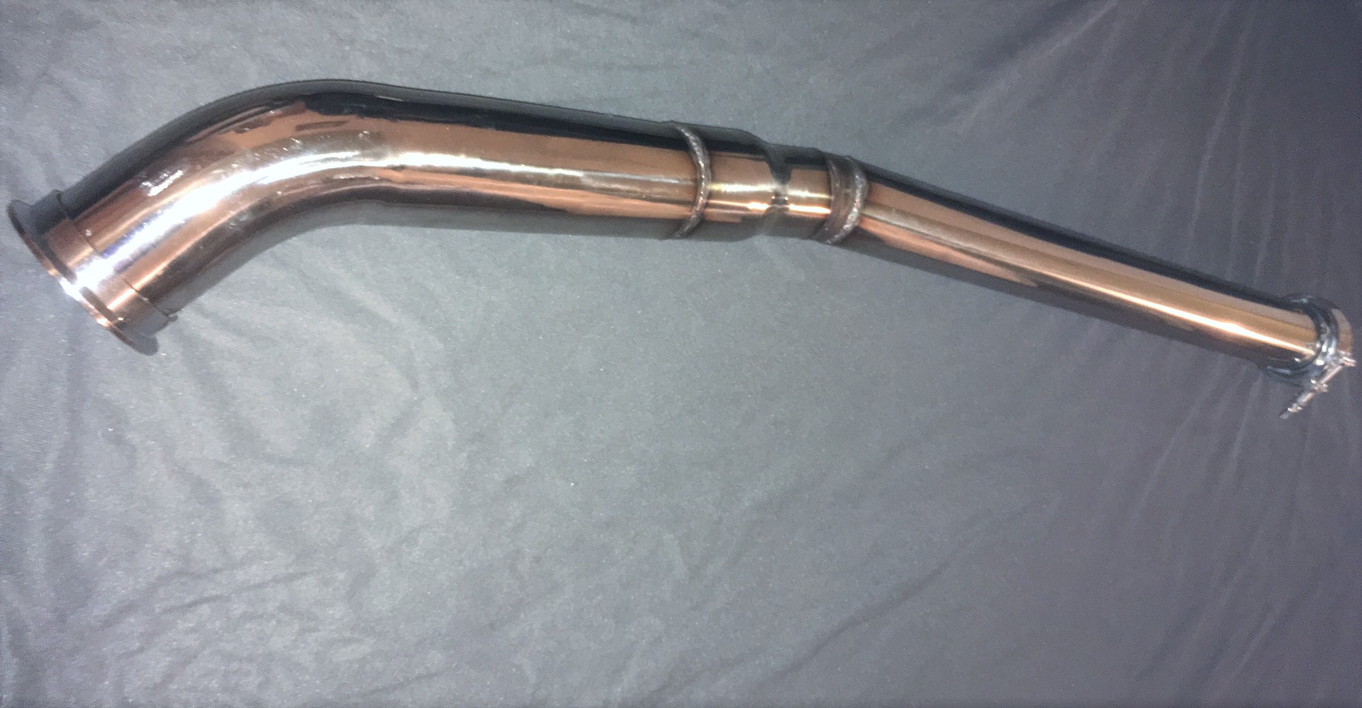

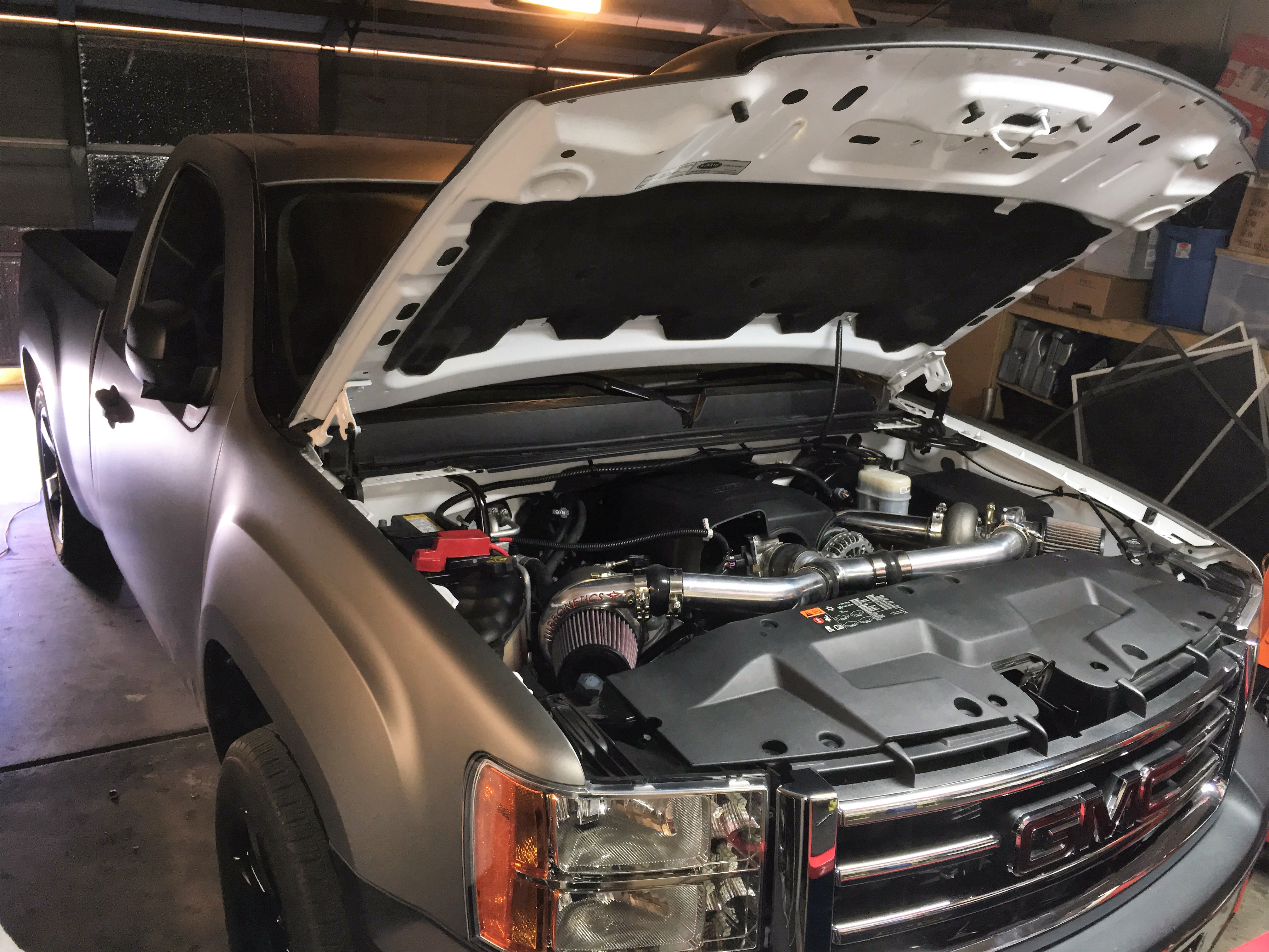

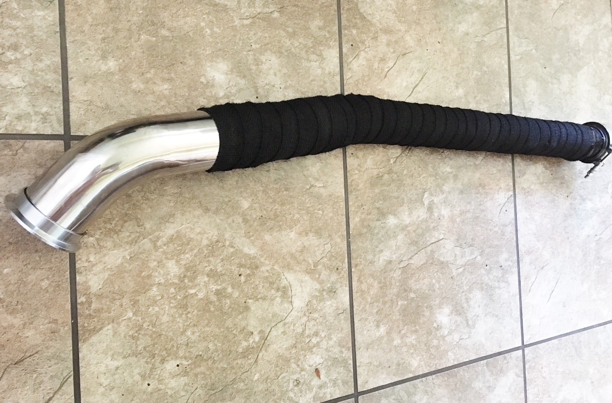

I like to street tune for a week and then see how she does on the dyno. I had good luck using Zippy's dyno in Las Vegas. Finishing the passenger side down pipe.

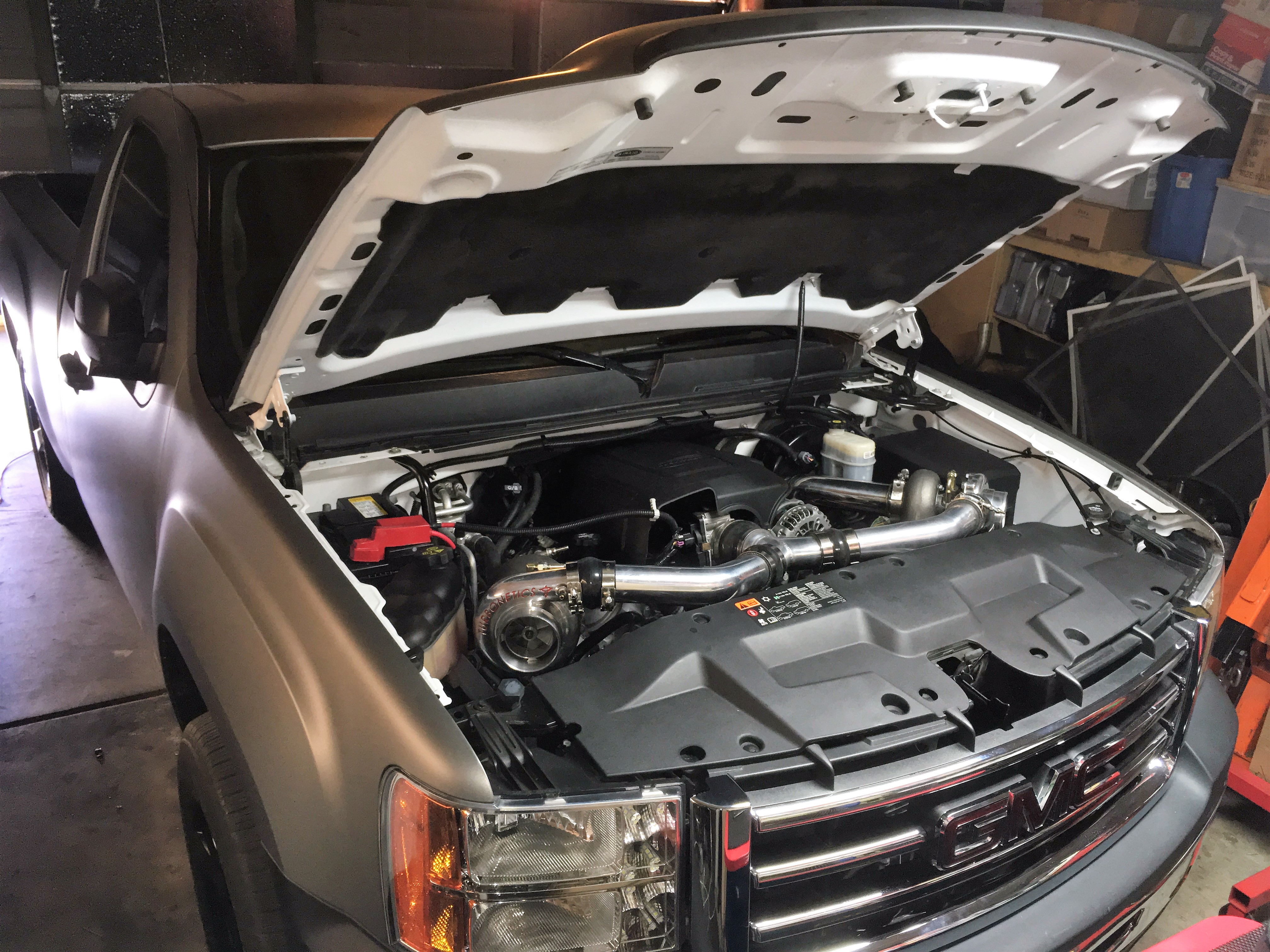

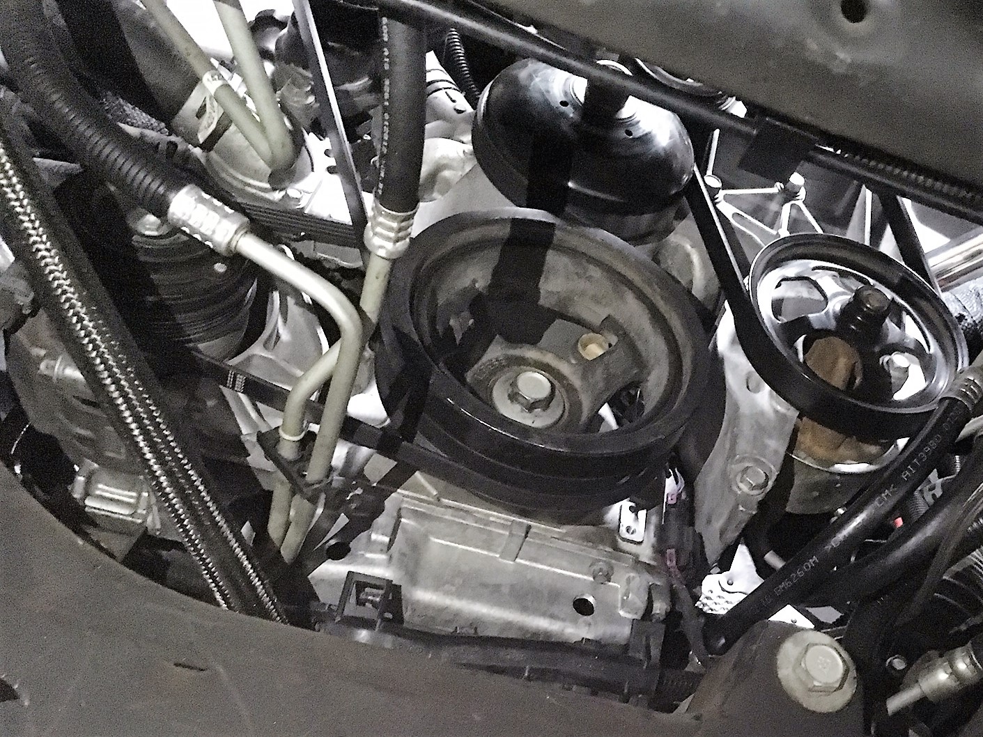

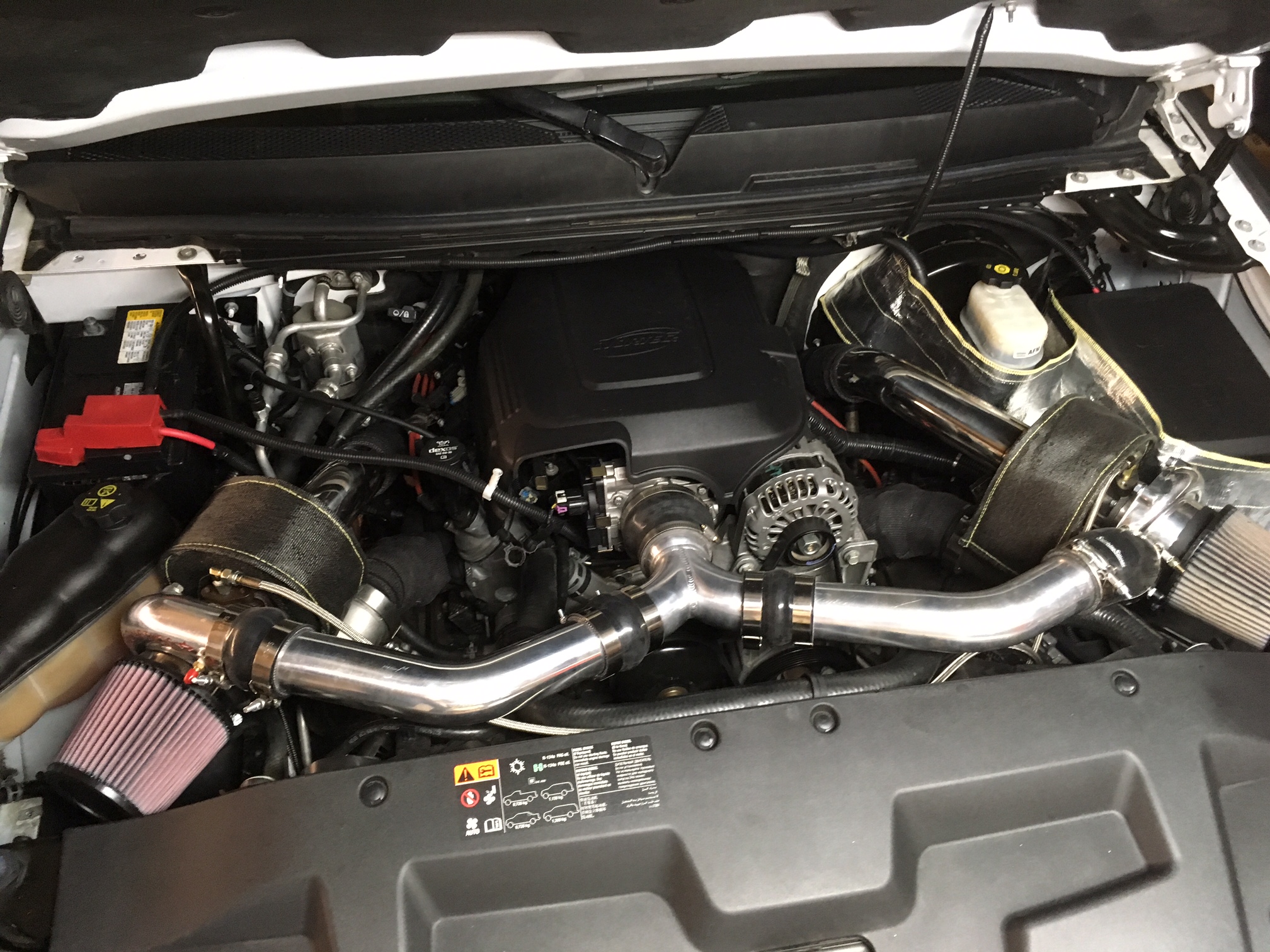

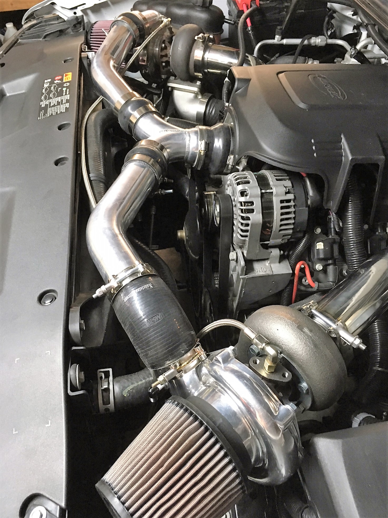

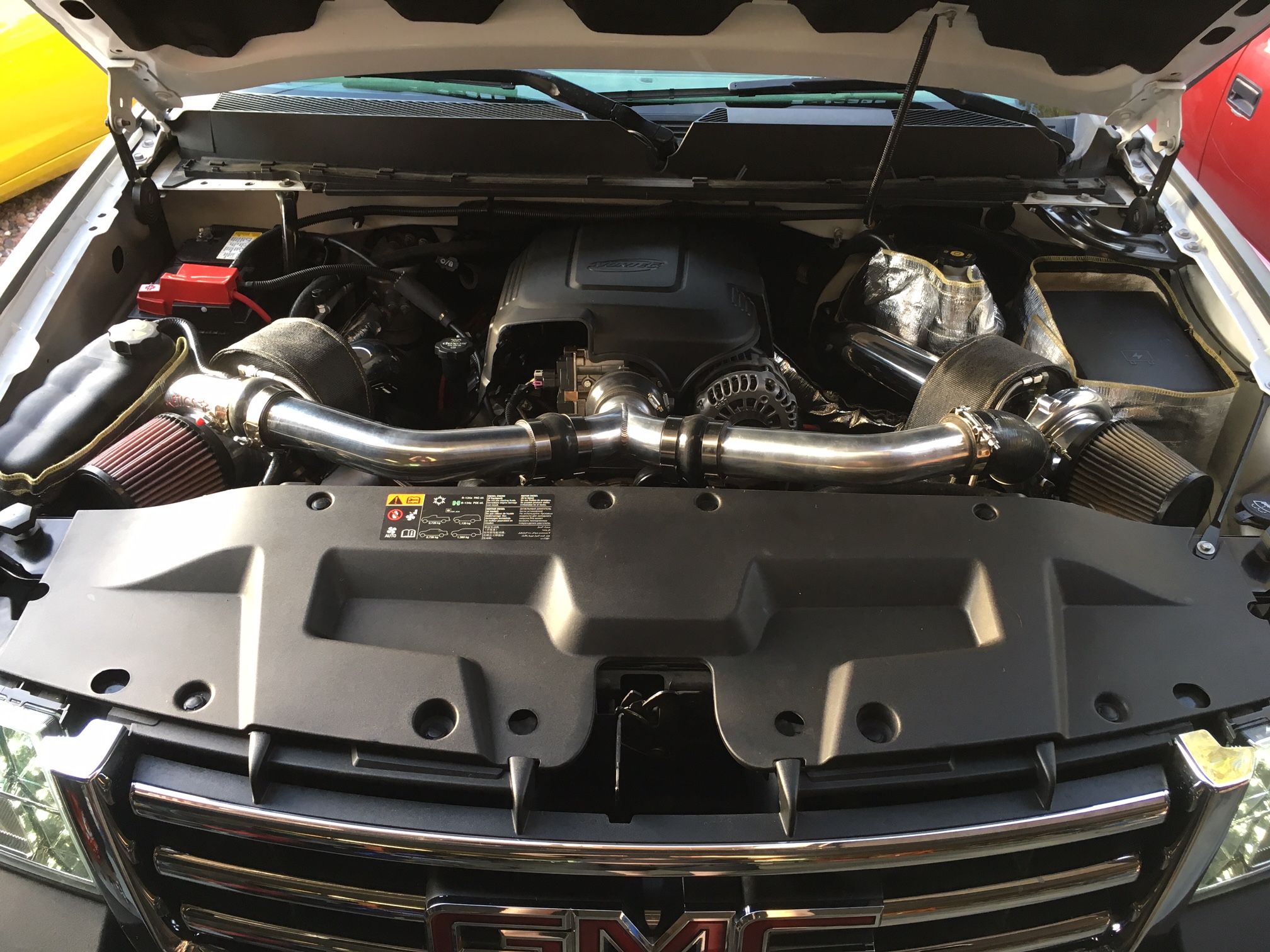

Default First fire on TT 5.3L

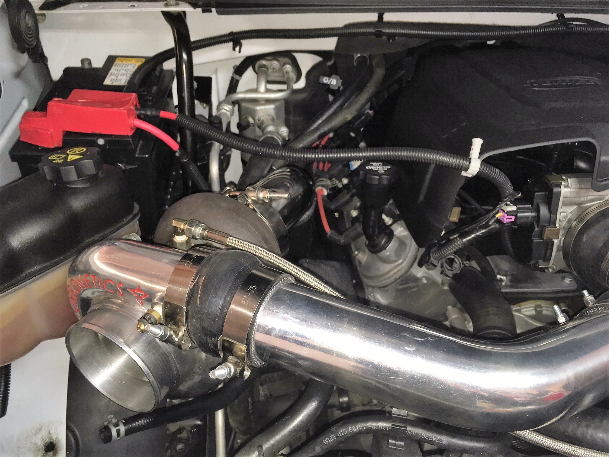

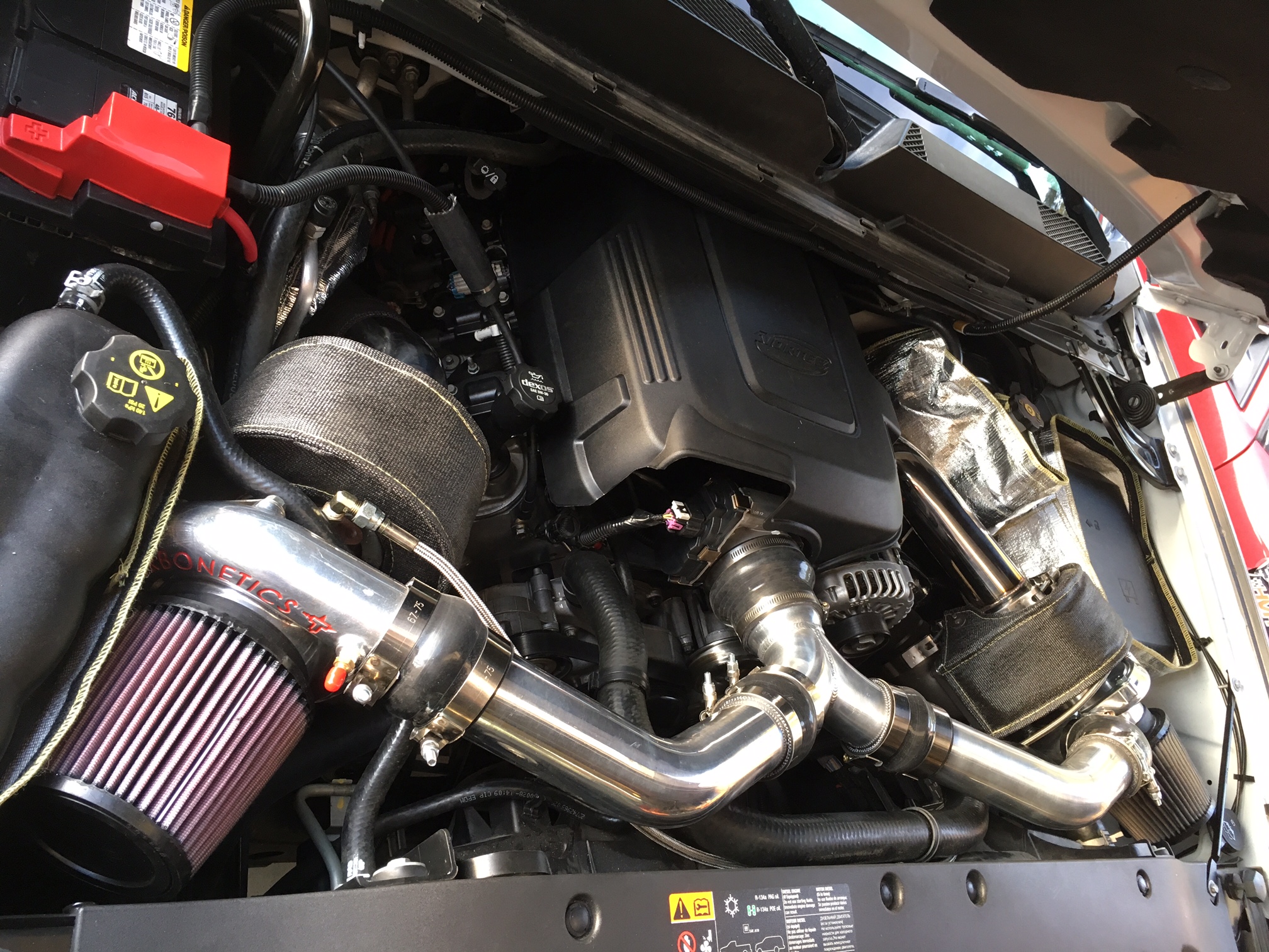

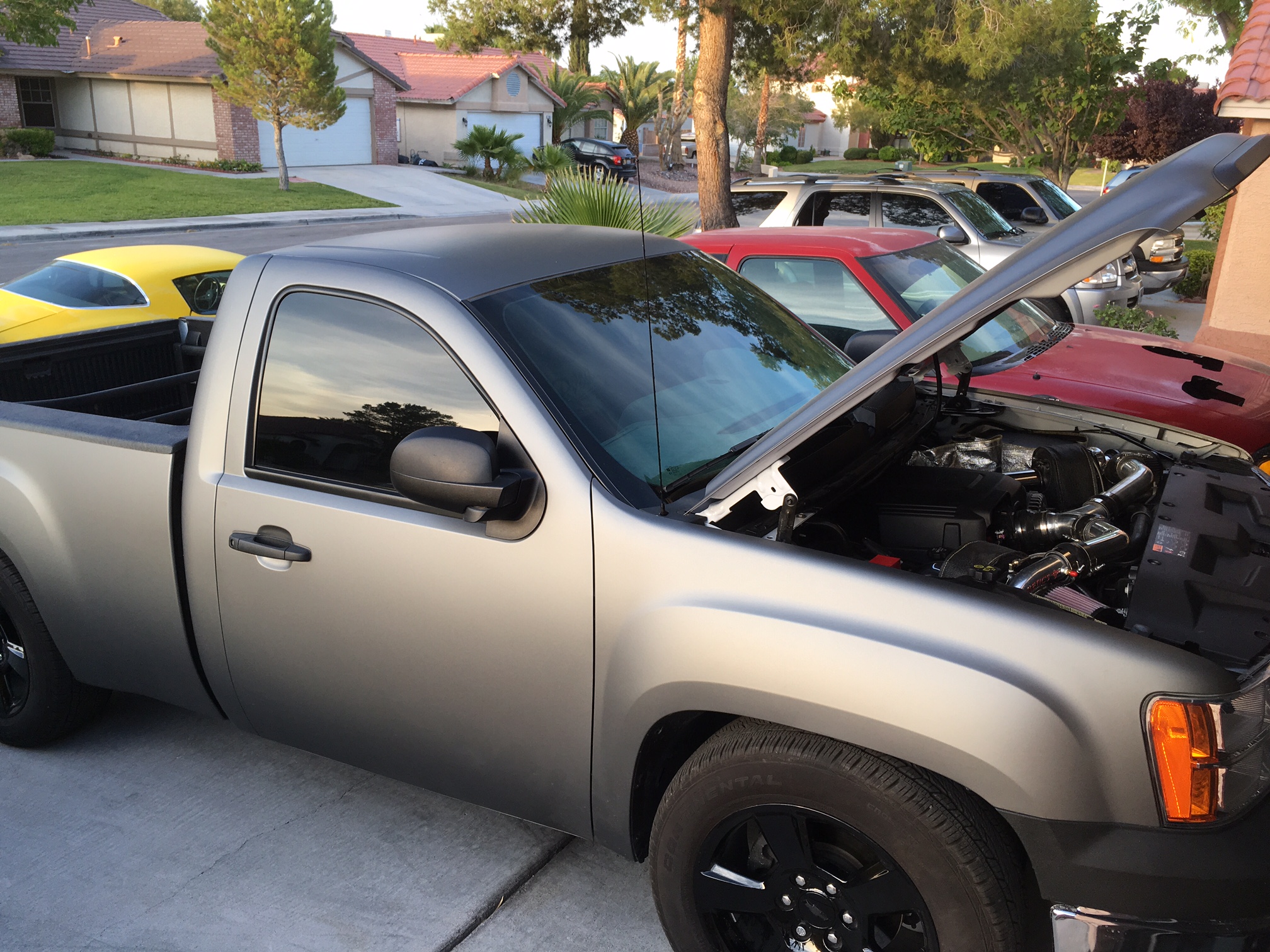

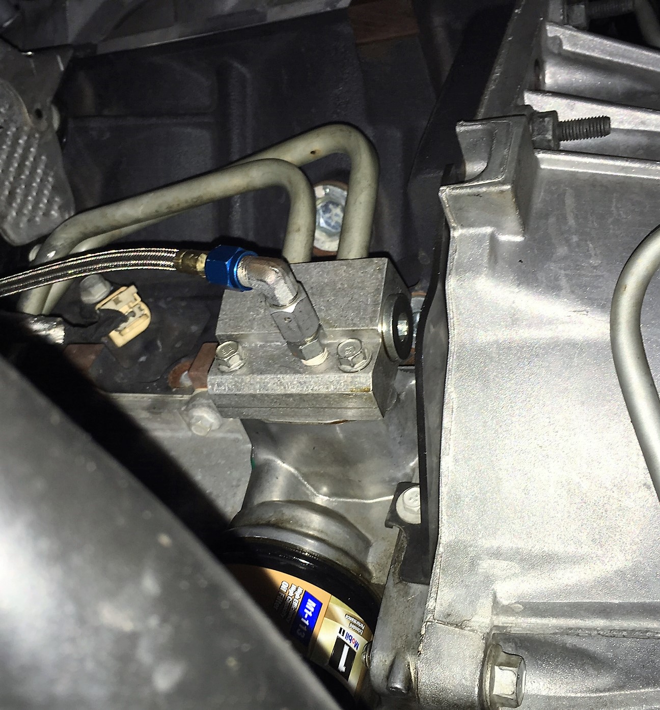

Been working on the oil feed and drain back lines. Drilled the oil pan and tapped into the oil cooler. Installed a lot of thermal material. Failed the MAF and started the engine today. Some exhaust work and ready for a drive. Still need to install the gates, so no WOT pulls yet.
