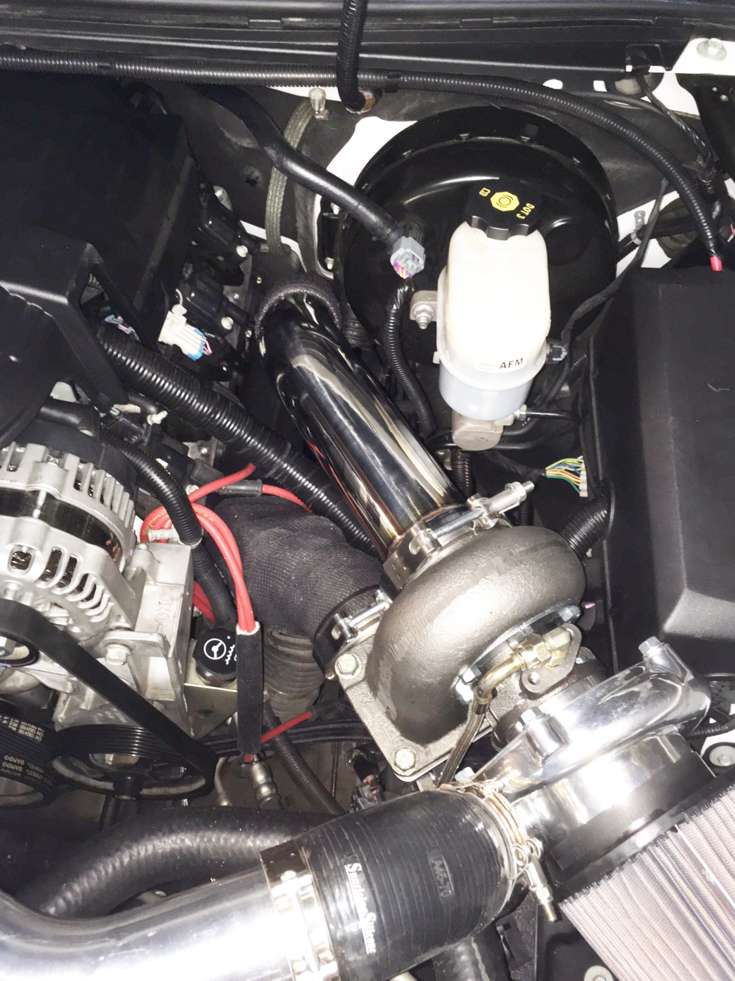

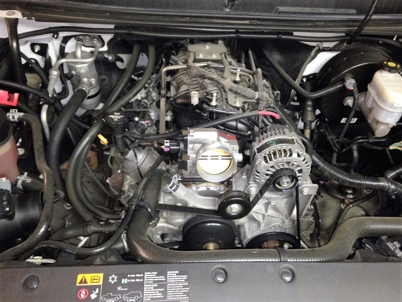

Started on a TT 5.3L 2012 GMC Single cab build. 2 weeks back I pulled the 799 heads and installed a set of ported 241 heads milled .025". Deleted the DOD and installed a 212 214 113 .600 lift Precision camshaft. Tuned her up on E85 and this weekend pulled it into the garage for a TT build. Here are some pics of the build progress. My home town is Vegas and I build and tune a lot of LS cars and trucks.

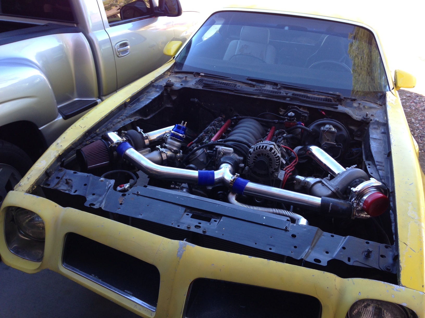

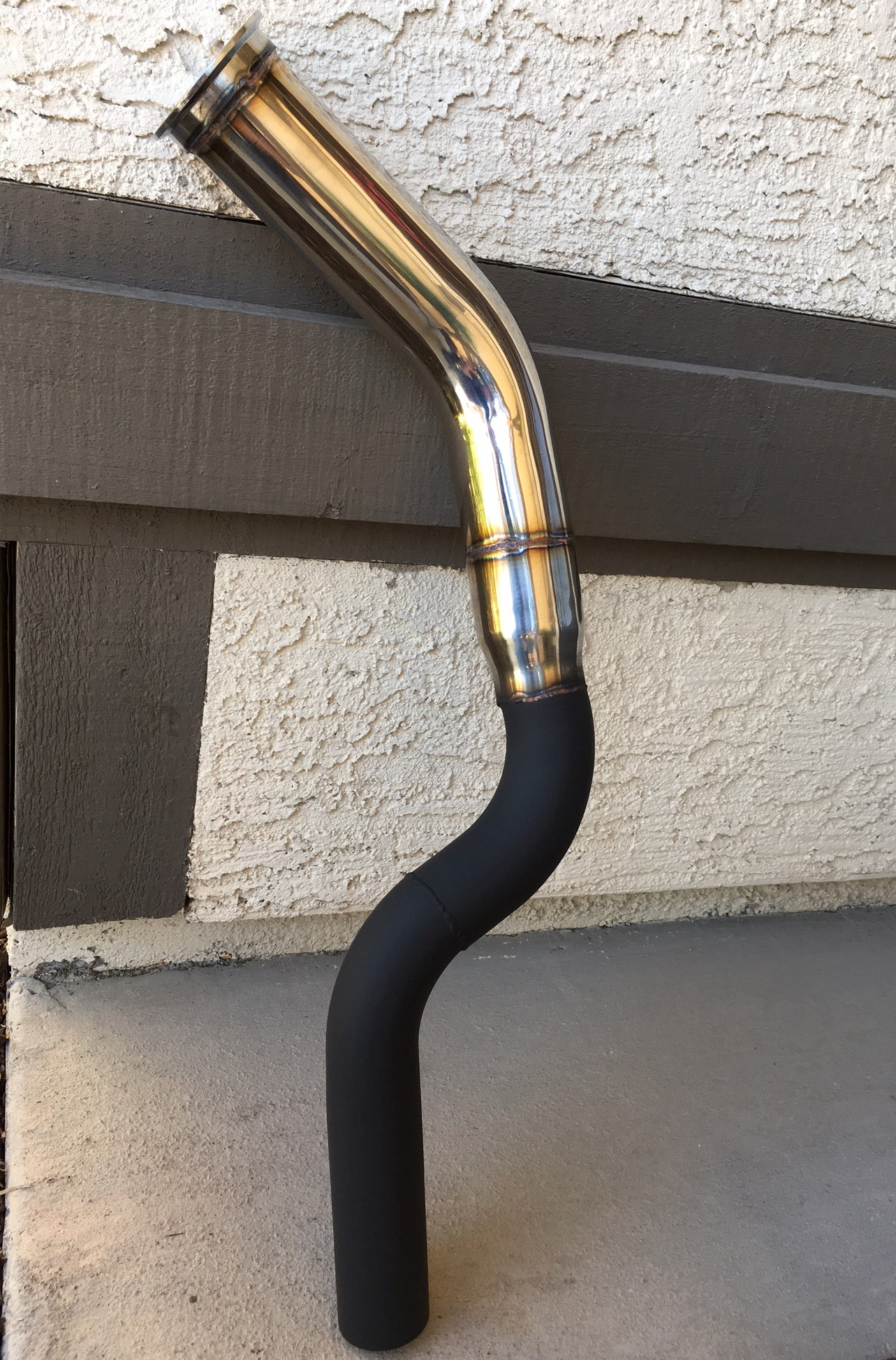

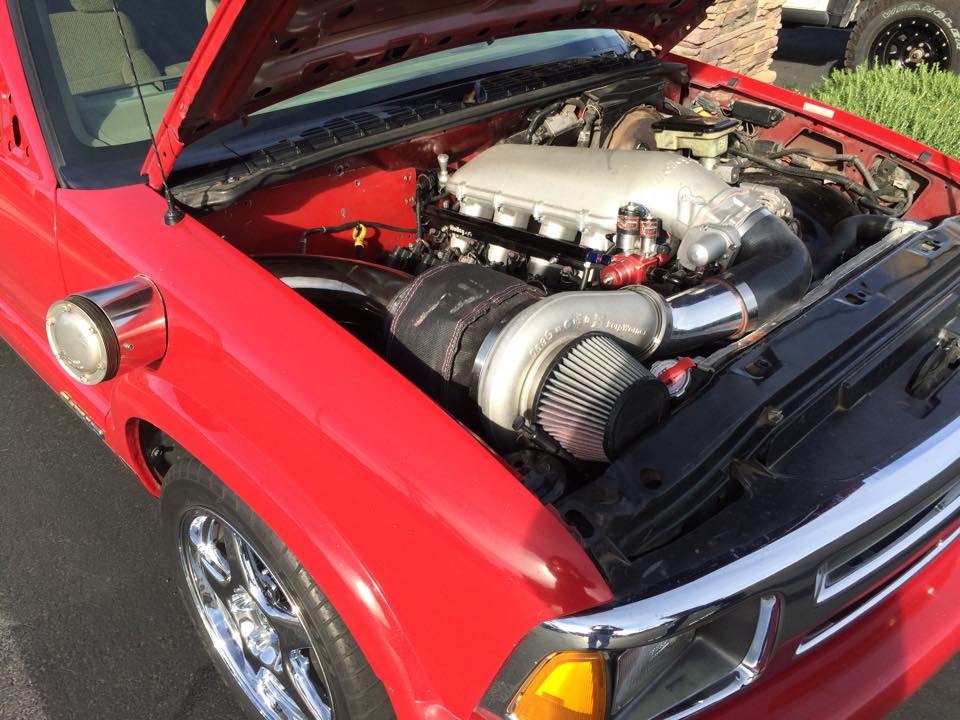

Thanks Jiggy, working on the down pipes now and just wrapped up the drivers side. Finished making the passenger side just need to thermal wrap it. I live close to Henderson at 215 / Windmill. Here are a few pics of an S10 build and a 76 TA TT 4.8L.
