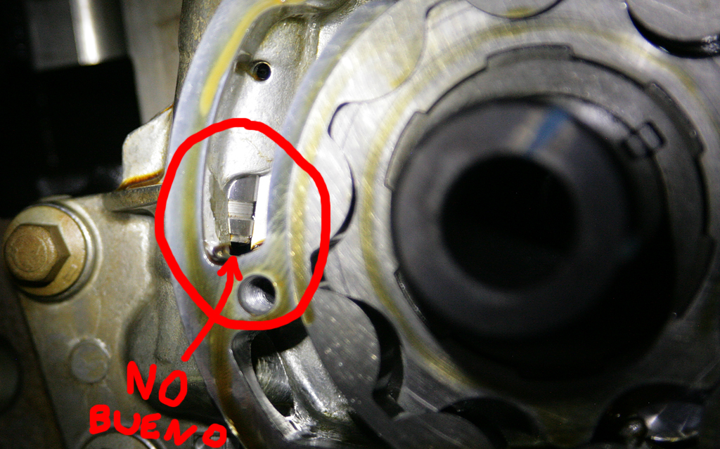

What happened with the 6.0:
As I said above, bypass valve in the oil pump was hung open. One of the cam lobes was also fucked, and the cylinder 1 rod has some noticeable play.
So the plan is:
New main/rod/cam bearings, lifters, cam, valve springs, and generally just clean everything up. Still no idea where I'm going with the cam, but I want to keep the 3000 rpm converter, in the extended cab it flashed to around 3300, and had good manners on the street, and I don't feel like spending the cash to upgrade at this point.
Goal is to get the 6.0 in the blue truck for under $2500. I'm not looking to build a race truck, just a fun street truck that will run 12s and embarrass some muscle car guys from time to time.
Here is my preliminary parts list, if anybody sees anything dumb that I'm missing please let me know, it's been about 6 years since I've worked on any LS engines.
Some pictures of the 6.0 when it came out last summer:
The fucked cam lobe:
