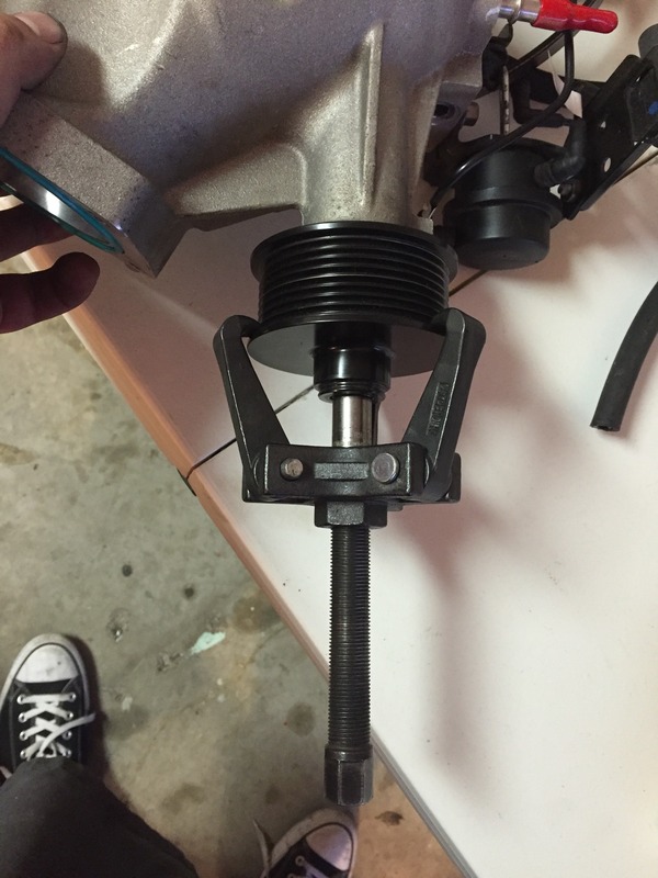

i was wondering how are you guys swapping the stock upper pulley? every place ive taken it to cant do it cause they dont have the correct tool

I think it can be done with a pulley puller and a press. Or even just a press. Remove your snout to use in the press.
I work on helicopter gearboxes and have a press in my overhaul shop. Mine has been swapped out when I'm "working".
I used a harmonic balancer puller and an 11mm socket, worked great!
