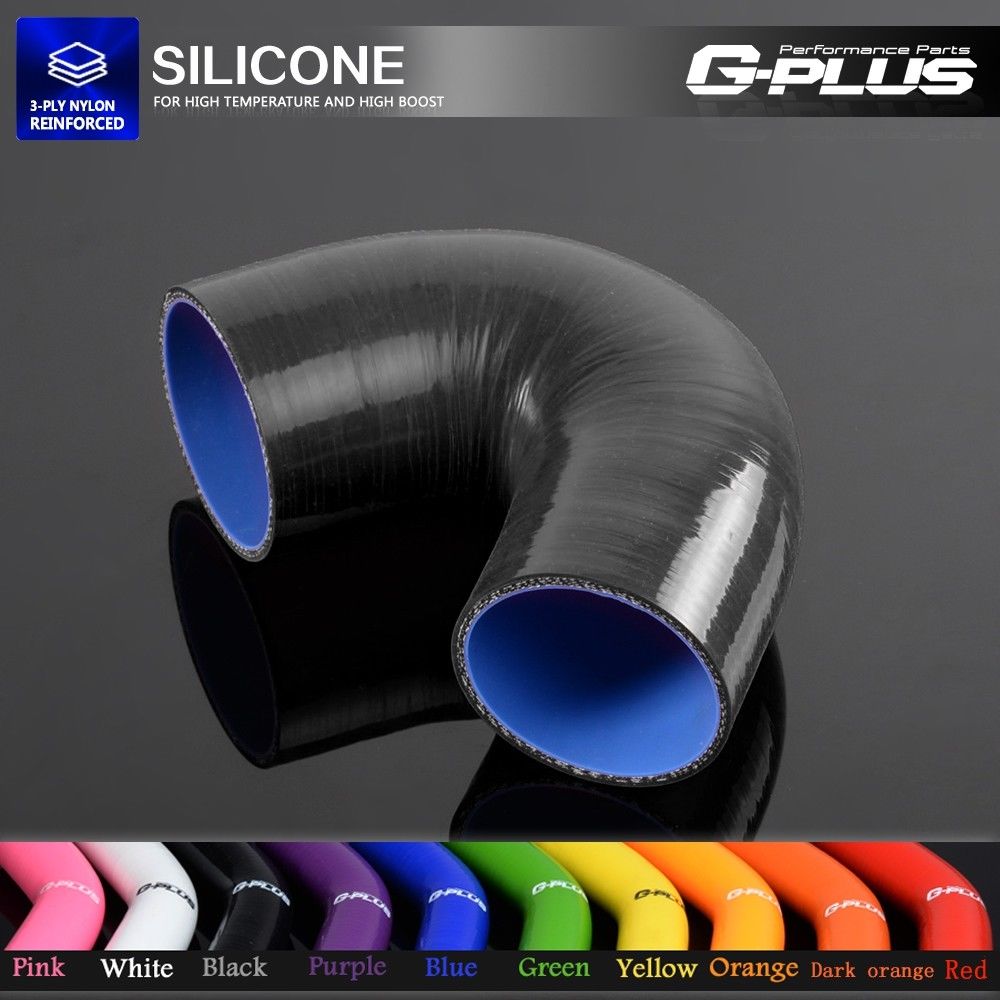

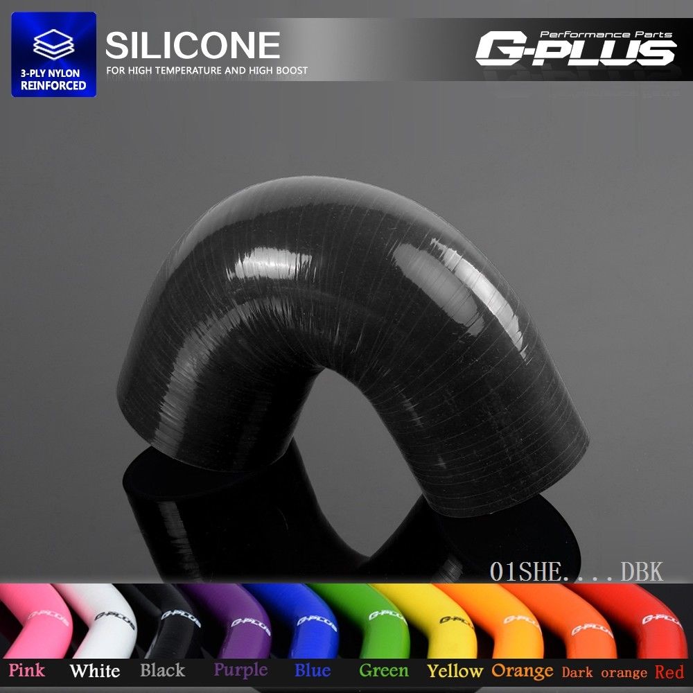

Capt-Kirk, this is what you need.
A 135* elbow will put the air tube/filter back
on the pass side

you start pushing this thing to high horsepower and I promise you that creates a massive restriction pre blower.

But it will help him get by until he relocates the battery and tube setup

I ended up cutting my K&N CAI. I cut the 30 degree turn out, flipped it. and put in a 45 lines up great. I need to open some cold air slots and move the baffle to the driver side.
