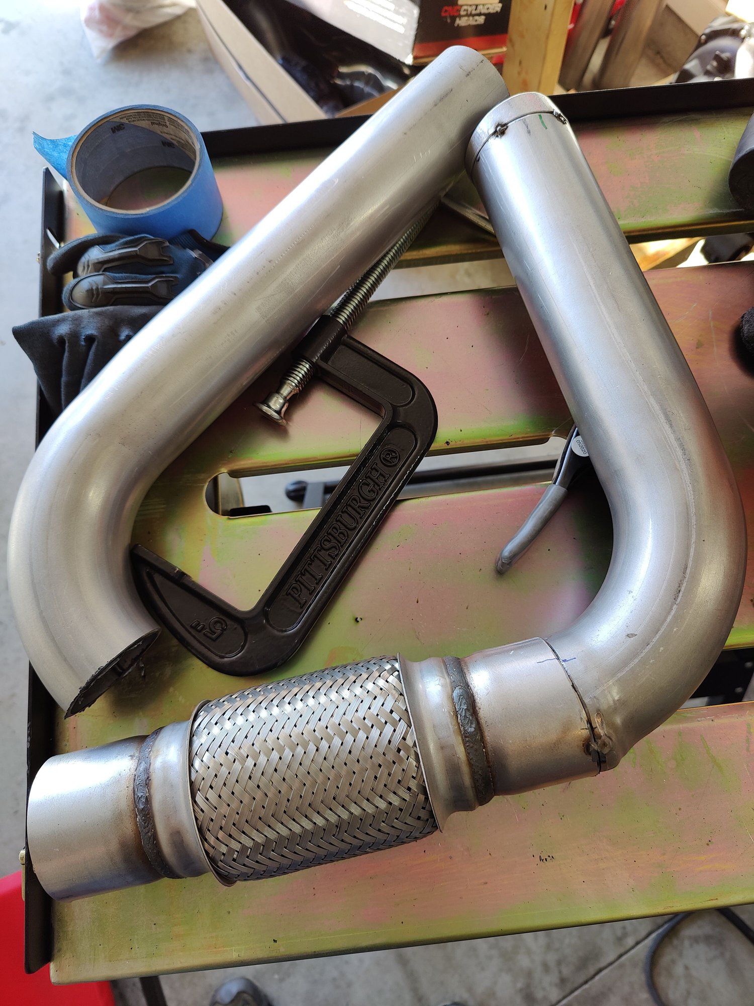

As y'all probably expected I may have to give up. I took off my stock y pipe and cut it right where it crosses above the transmission crossmember. I then welded a 3in vband flange to each side, but I had to "booger" weld it since the stock exhaust is so bent and mangled there is no circular and straight sections to cut where I need to and get a good and flush joint for a weld that will fit the vband flanges. I eventually got beat and shaped the stock exhaust ends and also expanded them with a expander enough to wear I could fit in the vband flanges and "booger" weld them up. So this allows me to separate the stock exhaust and take the y-pipe out without having to drop the transmission crossmember. This will allow me to take it off easier so I can work on building my turbo crossover and downpipe and put it back in when I need the truck. This wouldn't have really been worth it to do but I figured I would do it anyway since I would have to cut the stock exhaust somewhere anyway, and I would also have a vband to connect to already to hook to turbo downpipe to the stock exhaust. Since I cut it above the crossmember I will be keeping the stock secondary cat. It seems pretty big and hopefully won't be a serious restriction, but I doubt it is going to help with unburnt hydrocarbon smell, but maybe help wtih Nox emissions but I don't have to test where I am so I'm not concerned about that.
Anyway, I got a little more progress on my downpipe:
Only problem is the "booger" welded flanges on my stock exhaust pipe made a detrimental hit in my morale. The welds around the vband flange definitely leak as I can see water dripping out of them and feel puffs of air around them. I feel like with my welding skills I won't be able to get a good seal on anything I make, even though its kind of expected the stock exhaust to vband flange joint leaks just becuase its not a perfect 3 in pipe fitting into a 3 in vband.
So yeah I may give up and just buy a crossover and probably buy a downpipe too. I will still have to cut the downpipe and fab it up to my vband flange on my stock exhaust but at least that will be after the turbo and first cat and it won't be mission critical that it be completely leak free. I will also still need to cut it to put in my cat but hopefully if I can find a straight portion to put it in and the pipes are concentric and the same diameter I think I can do it.
