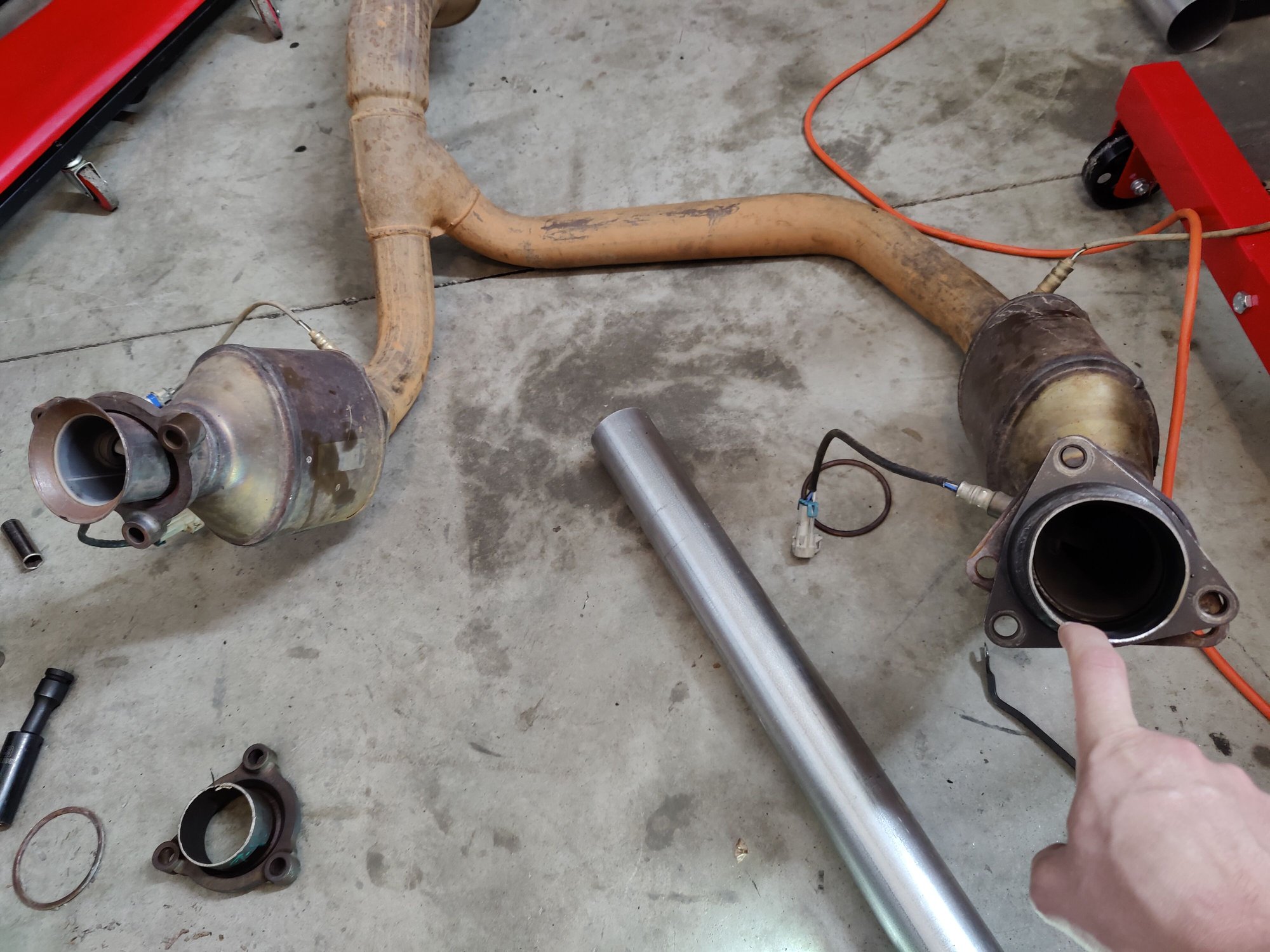

So I just found out the GEN III downpipe to exhaust manifolds actually aren't the same as the GEN IV, or at least 6.2. Well the passenger side is the same as the GEN III at least which is the side that has the flared pipe end, which is on the left in the picture:
You can see the flat flange with the crush ring brass gasket on the right, they have different flange patterns from GEN III to GEN IV.
So I am trying to solve my dilemma of trying to keep my stock exhaust completely intact. Yes, its not a big deal if I cut the stock exhaust I can just (in theory at least, but I am not a good welder) weld the stock exhaust back together if I need to. My main thing was trying to keep it intact, so I can take it off and try to fab up my crossover and downpipe, then put it back together when I need to drive the truck since even if I got my downpipe and crossover put together and working I still have to fit up the intercooler and everything else. I also can't close my garage door since my truck doesn't fit so I have it open and I'm scared someone is just going to walk in and take everything I have.
Yes I know this is the price I pay, and you have to pay to play, and you can't cheap out, but we all know how hard it is to leave something stock.
Anyway I am missing the pipe size I need to run from the turbo turbine outlet to my stock exhaust, I plan to mate it at the factory ball and socket flange right after the transmission crossmember. And yes like with every other GM truck you have support the transmission and take the whole transmission crossmember out to get the factory y-pipe out in one piece without cutting. I got sent the wrong V-band size also and I couldn't find any pipe between 2.5 and 3 inches because of the covid apocalypse supply chain blame game thing.
I also would have figured they would have made some sort of turbo bypass blanking plate thing, that would bolt up to a T4 flange and then have a V band connection, which would let unbolt your turbo and put this piece in its plate temporarily. I looked all over for one, as well as just a simple block off plate that would bolt to a T4 flange but I couldn't find anything. This would be the only way I could think of doing this successfully, since I don't think I can drive anywhere above idle with no load on the turbo without overspeeding it?
