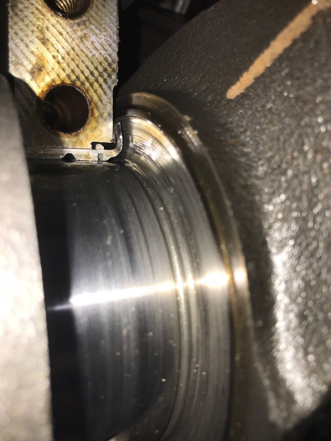

Here’s the damage..... mains, crank walked forward, rear was worst

Damn. I’d put a new cast crank in it with standard bearings.
What kind of oil pump?

stock oil pump- this motor was good- cold start up 60psi- warm idle was just over 40- wot was just under 80psi- never thought to need a better pump
im going to measure block out to see if the heat distorted it any, the 2nd main from rear the bearing fused itself together- but didn’t hurt the crank as bad as the one closest to the trans.
What causes these cranks to walk?

interesting theories here.
https://ls1tech.com/forums/generatio...k-walking.html
