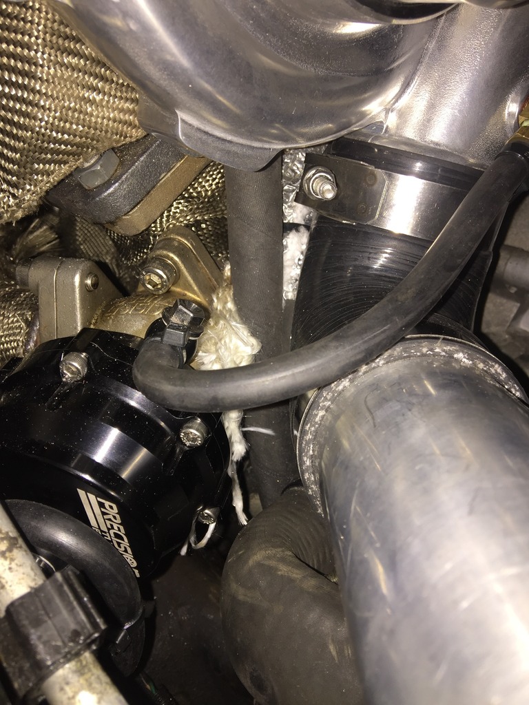

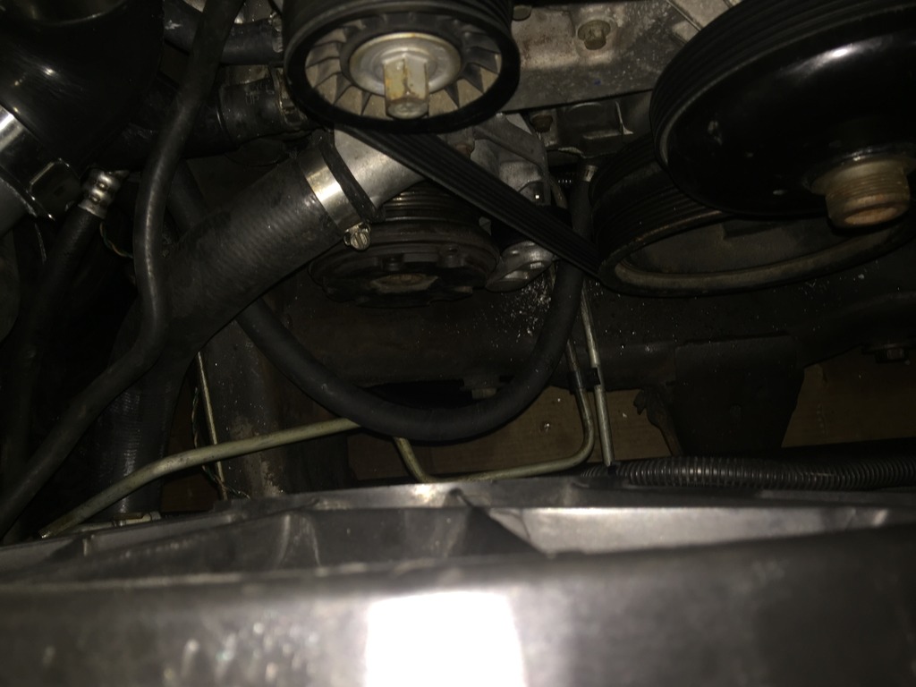

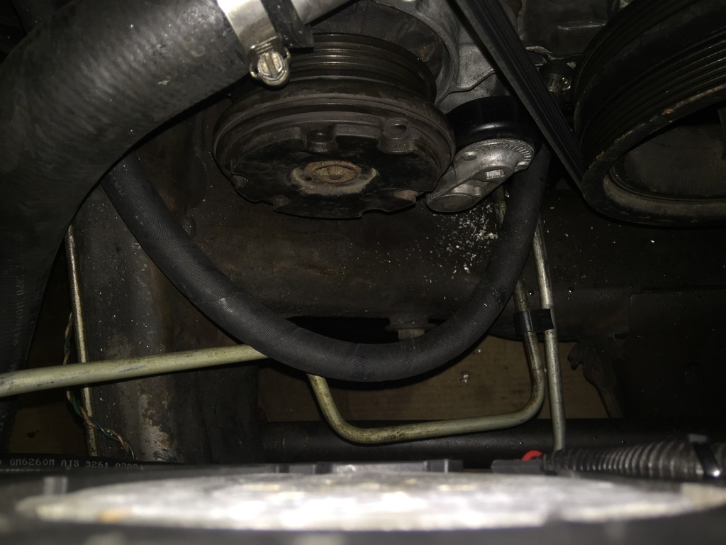

In the pics, the drain goes straight down from the turbo until it touches the frame rail, then makes a gentle bend towards the oil pan, the trans cooler lines are below the oil drain, everything flows in a gentle curve straight into the oil pan. Could the length of the hose effect the draining?
