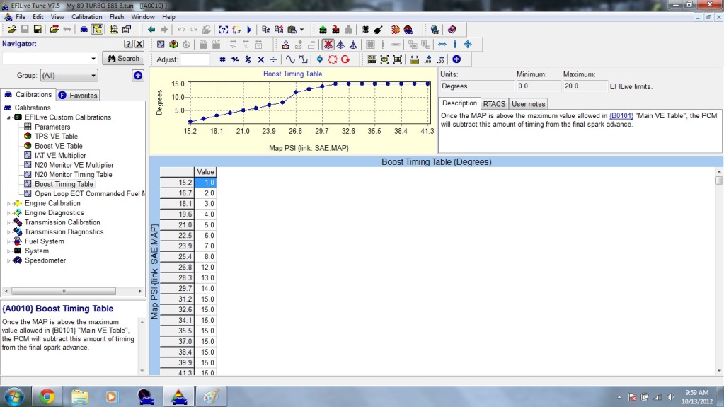

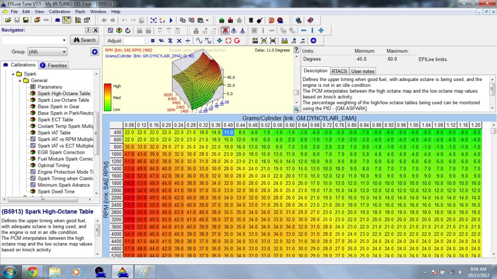

This is the same timing table I'm using on my 89 and on my brothers 4.8 (Jake99) mabe we could use more yet? We're both running on straight E85
The boost timing is the one I was using on my 89 at the track running 50/50 91/E85

Originally Posted by sprayedenali
I forgot I don't have Internet at home so this is the best I can do...
Damn dude, .64/.68 is usually WOT on NA, isn't that a lot of timing 45*@2400???
Old Oct 13, 2012 | 10:13 AM
  #193
Atomic's Avatar
I have a gauge for that
Posts: 16,282
Likes: 438
WOT is usually around .84
Old Oct 13, 2012 | 01:31 PM
  #194
sprayedenali's Avatar
Joined: Dec 2009
Posts: 1,573
From: Birmingham, AL
It's a calculated number that will be different for every combo...
But hey, you gota do something to make a 5000lb ext cab with a stock motor go fast!

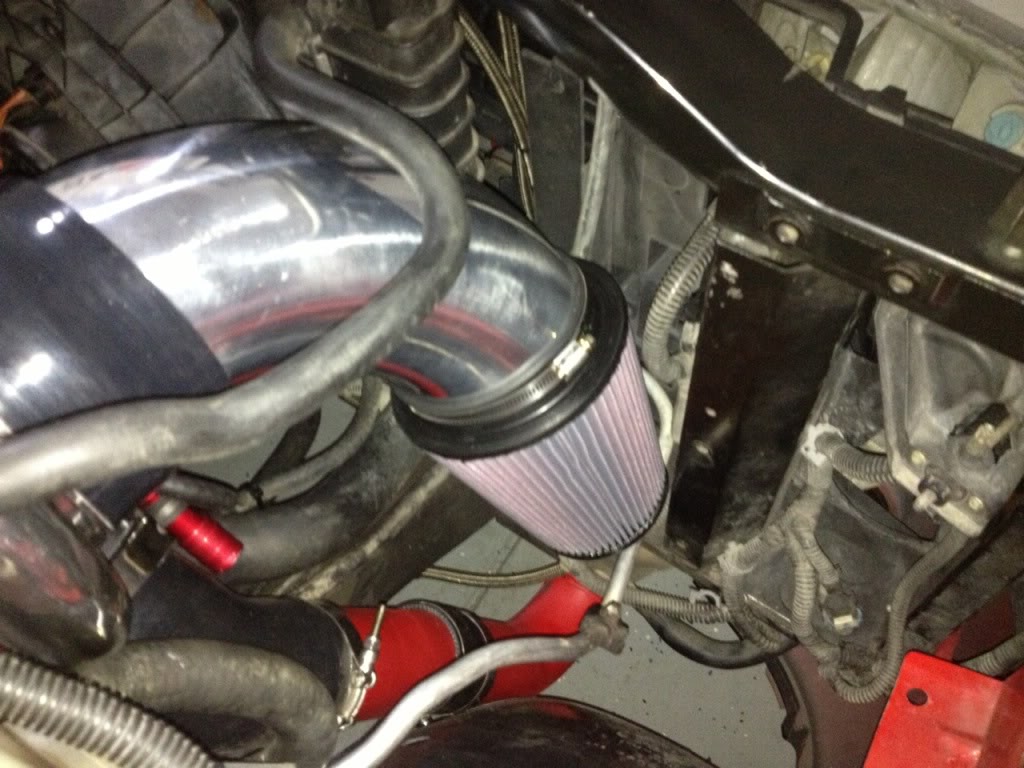

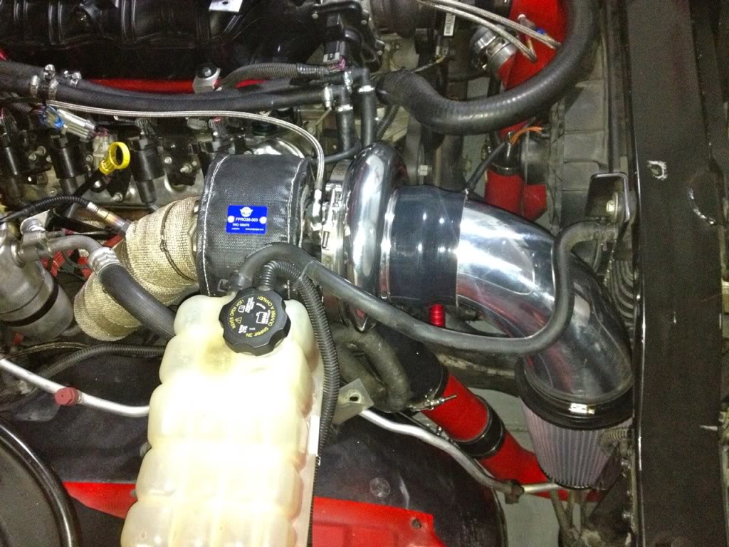

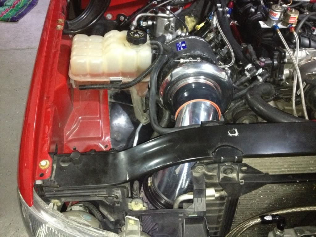

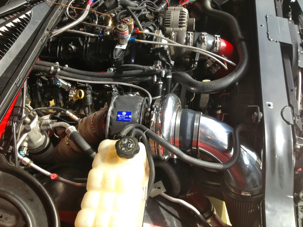

Little update, got the 5" intake in and turbine blanket. Hope to have 60mm JGS installed tomorrow, then maybe track Wednesday for some testing if I get a tune on her in time.

'bout time for a custom coolant res, wouldnt you say?

That intake elbow coming off that turbo looks like a elephant trunk LOL
